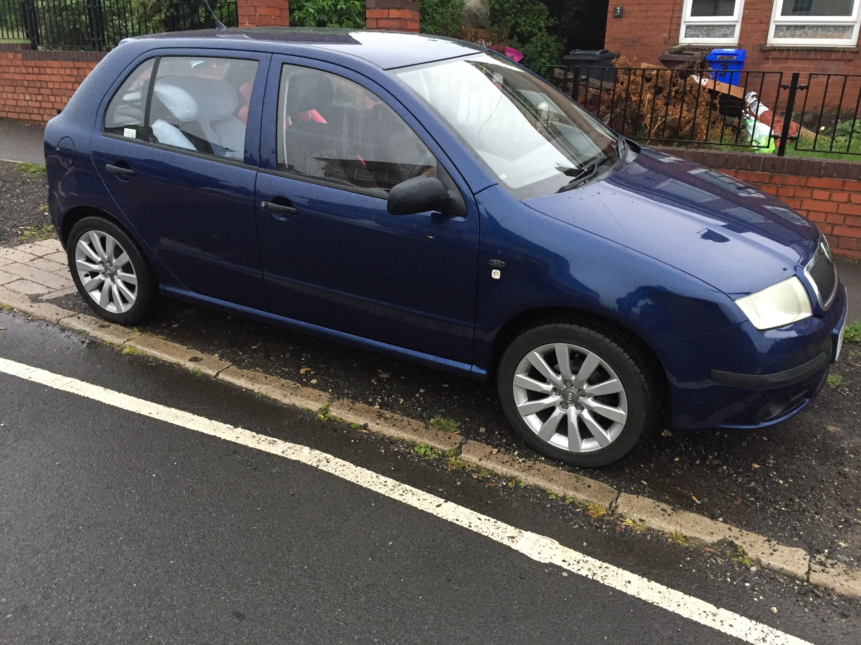

over the the weekend I fitted a set of Audi A1 alloys. They fit perfectly and sit in the arches nicely.
My only concern is that the road noise has gone from a dull roar to being really loud. The tyres are continentals (no idea how old) and asymmetrical and the wheels are all on the right sides. My thought is that it’s the profile of tyres as they are 45. If I get new tyres with 55 profile this might reduce the noise?

The tyres that are on are 215/45r16
Those tyres are too big already, a 55 profile will make the situation even worse, are you sure the tyres aren't fouling the arch liner slightly making the extra noise, you'll see a shiny spot on the plastic if that's the case.
I did check as I took them back off after going for a run as it seemed quite loud. There is no evidence on contact anywhere. I am possibly being paranoid as I haven’t had any wheels on this lower profile for about 10 years.
are you suggesting when I get new tyres to get them at 205 instead of 215? They should fit the rim fine so would that be better?
Yes 205.
Been out and double checked, there’s no rubbing going on but I’ll get some at 205/45r16 when I go for new tyres. Thanks 😀
