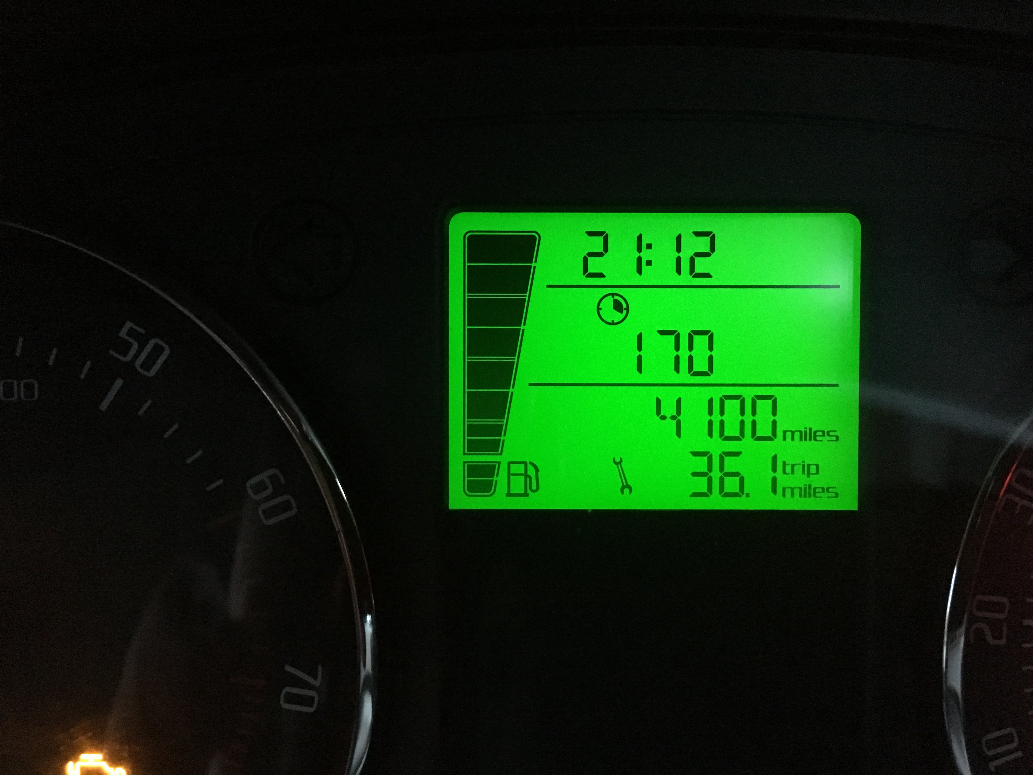

Hi, I've just bought a mk2 Skoda Fabia yesterday and I was pressing buttons to set the clock and other things and came across the service interval screen, so my query is: What is the clock symbol about and the number 170?  The garage I bought it from gave it a service and MOT, so not sure why the interval is so low.
Time (in days)
i doubt they reset it.
Edited by Tech1e
Okay, so how many days should it say after a service? Also how many miles, as I suspect they didn't reset the service notification.
If it’s on fixed servicing 10,000 miles / 365 days
9,400 miles / 372 days.
