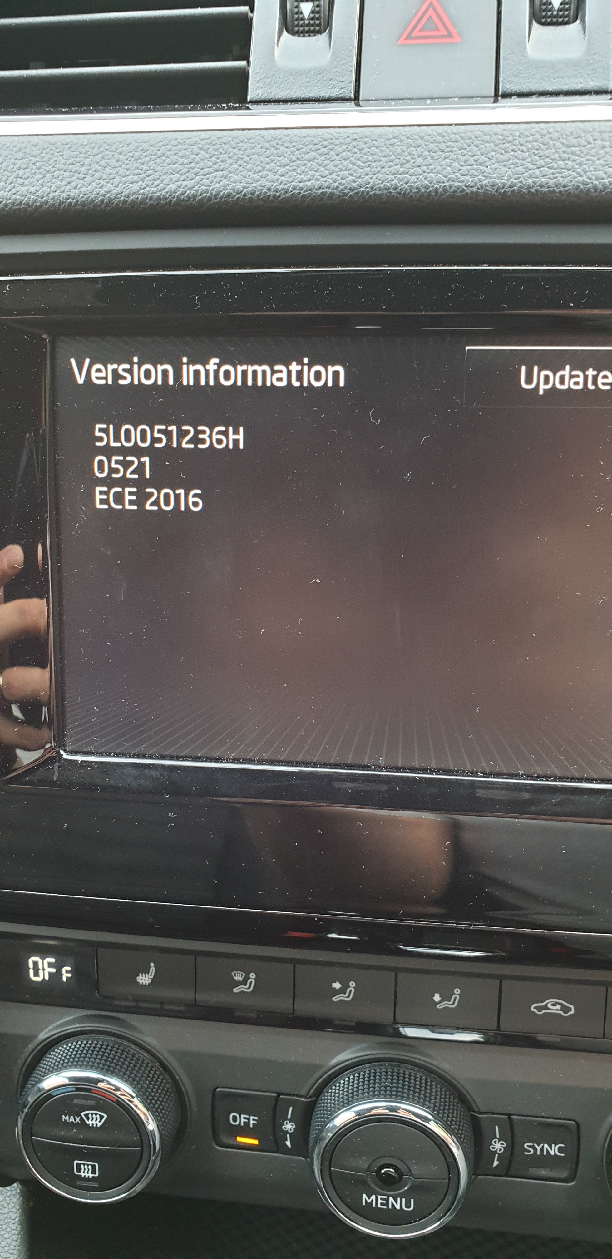

Hi I have a my 16 and have downloaded the latest 2019/20 from skoda portal using my VIN and unzip the downloaded file to a USB drive (32gb) and then go to the car and click nav then settings then system info then update it just does find the files or anything could anyone help ?
This sounds like the overall.nds file problem
Before you downloaded the new maps, did you save a copy of the sd card onto a folder on a computer as a back up
Once you have copied over the newly downloaded maps, copy this original.nds (and overwrite) file back onto the SD card.  It seems to have some security codes that are stored and are needed to allow activation.
I think your maps are on the SD card, it won't update via USB.
You need to connect the SD card to the computer and unzip the files to that.
There are a few guides kicking around with some more step by step details.
Thanks buddy al give it a go and yeh first thing I done was make a backup as i didn't want to go messing things up
thank you

The video I seen done it through a USB stick so just thought it was USB stick and the car would do the rest but al try copying that file over and see if it works that way if not al just take the sd out and dump everything on to it and try again:-)

Ahhhhhh right got ya av been putting them on the USB stick and trying that way al put them on sd card and try it also does it have to be the skoda 1 or can u us a normal sd card 🙂

Yeh av got the backup already. Does it take the hour plus to update or is it just running off the sd card all of the time

I copied the files straight to the sd card and plugged it back in turned on car and hey presto it worked Haha cant believe how easy it was once I had done it feel like a complete idiot Haha thank you everyone @Surreyjohn
