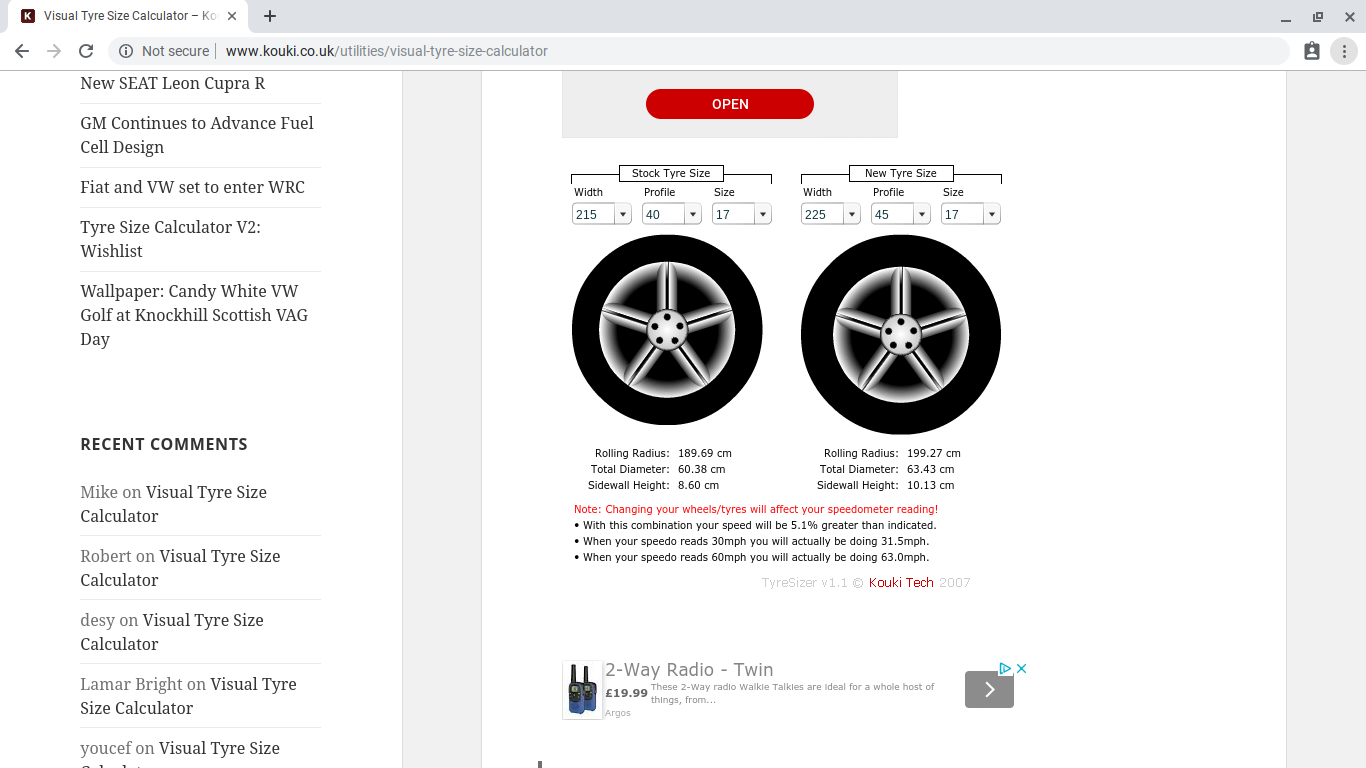

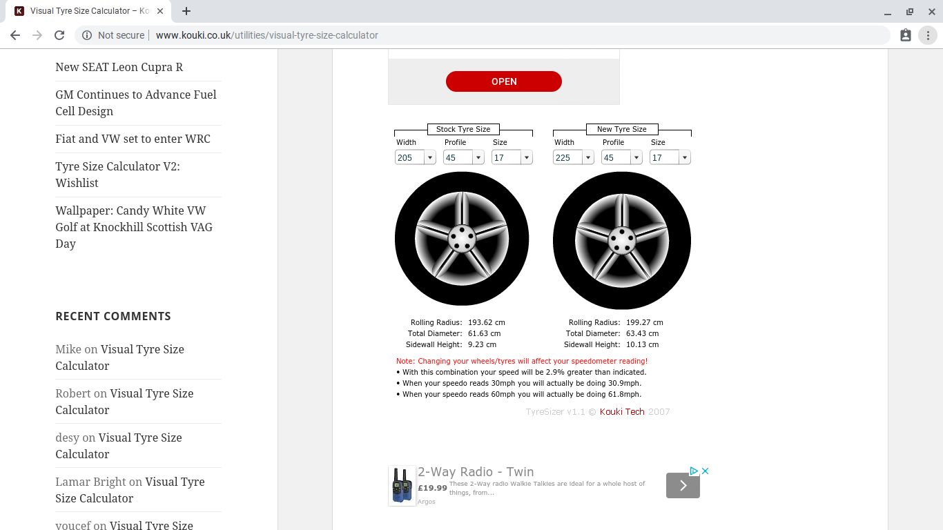

Too wide, too tall
Lowering it will only make things worse.

205/40 R 17 is right,
and 205/45 R 17 or 215/40 R 17 a bit bigger but can be used, but if lowering or already lowered maybe best not.
