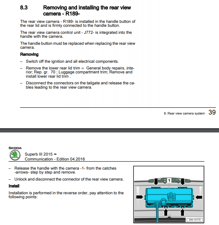

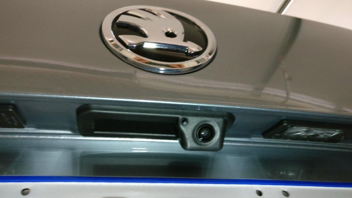

It is an option (as I have a hatch with a reversing camera. Nov 2018 build). Not sure if it's normally retrofitted tho. Should be easy. It lives above the rear number-plate in the hatch handle and would require simple replacement of this part and wiring into the loom. Which is probably there already.

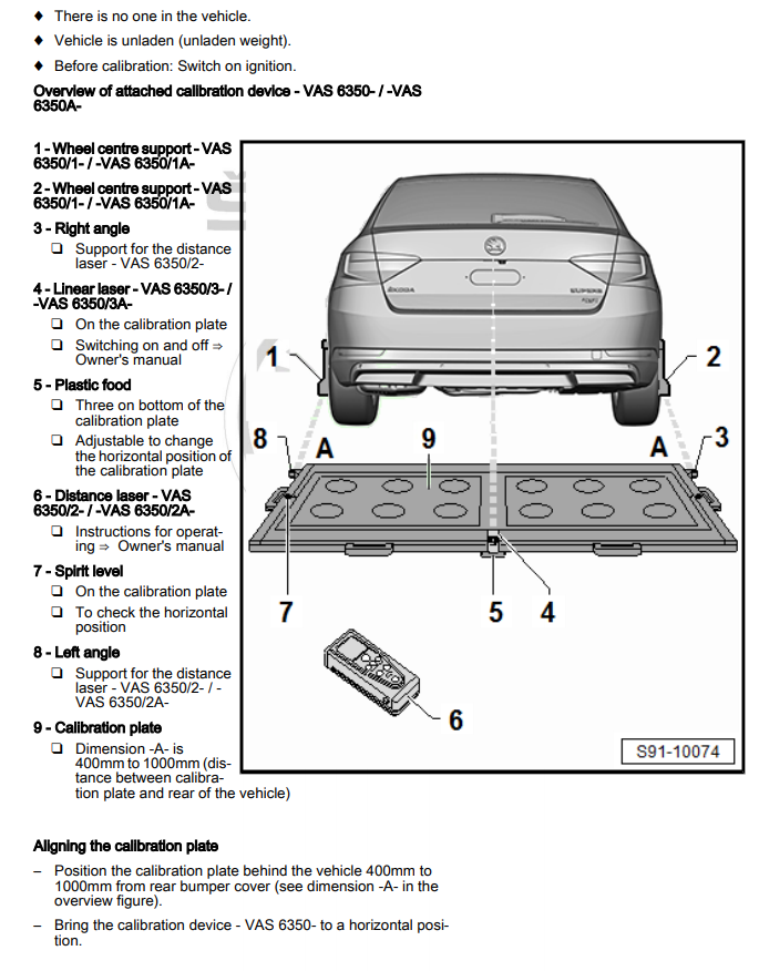

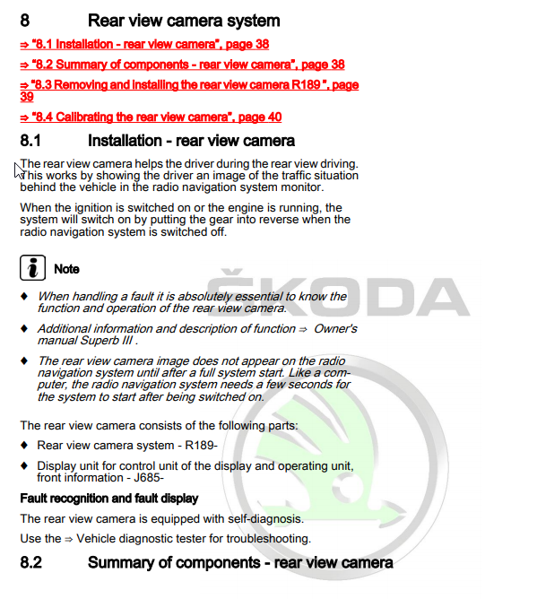

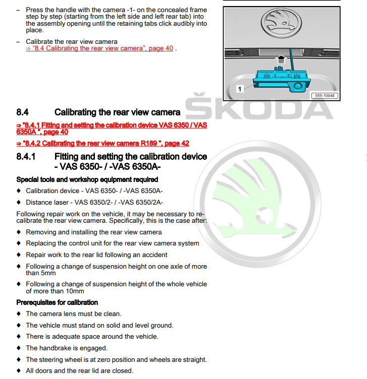

I am not sure if it helps but here's some pages from the workshop manual ... ( have no idea if cameras are dealer retrofitable, you can brute force anything with enough time and money of course )

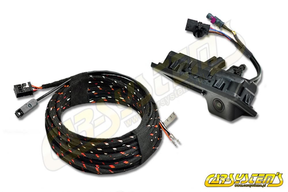

But technically it is possible and this is common retrofit over all VAG cars. To do it, You have to obtain camera and wiring loom - the best one is plug and play with the adapters to avoid cutting and soldering oem wires. To be found on aliexpress (cost c.a. 20$)
The problem is sometimes calibration of the lines - it is difficult to find the workshop beside Skoda to do it. Brand new cameras comes without calibration or even without firmware.
That's why I always buying used one, which is calibrated, but the risk is always with the quality - as usual with second hand pieces.
Regarding rear wash wiper, if You don't have it, the spray nozzle will not work. But for this, You can replace existing washer pump to the one handling rear washer, replace stalks, route an washer pipeline to the camera and code it up.
This is set You need to get it worked:
