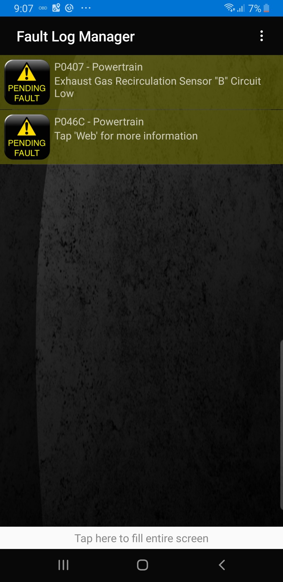

I'm new here and have an issue with my car going onto limp mode intermittently.
Although he issue is intermittent the car usually goes into limp mode at some point during each trip.
It all started straight after I got m car back from a major service and has been getting slightly worse each day.
The symptoms of this are that you feel a very slight hesitation and then the coil light starts flashing.
I've done a scan with my cheap Bluetooth OBD2 reader and it's showing codes P0407 and P046C -
 P0407 = EGR sensor B, Circuit low
P046C = Powertrain.
I've read that the EGR getting gummed up and sticking is quite common on the 1.6 TDI.
Also that its an expensive job as the EGR is located in the most inaccessible place ever!
My question is, where should I start with this?
I'm happy to attempt to clean the EGR myself or even replace it myself but I'm not sure how to get to the EGR without removing the subframe and driveshafts.
Does anyone know if there is a way to access the EGR and spray it?
I've attached a screenshot of the errors found.
Thanks in advance.

Hey @pikpilot, thanks for your reply.
I feared that it was located behind the engine, I Iwould be able to do it myself if it was on top.
I've only done 62k, I only drive about 10 miles each day around town during the week and take it for longer runs at the weekends (motorway driving).
I didn't respond to Skoda's letters about the software fix as it caused issues on my friends car.
In desperation I had a carbon clean done with nitrogen and it has definitely made an improvement, however it's hesitating at least once per trip (sometimes sending it in to limp mode and sometimes not)
I'm waiting for my mechanic to get back to me with the book time but like you said it's going be be around the 4.5 hours mark.
Although it would be uncomfortable with small ramps I'm tempted to replace the EGR myself as I've seen some videos where they replaced it without removing the driveshaft.
