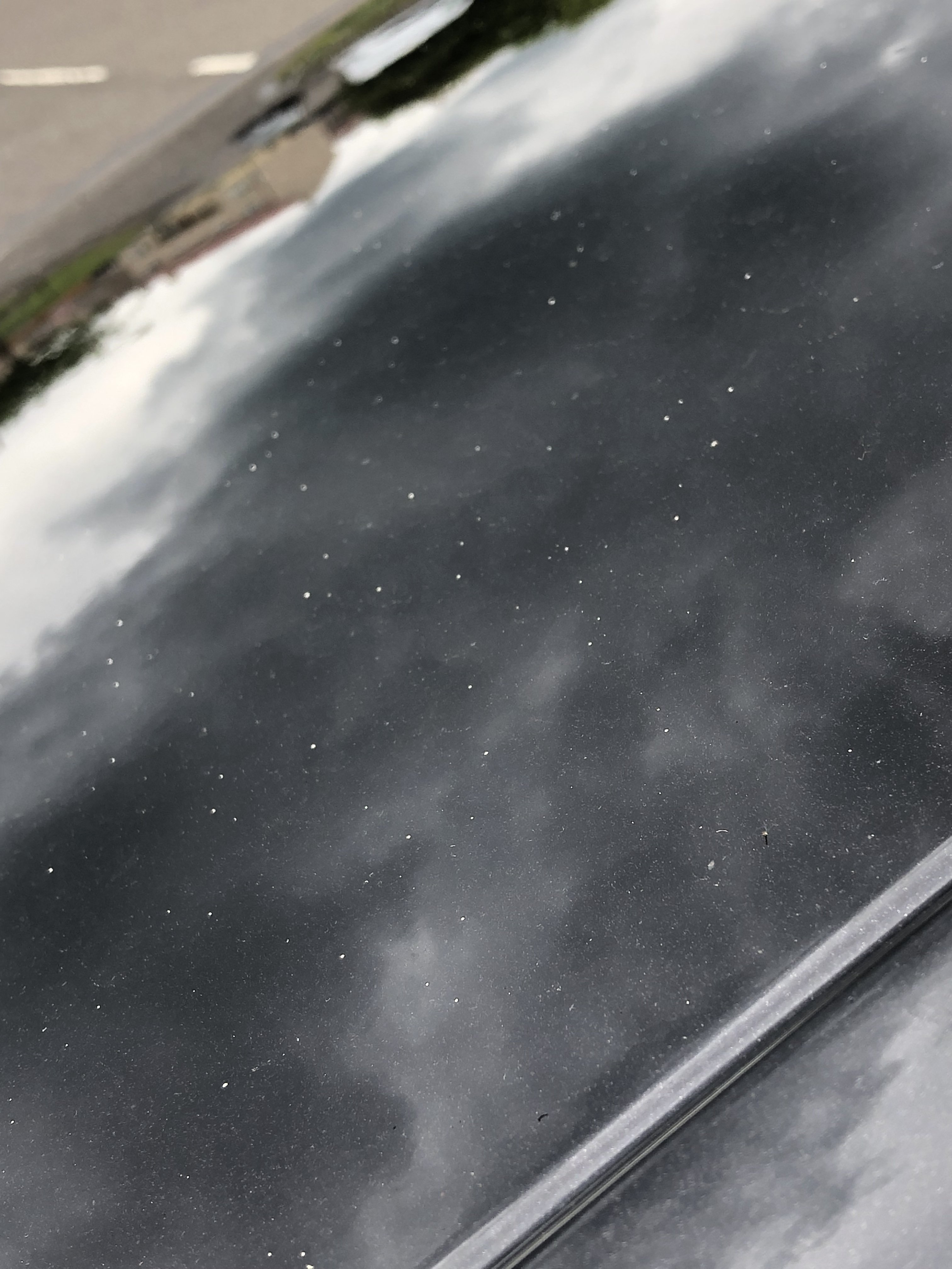

This is a before pic...
Cheers.
Edited by Mat1210

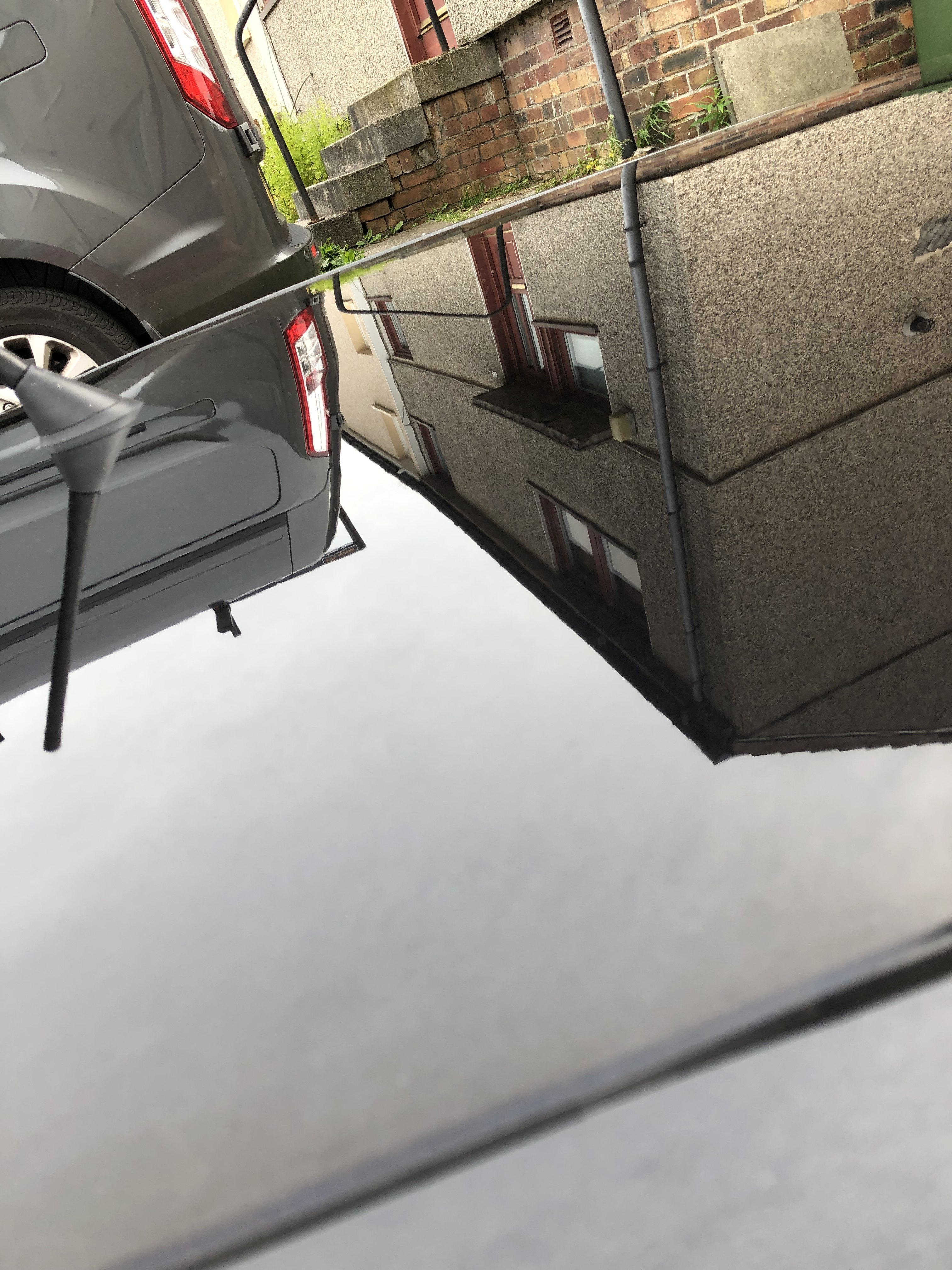

And after... used some Black Hole polish then Angel wax.451844F7-F878-4B50-9ABC-9B6DC97C81E0.thumb.jpeg.1583f79ae651545ca17fee9e60ad5e40.jpeg
