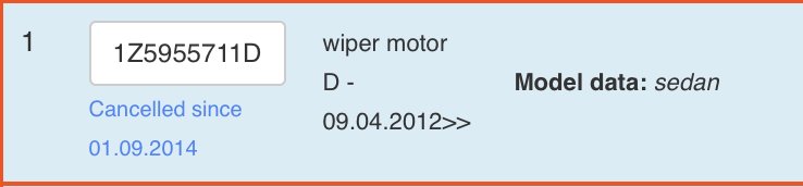

Interesting reading Silver, thanks for the link. Notice Mike had put a part number in the 1st thread. I quote ' Part number now is S1Z5 995 711D for the hatch '
I thought IZ5 was the estate version of the Octavia so is the wiper motor the same on Estate & Hatchback?
Also is there a newer part number for the hatchback? Don't want to be buying old stock due to all the known problems and revisions I've read about in the threads.
Thanks
Cancelled as of 2014 so probably superseded from this
Looks like a backwards supersession.
