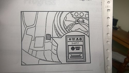

In 2013/14 they started a Service Campaign and Skoda did this from May 2014  in the UK.   '34F7'.

imageproxy.jpg.4614ad9ec6bcdd4ff87997e3e6bcacae.jpg.6adc5dc418523109905a3f3d414d63ac (1).jpg
post-86161-0-31585300-1464131325.jpg.3164741b357775b745e65b1dd451e36f (1).jpg
post-86161-0-56716800-1464131335.jpg.87fea70cc168731525a841ec0b8218f0 (1).jpg
