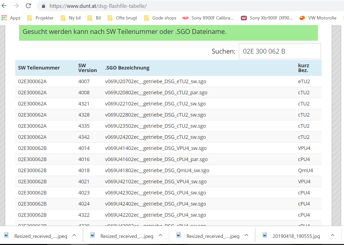

Hello all.
My Superb 2.0 Tdi 140 hp DSG 2014, runs pretty good.
But when i drive with very light speeder, the gearshifts are pretty slow. I can feel "gas off - gearchange - gas on". Pretty smooth but very slow.
When i drive aggressive, i cant feel it, then it seems it shifts very quick.
Also i find the engine braking when comming to a full stop, pretty invasive. Esp. when it downshifts to 2´nd , it brakes the car pretty much.
Does anyone here know about software versions for dsg ? When i enter my gearboxnumber on diiferent sites, i get a lot of newer version for that specific box, but according to skoda, thos flas files are for Octavia, Audi, VW and so on - meaning that there is no tpi for my car containing a gearbox flash update. Does that mean i cannot get an update ?
If the update is made for the exact same gearbox number , but for a Passat, then i cannot use it, or how ?
Please see my autoscan below.

If i check https://www.dunt.at/dsg-flashfile-tabelle/  and enter 02E 300 062 B, i get a lot of updates for the gearbox, but i really cant find out what the different types means (F40S, F43SR .. aso) ? See below.
I managed to download the flash files available for my vin at erwin skoda, and that was only the F40S files, which also match as it is a F40S file version 4016 i have on it by know.
According to that there should be a version 4018 and 4021 in the F40S range, and as im currently at 4016 , then it should be updated according to my logic.
I have asked on other boards as well, and there was a user saying that i could easily put the 4343 flash file on the dsg.
I can also see that the 4343 flash is the latest, but what if that file is made for same number gearbox, but in an audi, what would then happen if i apply it to my gearbox ?
Offcourse i dont do the flash myself, it will be a tuner - i just like to know whats happening. This is the advanced info from my gearbox:

And this is all the flash updates for my 02E 300 062 B

Sorry to bring an old thread up, but im really hunting a knewer flashfile for my dsg. Does anyone know if it exist, or how i find out ?
Address 02: Auto Trans        Labels: 02E-927-770.clb
   Part No SW: 02E 300 062 B    HW: 02E 927 770 AL
   Component: GSG DSG AG6     521 4016
   Revision: 05652104    Serial number: 00001405070508
   Coding: 0000020
   Shop #: WSC 33361 790 00072
   VCID: 14270A51377B88EA61-8040
No fault code found.
