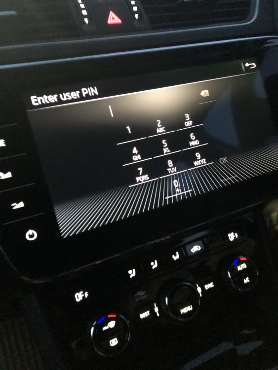

Anyone know what this is? I tried my phone PIN, it says please wait and goes unresponsive.
Ive got beta version of IOS13 on my iPhone. So the phone is to blame but wondering if any other beta users out there.
What were you trying to do?  The image gives no clues
Is this relating to a Skoda connect function?  If so, could it be the S-Pin which you set on the Skoda Connect app?
Not using Skoda connect anymore.
Sorry yes didn’t explain how it came about. Simply phone auto connects to Bluetooth, the first few seconds of a song play and then that comes up. No music, nothing.
I inputted my phones pin, it just says please wait and I have to turn infotainment off and then back on.
It’s only happened since I have the beta version of IOS13, so must be a major bug somewhere. In fact that whole beta has bugs, seems a very premature release.
I was just seeing if anyone had suggestions on what the PIN could be as I don’t remember setting one up on the infotainment.

Is there any mention of bug fixes or new features pertaining to a PIN number/security, in the IOS release notes?
Not gone that far yet tbh. If I arrow back it disappears and then says unable to connect. I have got audio and telephone coming through now so all good.

I have exactly the same problem with my Octavia RS since I installed the iOS yesterday evening.
I need to klick the back arrow 1-3 times, then it works. Quite annoying !
I’m not sure what to make of it. If I type my iPhone pin in, it just keeps saying connecting and nothing happens. In the end I had to turn my phone into airplane mode and turn the stereo off and on again. It seems to be a Bluetooth thing as it was still trying to connect even when I unplugged the usb. I take it wireless CarPlay is not yet available on skodas?

I downloaded the iOS 13 (not beta) yesterday and the same thing is happening with my Octavia vRS 2017.
It's definitely annoying.
It won't come out of "Please wait" and allow me to use the infotainment unit if I decide to enter the PIN.
Don't enter the pin and I can use the infotainment system, but the phone still connects. I don't understand it.
It’s almost like it’s trying to connect to Apple CarPlay wirelessly, but the car doesn’t support it.

Well i'm glad I found this thread as I've spent ages this afternoon trying to sort this, and not for a minute did I think it was related to updating my Iphone to ios13
I'd been thinking it was a Skoda connect pin I'd put in when I got the car.( Kodiaq)
Did a bit of digging and it might be related to this
"Apple’s new iOS 13 update adds a new privacy measure that requires apps to get your consent in order to use your device’s Bluetooth."
Although how that might apply to our cars I'm unsure
Hopefully a fix soon as it's a right pain

I too got this issue after upgrading to IOS13.
The problem is to do with Bluetooth regardless of whether you connect via USB or Bluetooth and have previously paired the phone via Bluetooth (with older versions of IOS). The issue doesn't occur if you have Bluetooth switched off on the phone and connect Carplay solely via USB.
This is the solution - Unpair the phone from the car by going into Settings>Bluetooth (on the phone). Find the Skoda BT connection and touch the i icon. Then tap Forget This Device
Turn off Bluetooth momentarily and turn it back on again.
Next go through the pairing process again. A code will be displayed on the infotainment screen and will be replicated on the iPhone. Just make sure they are the same and pair the phone.
If you have given the connection relevant permissions all your contacts, favourites and phone recents will be imported again.
Next time you turn on the car if you connect the iPhone to the USB it will no longer ask you for the PIN number.
Apple must have introduced some sort of enhanced security routine for Bluetooth within IOS13 that is probably documented somewhere but I haven't seen it.
