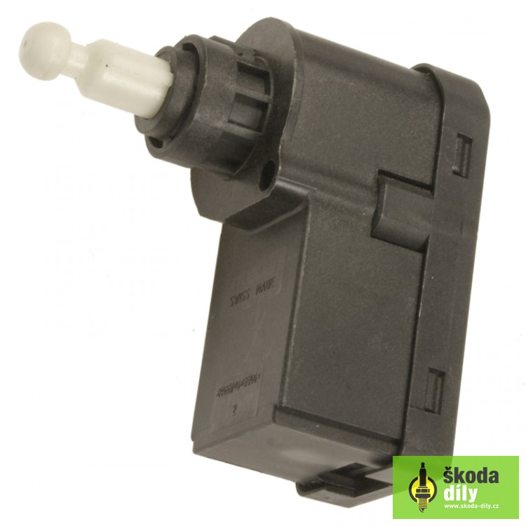

Anyway, I managed to track down the relevant beast on skoda-parts.com - "Headlamp Servomotor Europen Union" (sic) - part number 1Z0 941 295 - price €22,75 incl. VAT.
This part fits a shed load of preFL O2s, but  also a couple of O3s too - see linky.
As regards the mechanism of operation @J.R. mentioned the ball and socket arrangement that seems to be pretty common for this type of motor, and the illustration on the skoda-parts site seems to support that:
I have previously stripped and fettled such motors on O1s  - a fiddly job but fine if you're patient and gentle - and there are a number of threads in the O1 forum about this and at least two youtube videos.  I can't find anything directly related to preFLO2 but I can't see Skoda re-inventing the wheel on this.

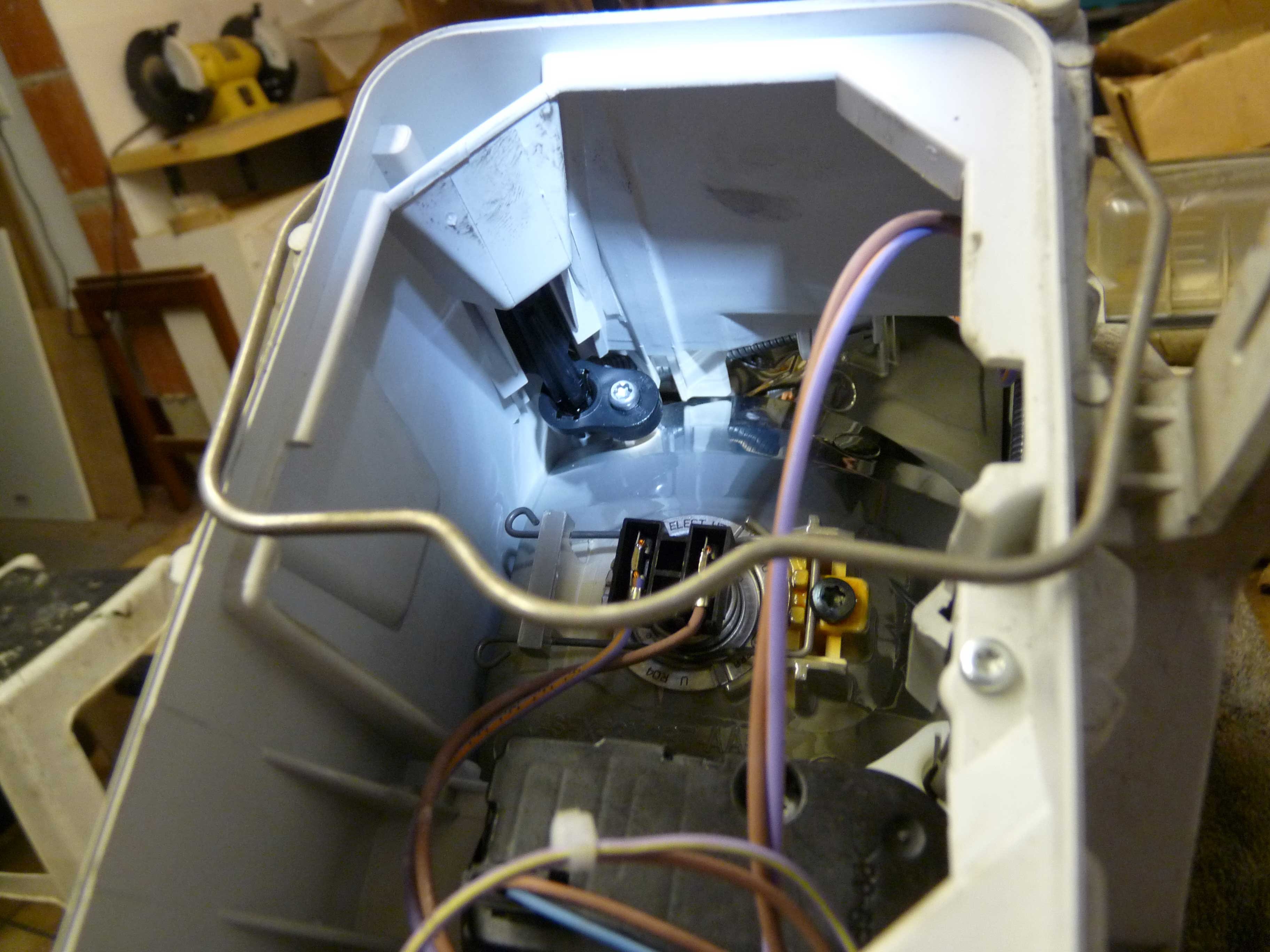

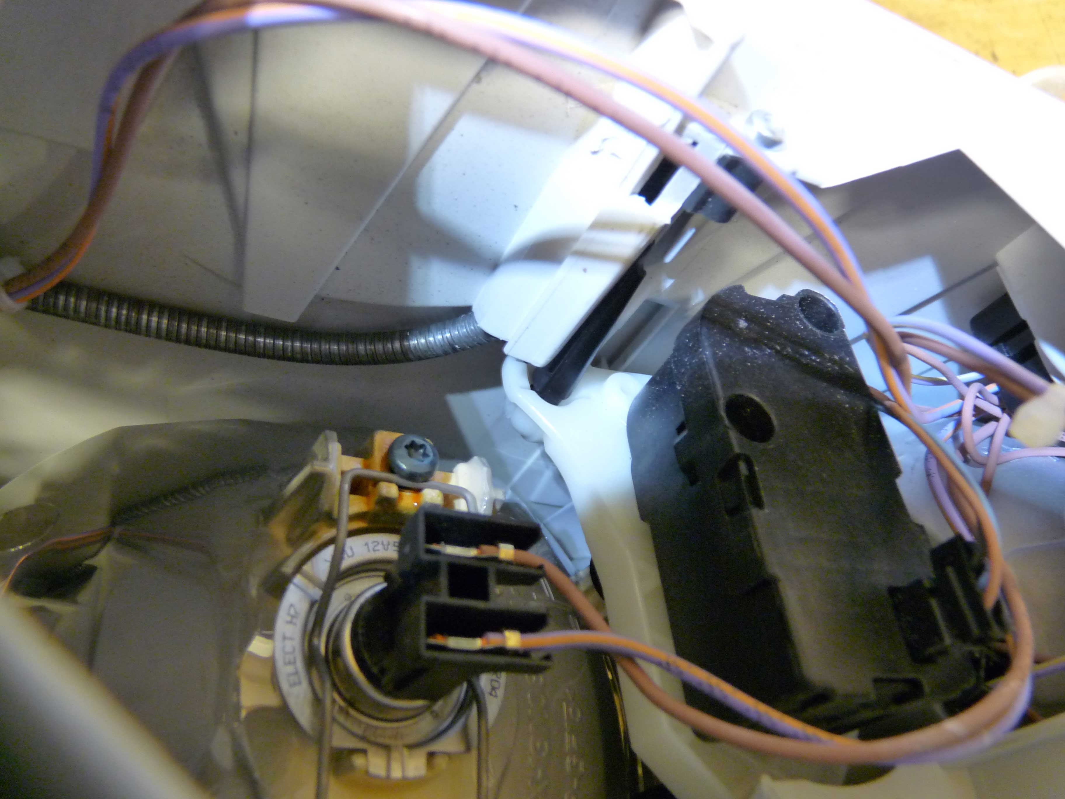

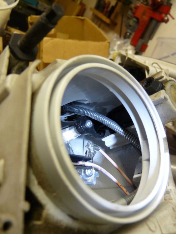

I removed the LH side head lamp. Turning the adjusters results in the reflector moving just as it should. There is no play of the reflector. Lamps are properly seated. I can see no reason for Norauto to report that the mechanism was "casse".  And I still do not understand what has been giving me the change in alignment. I shall attempt an alignment on a back road tonight - pity it is not winter!  Whether I can achieve a satisfactory setting for the next CT remains to be seen.  In the pictures the flexible drives and the 3 sockets for the balls on the end of the push-rods can be seen.

It was quite a fiddly job getting the headlamp to reseat properly and the hockey-stick slider does not seem to anchor the headlamp absolutely securely - maybe there was some panel damage from the accident which was not corrected and that is maybe responsible for the changing beams. (Except that that would not explain significant vertical alignment, which has been the major fault.)

If so you need to move the reflector inside and then reattach the adjuster screw to the centre of the adjustment rod. This will give you adjustment either way then and should allow you to set them correctly.
Seeing your images brings back memories, I had forgotten about the Bowden? cable bit as JR mentions.......
