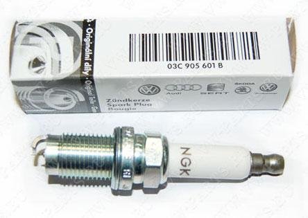

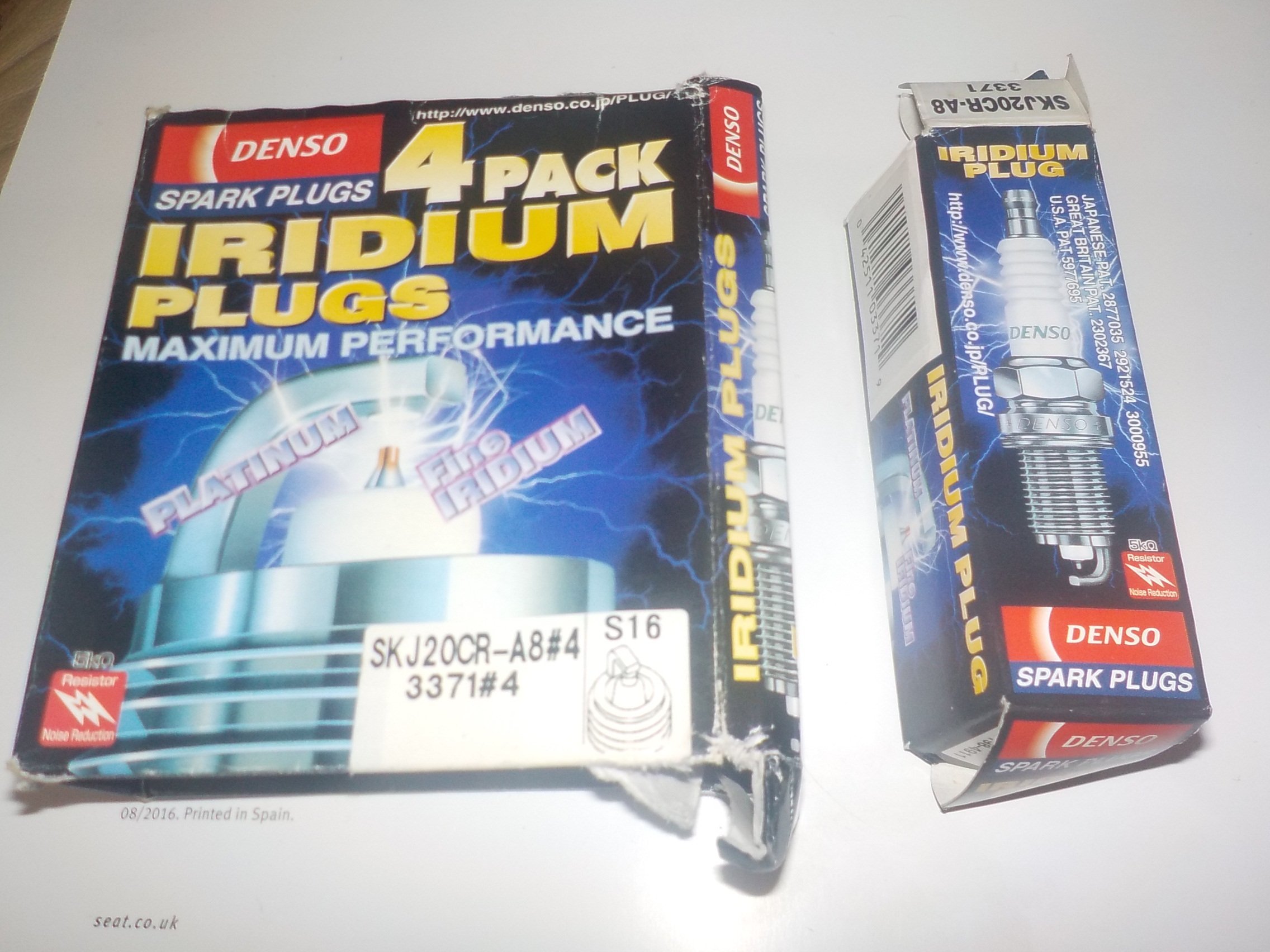

Find out what plugs are in.
I suggest you get DENSO plugs but get the NGK or Bosch if you want.
Set to 0.7
Then see how things are.
In Limp mode 2 cylinders can shut down, or the turbo disable.
Possibly you need the water pump / magnetic supercharger clutch replaced.
