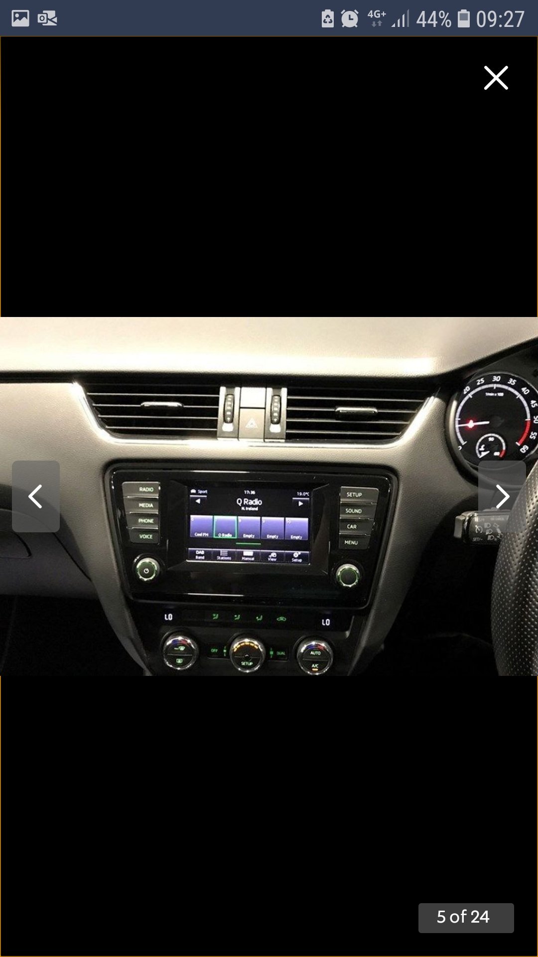

Looking at buying a 64 plate VRS and it has this radio installed. Unfortunately, I really want Smart link (which this radio doesn't have).
1. What model radio is this (and how can you tell)?
2. Is it possible to fit a different model radio (with Smart link) to this age model? If so, which model radios will work?
i've just done this, check my thread where all my questions were answered, Sasha was really helpful on there,
That's a bolero mib1. You'll need an mib2 unit plus a new screen to get smartlink. Looking at £500 for Amundsen level or £1000 for Columbus. That includes removing component protection and then recoding the unit to match the car.
Look on eBay for parts, local dealer for CP removal, then pab567 (Pawel) for coding.
