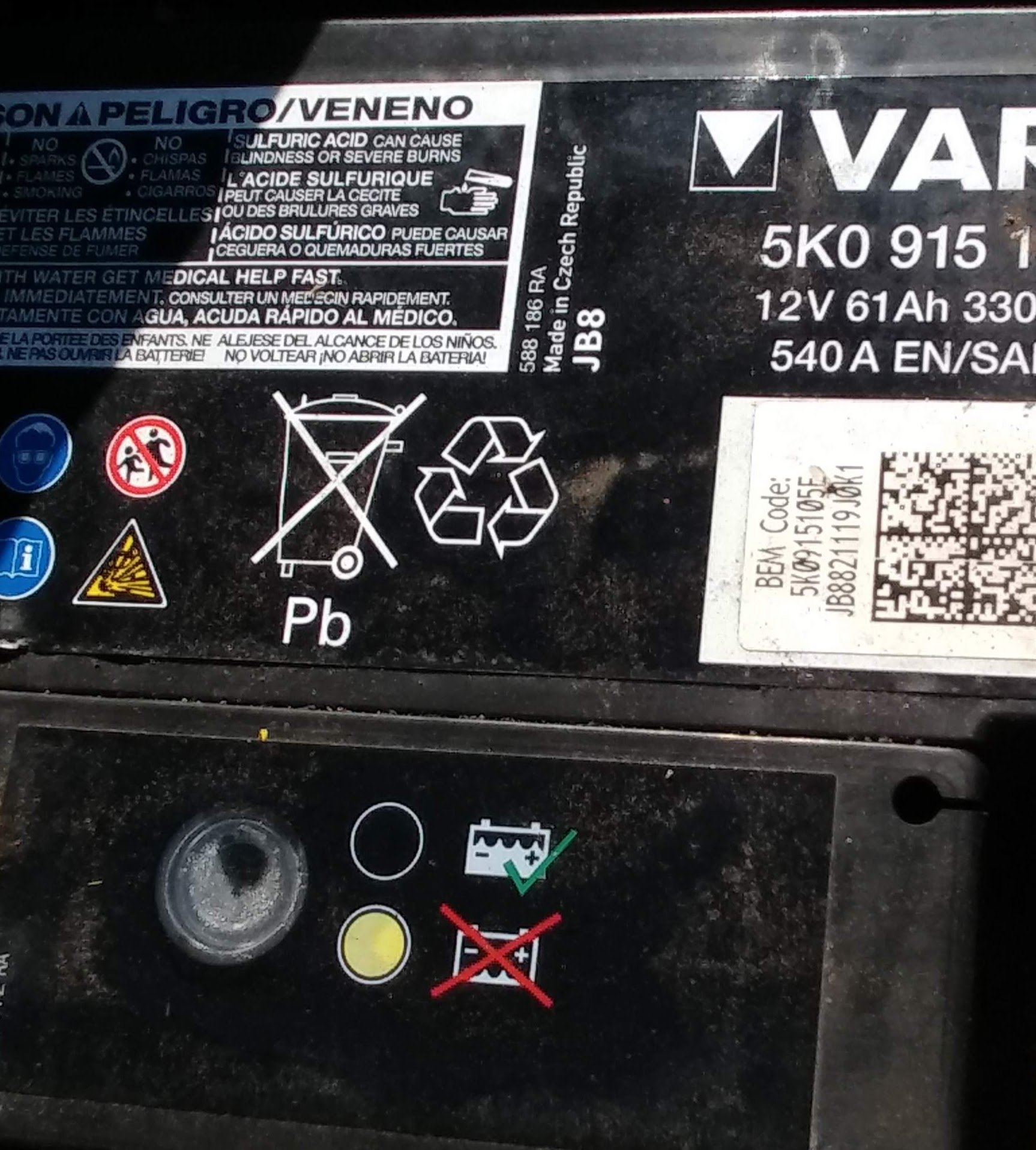

Yes you are right, checked this morning and the Varta battery indicator is now showing a fault. (see pic)
Booked in this week for a new battery.
