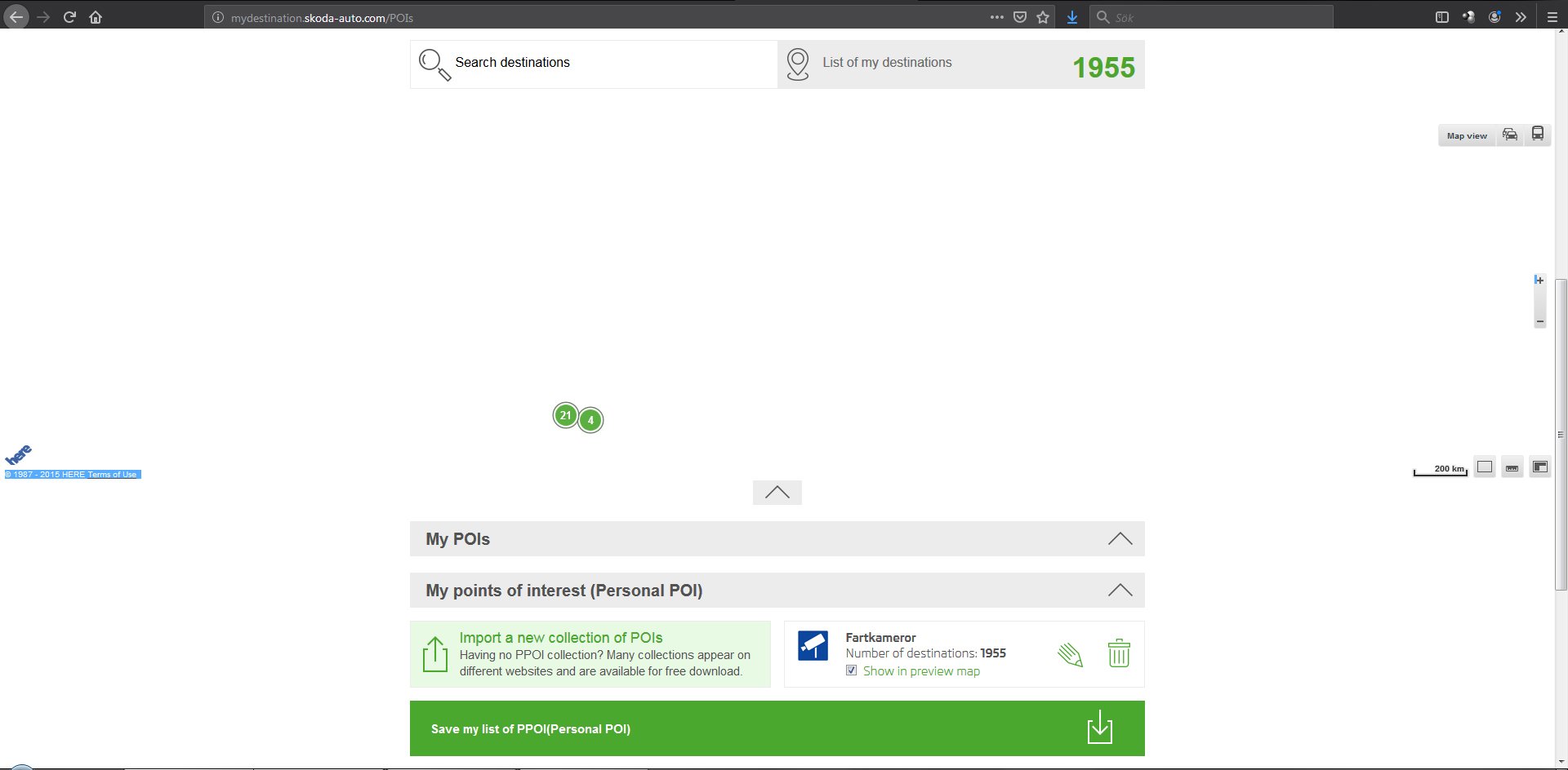

In "My Points of Interest" on https://skoda-connect.com/portal I've succeeded to add speedcams with logo, into my Columbus from Portal (via online update).
Fine so far... But with no sound alert?

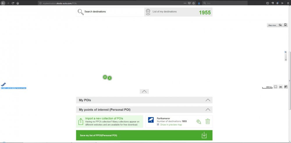

Then I read that http://mydestination.skoda-auto.com/POIs would fix that "problem".
I've succeeded to add speedcams with logo and "Sound Alert", then saved the .zip-file.

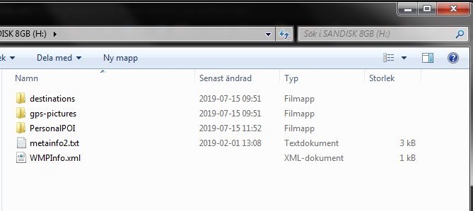

Unzipped the files into a SD-card (even tried with a USB-stick) and tried to install it into my Columbus.
Then the error occurs (see the video in link. Text in Swedish...), something like:
