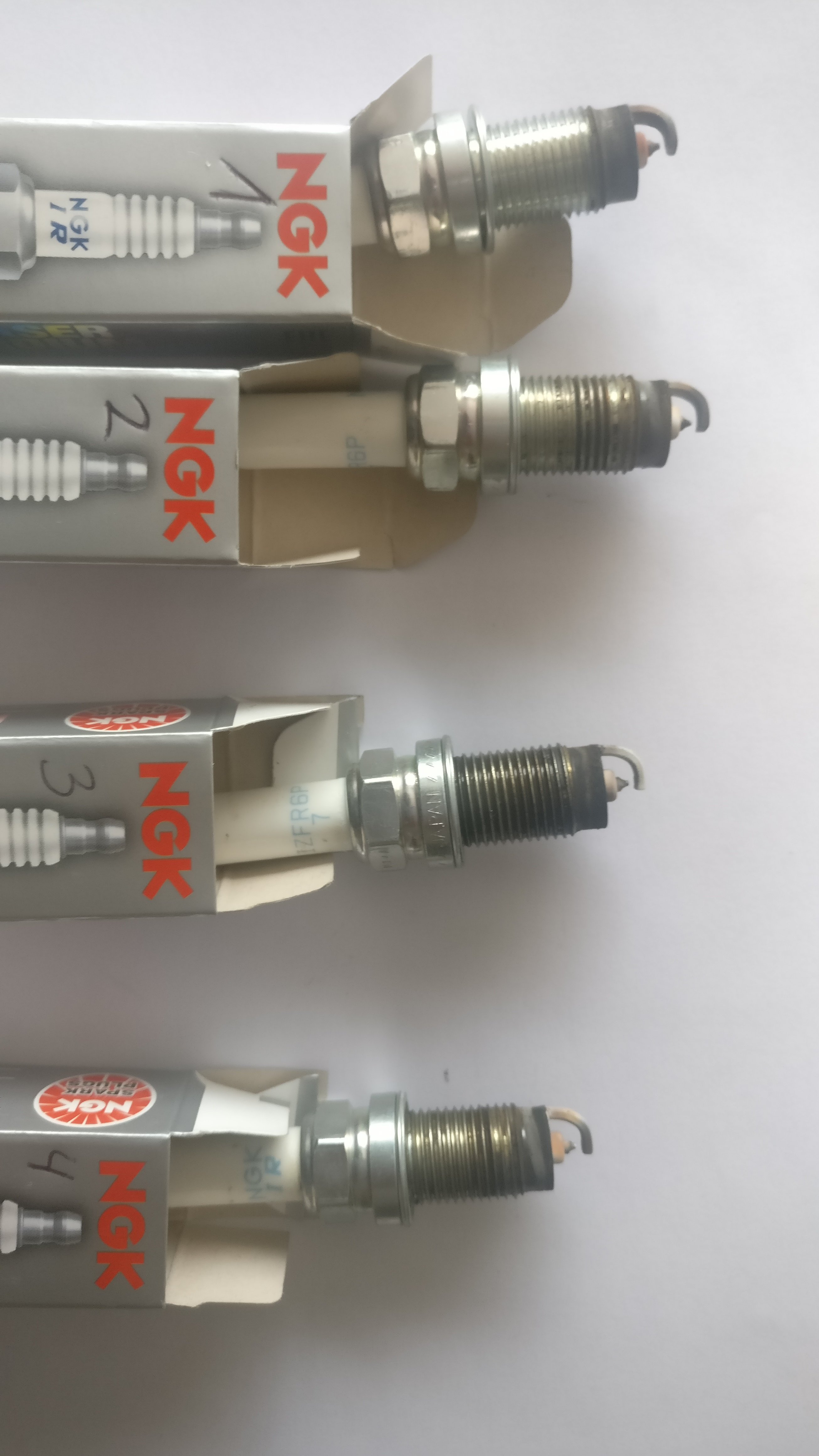

I've also attached a picture of the plugs that came out, don't seem to be in bad order.
Edit: just undone all the plugs again and it seems to be number 3 as it was oily coming out. The old number 3 was oily as well. Should I consider changing the coil pack? How come after changing the plugs it has gone worse?

I fiddled with the wire for third cylinder coming from ignition pack to coil (twisting the connections on both ends) and after having checked all the plugs again, seems that misfire has almost gone, but a singular one every now and then. Also seems that it was number 3 before changing the plugs and after, that is misfiring as it is the only oily one.

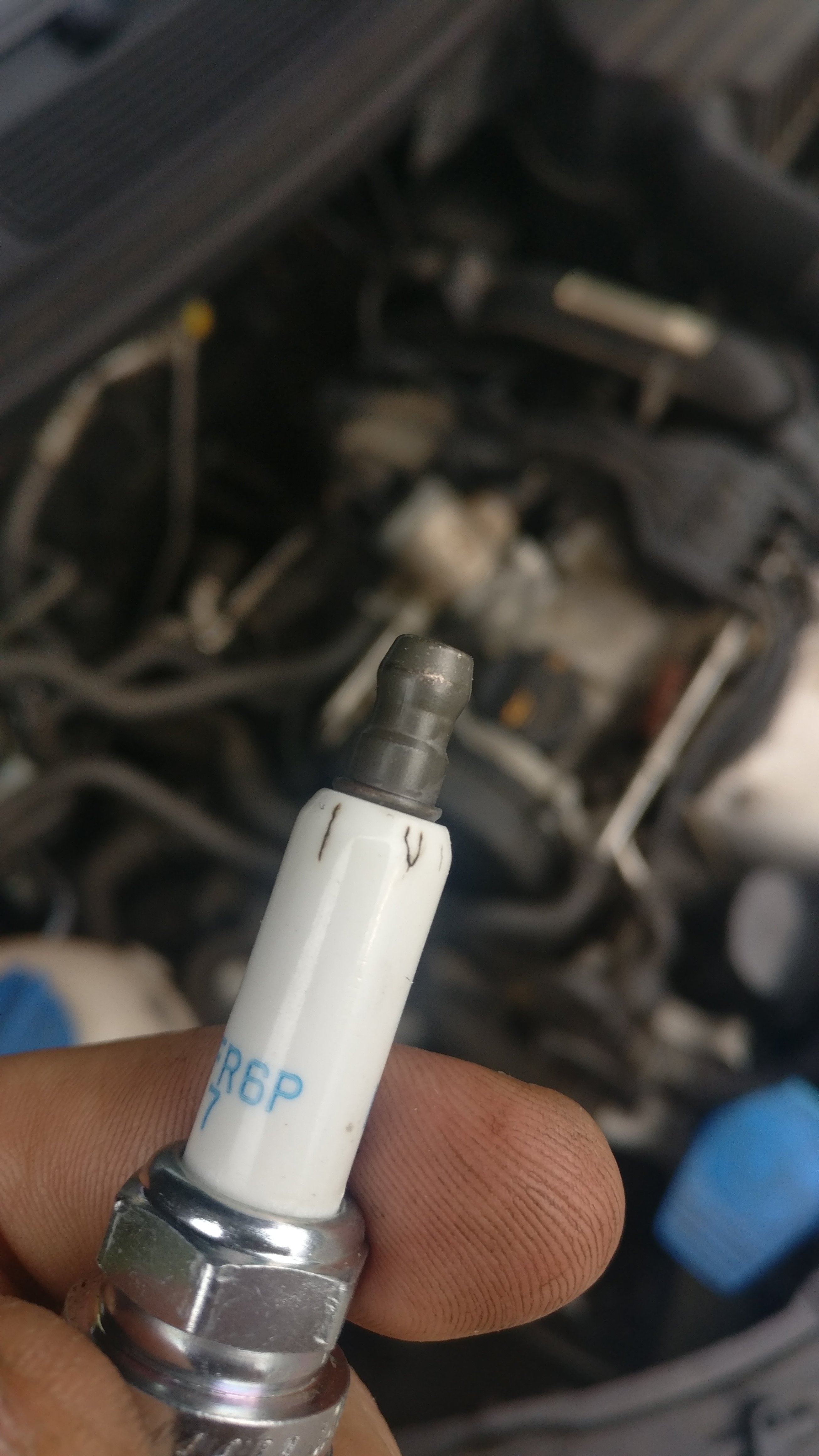

After I got it running decently smoothly on idle again, I took it around for a spin, and then realised that as I'm trying to accelerate, it misfires bad. Sure enough it was cylinder 3 again, but I noticed that the ceramic has distinct burn cracks in it. So I swapped it out for an older plug from cylinder 2 and same essentially.
Swap it out again, idle is essentially misfire free but as I get to higher gears it starts to misfire when I try to accelerate (especially with 4th and 5th gear, low RPM, slight uphill and try to accelerate). After some driving, seems like it starts to do even with 3rd and 2nd with lower loads.

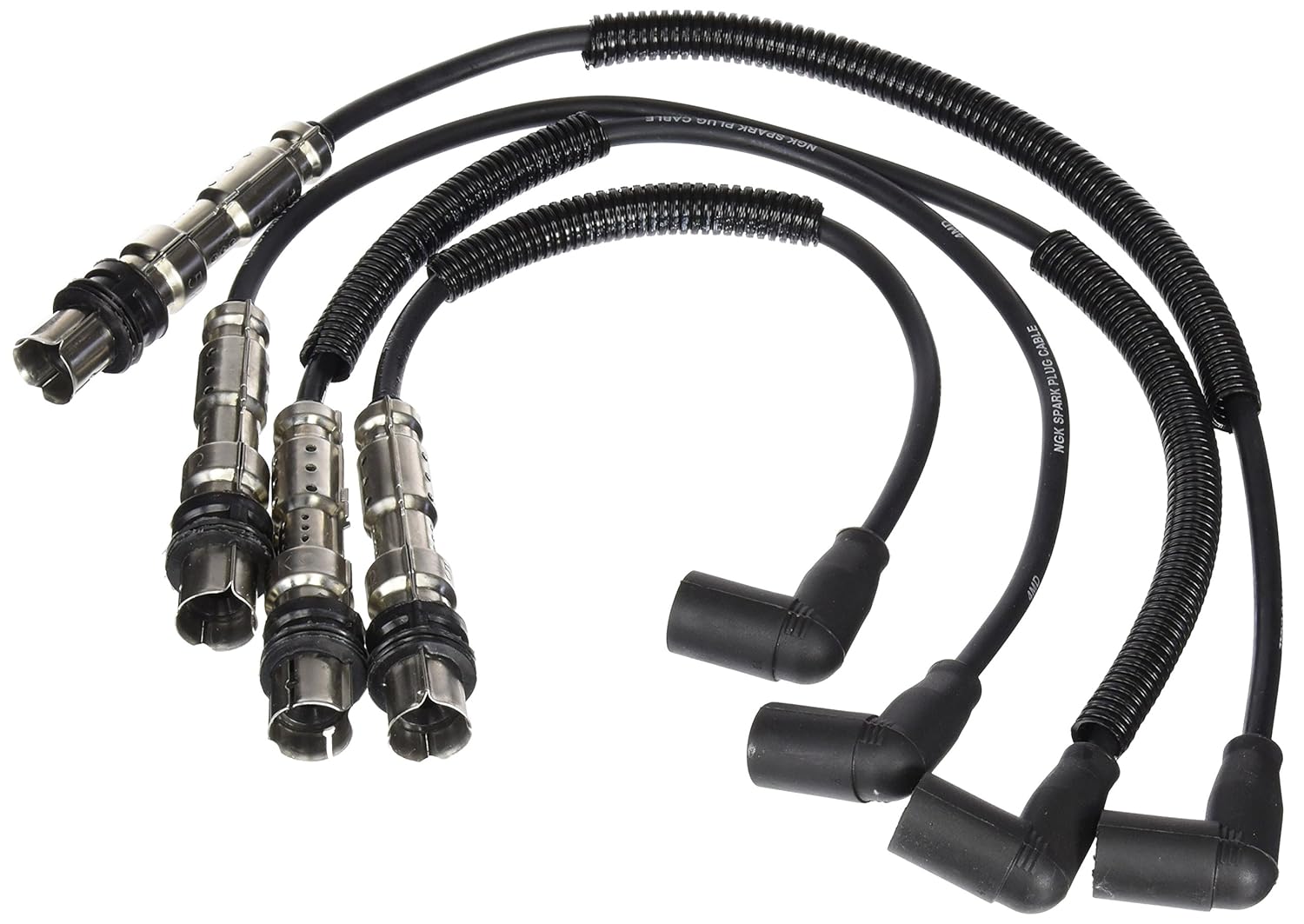

How did you remove the leads? You need to use a tool (Sealey VS5293) to pull the metal boots off, if you pulled by the leads, its probable you will have broken the lead.
If your car has the old plain leads without the corrugated trunking then its very likely that No.3 is duff anyway and has been for a long time. You can check with a  multimeter that the lead has gone open circuit.
Recommended to change the set. About £43 for an OE set
NGK-44316-44316-Ignition-Cable-Set
If after changing leads its still misfiring then the damaged leads, further disturbed have probably taken down the coilpak. The early ones were prone to fail when no.3 lead went. Fortunately the coil pack is quite cheap and easy to change. Available from around £25 iirc at many outlets.

Update: Swapped the ignition leads and is running smoothly again, many thanks for helping me out @xman and @Roottootemoot in my stressful situation.
