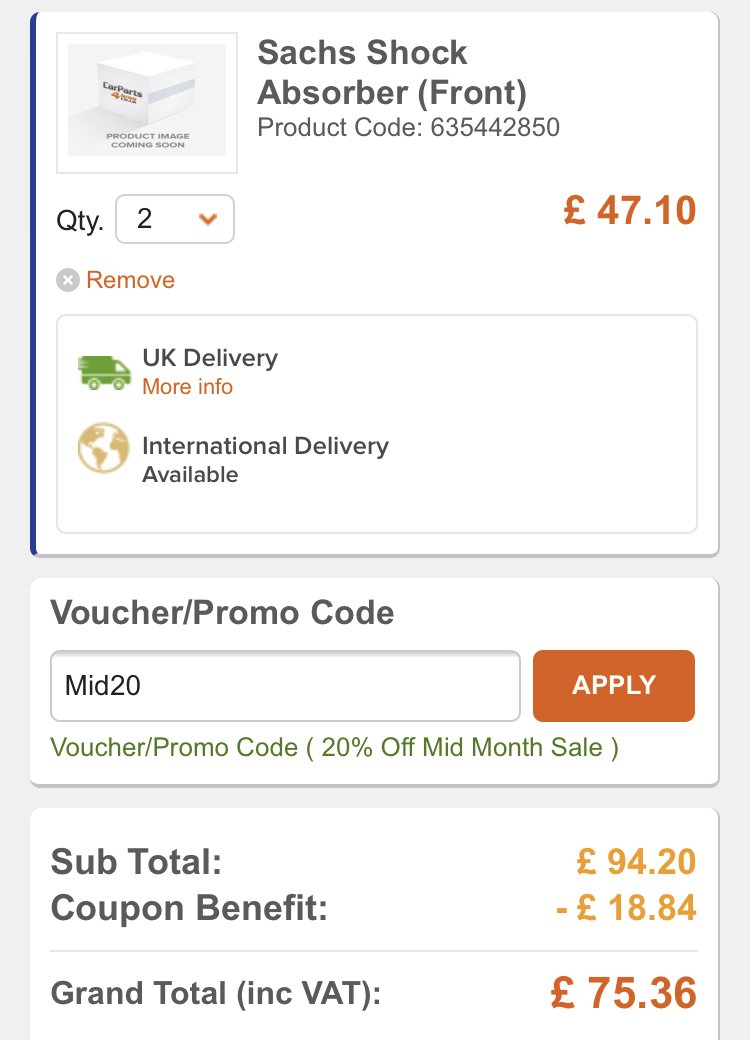

£33.60 from demon tweeks
Sachs from Euro are £70+ even with the discount codes I’ll have a ponder 🤔
£70 for the pair for the front, I thought that was reasonable. Not saying Bilstein ain’t good though, not the quality they once were however.
£70 each! 🤔
6 hours ago, mak-71 said:
£70 each! 🤔
Got a full set of  Sachs on order and some drop links from Euro.
MiD 60 code brings it all down to a more palatable price!
