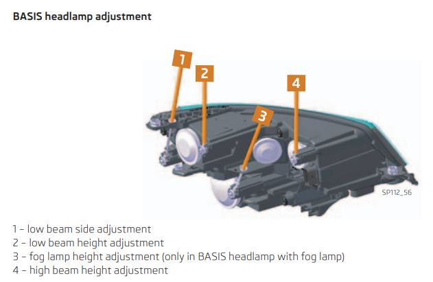

Else turn the beams down a bit under the bonnet. I’ve successfully turned my bike headlamp down a bit for foreign travel and never had any trouble. No stick on nonsense to decrease the light output.
I'd avoid adjusting the headlights from under the bonnet, fine for lowering them, but when it comes to setting them back for driving on the left you'll need to have them properly aligned to get them right, a half a turn is the difference between dazzling or not.
Some French gendarmerie can be finicky too, simply adjusting the headlights down to their lowest setting using the dash adjuster and not being able to prove you've done it properly might cause some headaches at the side of the autoroute.
Not sure about the Kodiaq halogens, but I seem to recall in the past that Skoda projector headlights used to have a lever near the bulb holder, that you could move to another position and that would remove the LH kickup and make it a flat beam suitable for driving abroad.
Perhaps buried somewhere in the user manual?
Mentioned earlier in this thread, and in the linked thread above, but not confirmed.
Nothing obvious in the workshop manual...
Edited by silver1011
I’ve had a halogen headlamp out and did not see any lever for LHD setting unfortunately
