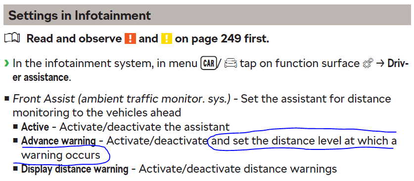

Have you tried adjusting the sensitivity?
Ours used to get easily confused, but we dialled down the sensitivity in the infotainment system and it's largely been fine ever since...

Mist, heavy rain or snow all seem to upset the sensor. The default setting is also too sensitive, since using the medium setting I’ve had a lot less false warnings.
False warnings are not the same as "sensor impaired" which indicates its not working at all , altering the distance at which it alarms will not stop the "impaired" error , you just wont get as many warnings. Looking at other forums for VW's etc its a pretty common problem , which I guess I will have to put up with
