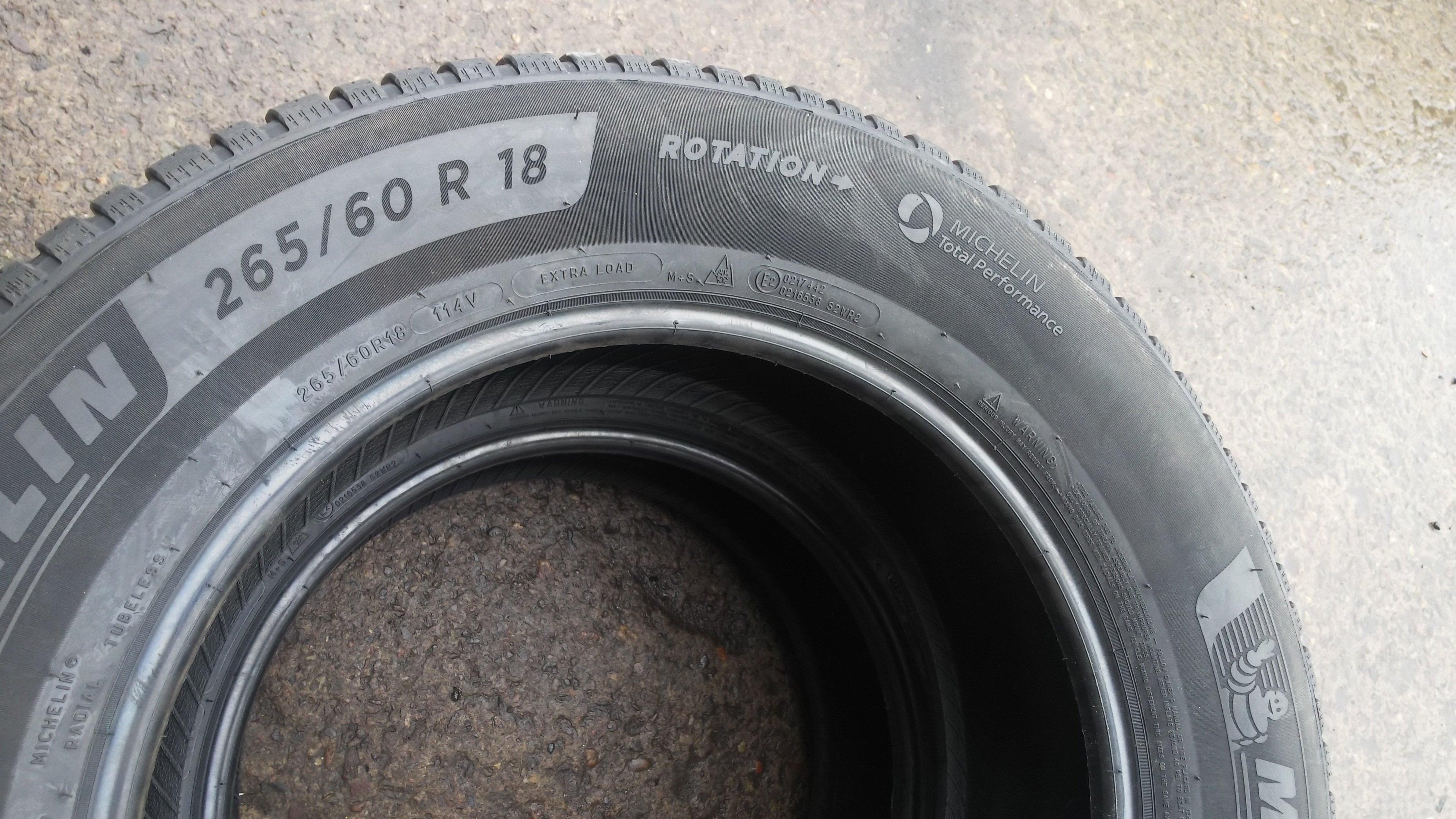

I did go down to 265's instead of 285's for my CrossClimates, but that is not really narrow.
On lighter 4x4s i usually have 235's on for Winter / Snow.
