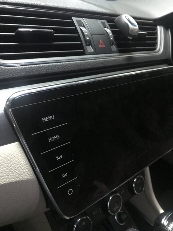

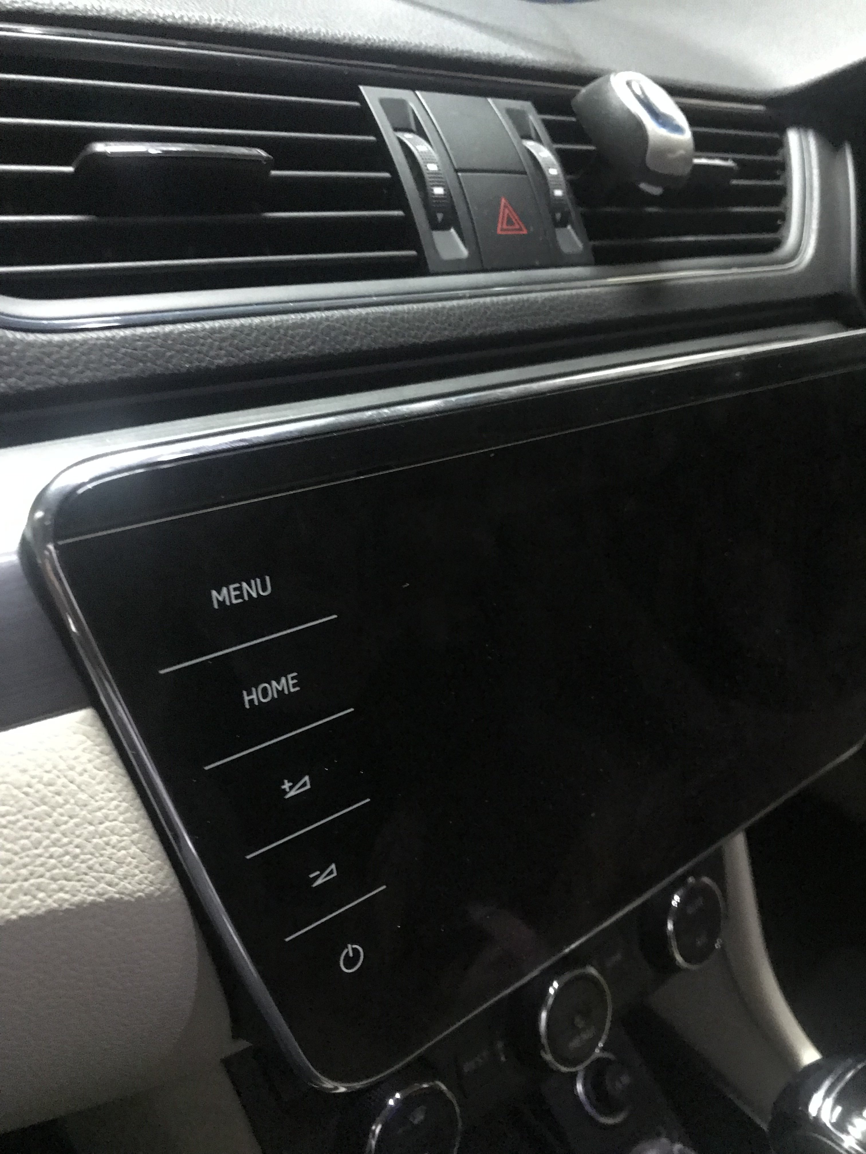

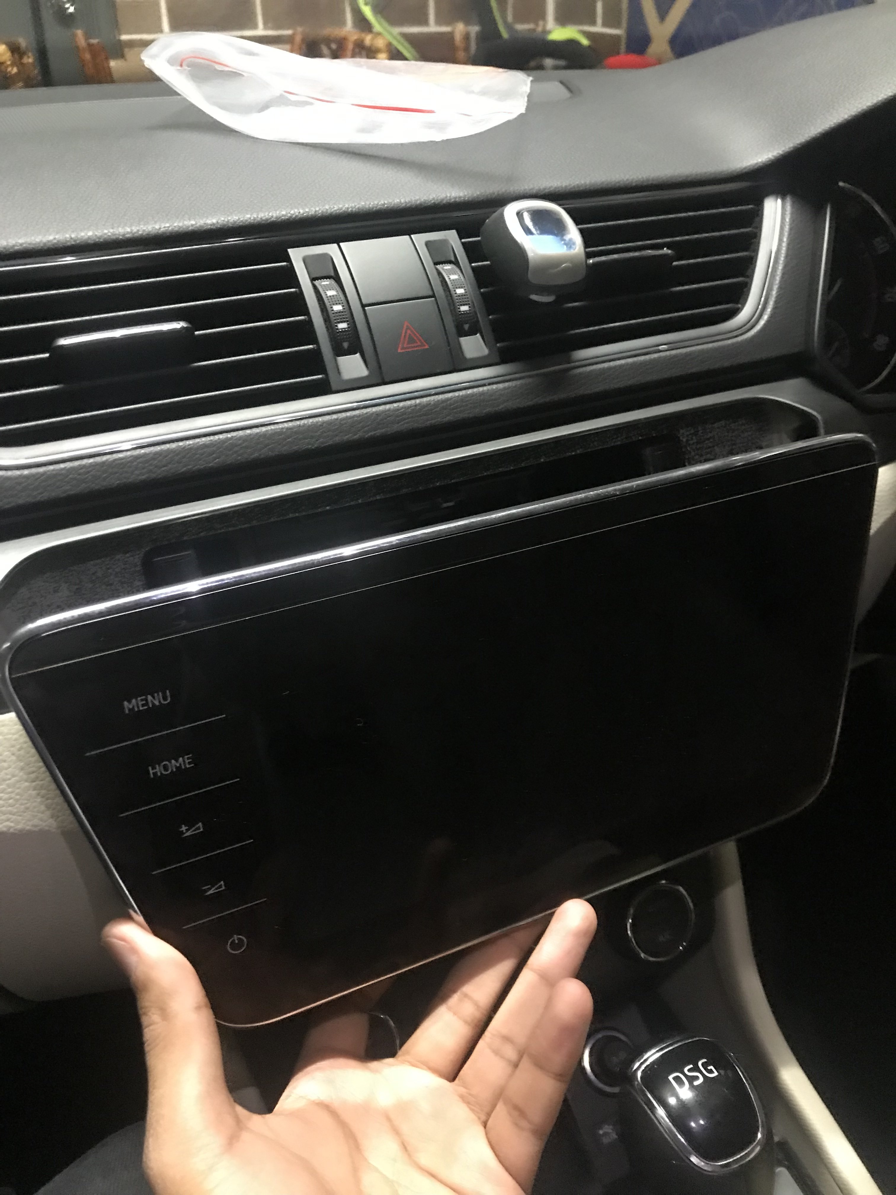

So mid upgrade and already I have occurred some problem and wondering if anyone knows a fix.

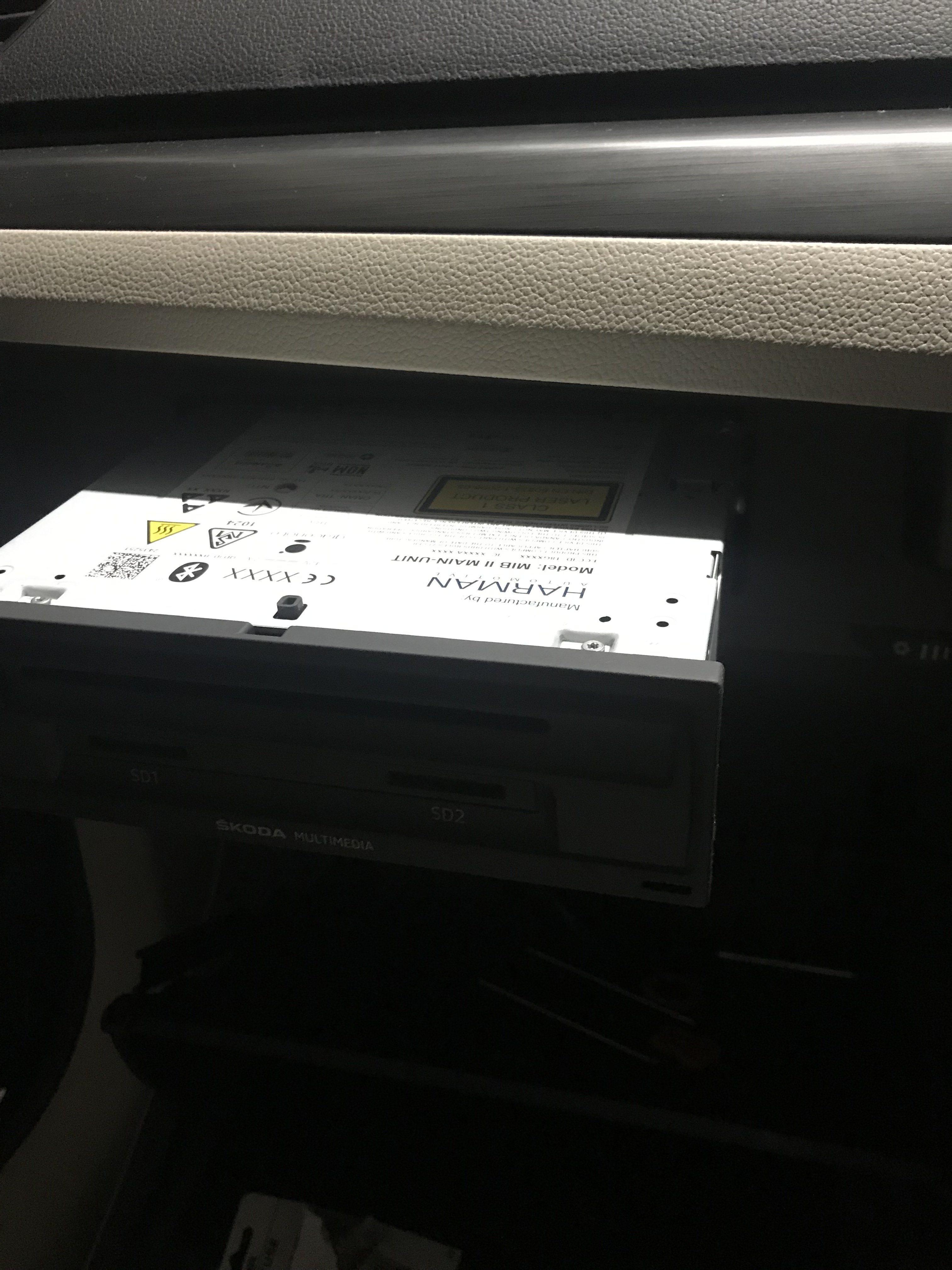

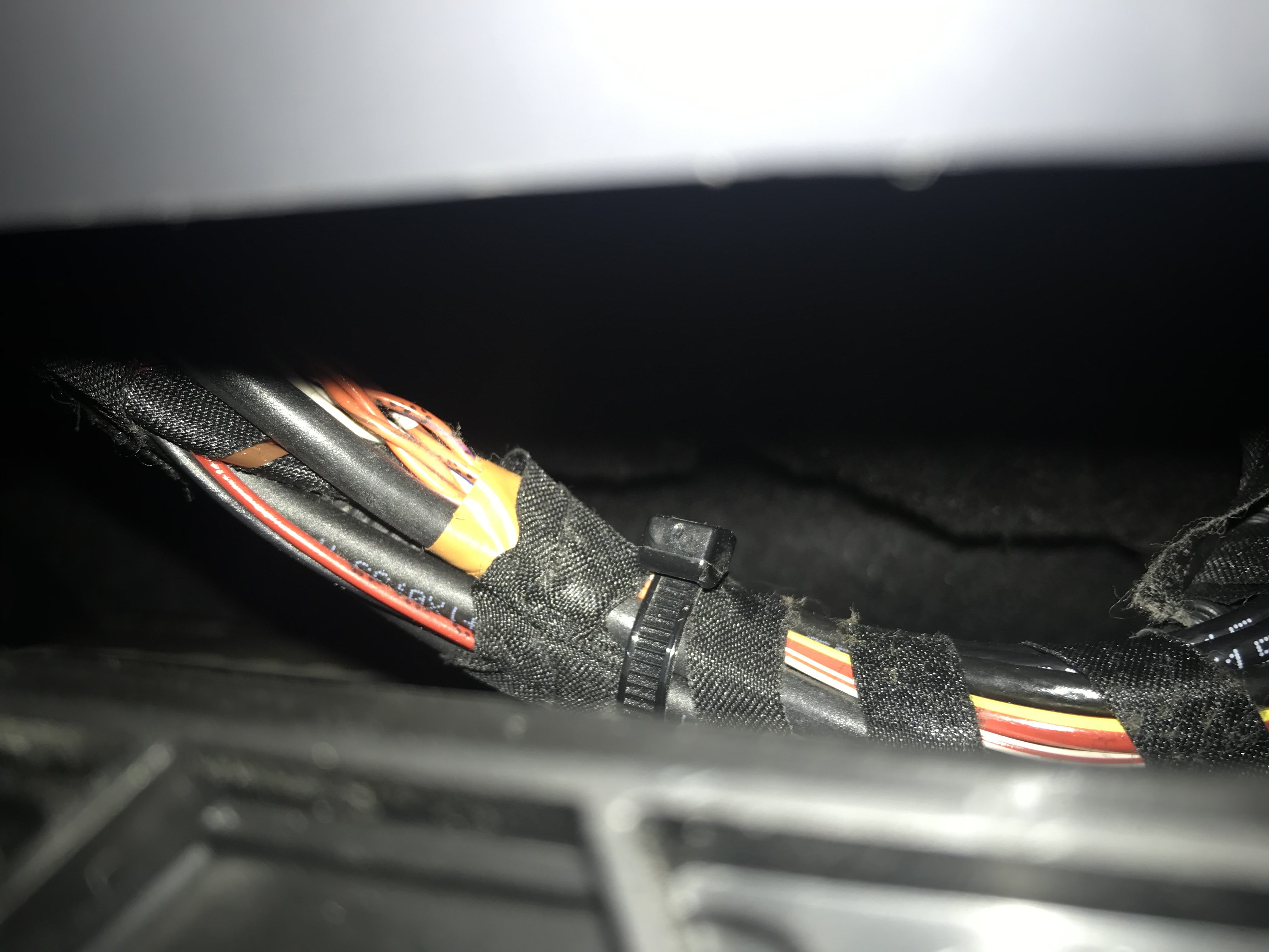

1- I can’t fully remove the MIB 2 control unit, the wires are secured by a strap which I can’t seem to reach. I think it was added when my dash speaker unit was replaced but not too sure.
2- The upgraded screen doesn’t doesn’t seem to sit flush or stable enough as the aluminium trim panel that runs across has curved shape vs the angular shape of the new screen. This is likely to be user error but tried various positions without any luck.
