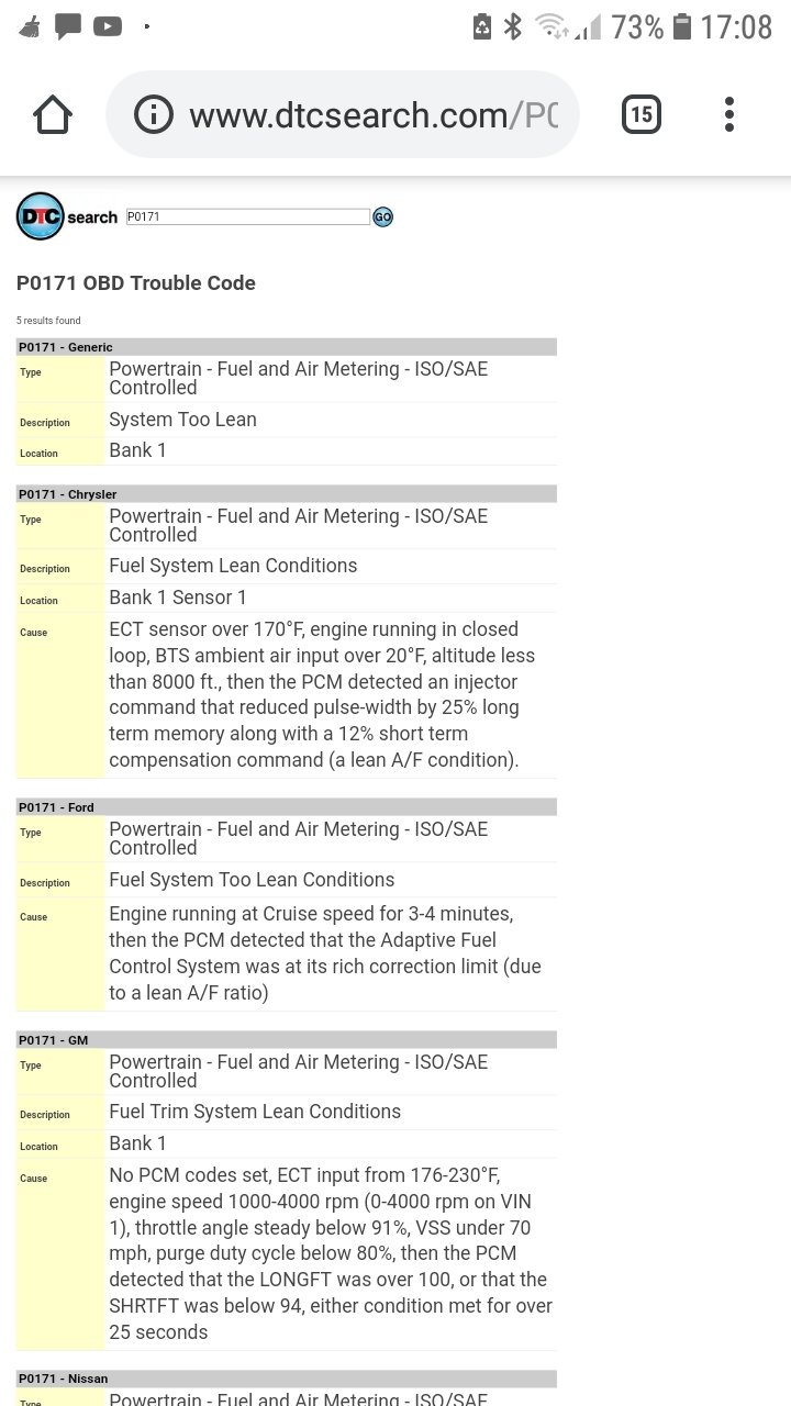

Hi guys, i have a problem with my Skoda Fabia 1.2htp, the check engine light is on and i have the faut code p0171. Do you have ideea what it can be? Thanks and have a good weekend!!Screenshot_20190617-170858_Chrome.thumb.jpg.15fb8d5c6522b8684c030835951a2ef9.jpg

Indicates an air leak on the intake.
