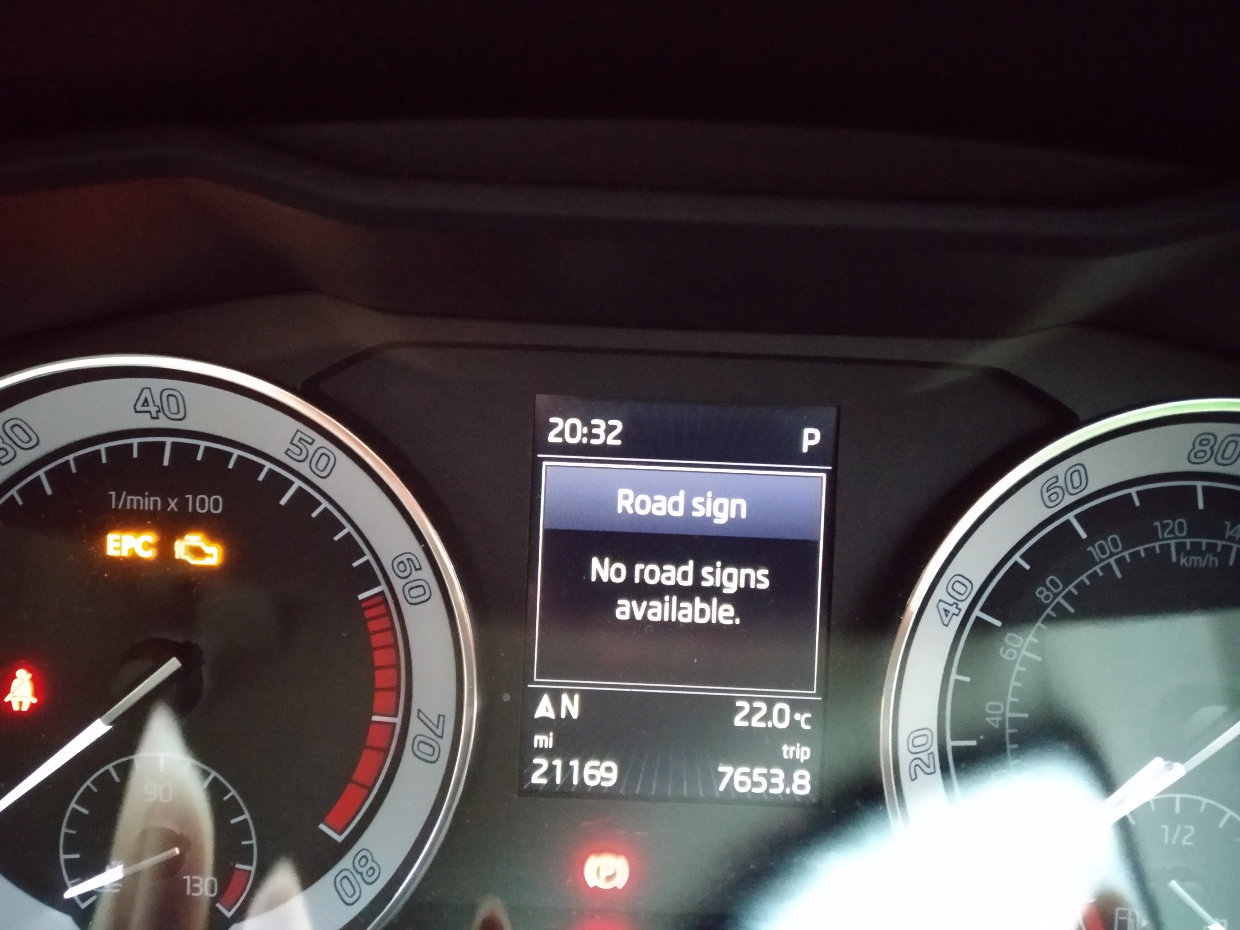

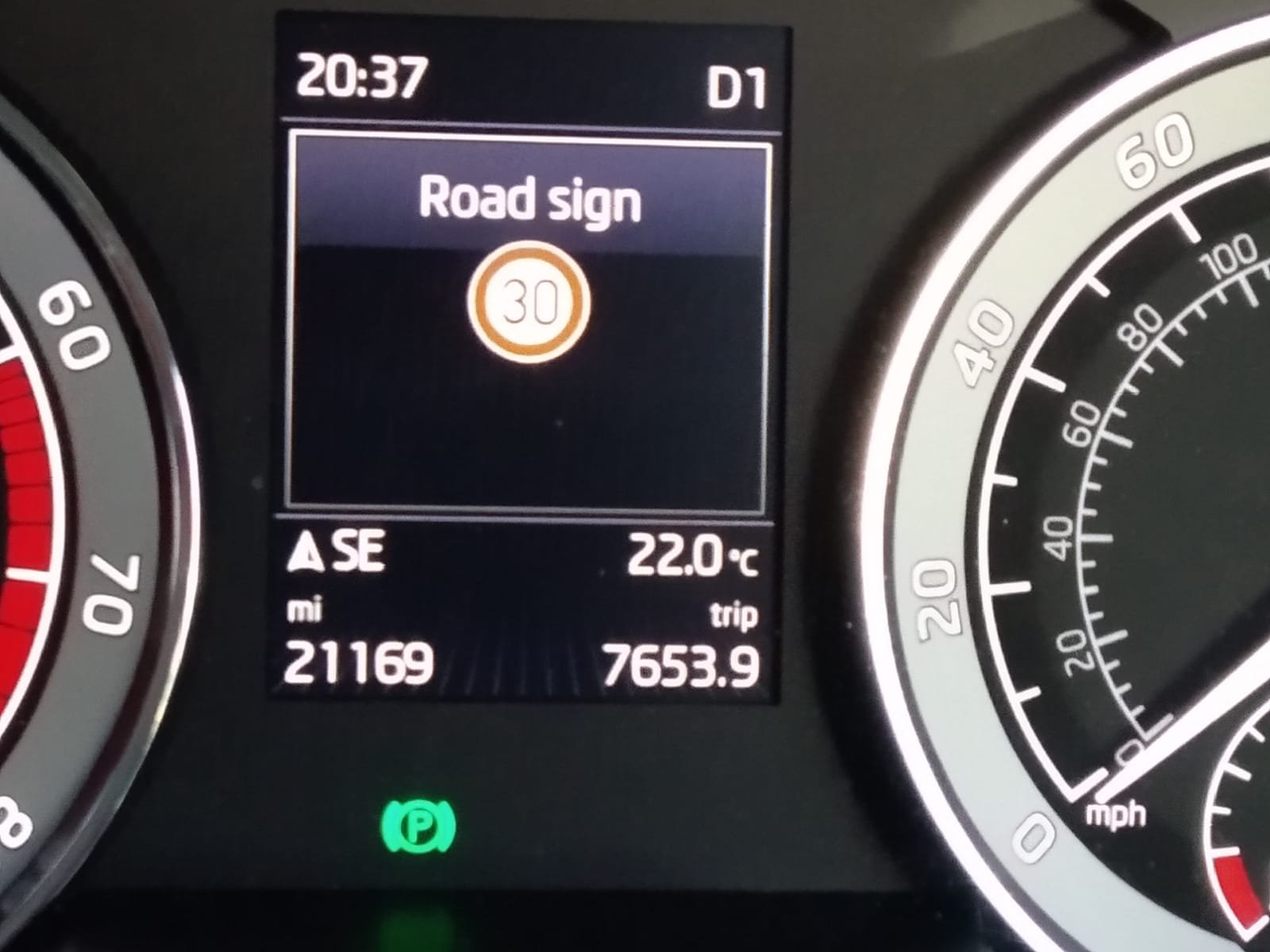

All was fine for a whole ten minutes when the driving speed disappeared and was replaced by a road sign and nothing will get rid of it under driving data. Tried deselecting show road signs in instrument cluster, makes no difference. Any ideas?
Just seems a weird thing to happen.
First photo is when initially turning ignition on, second after moving off then stopping.
Working fine again now. Not sure whether to still take it in or not as it's being a bit temperamental.
The system uses both camera and the built-in SatNav.
When you get in the car after it's been parked up there is probably no speed limit sign within view of the camera so it checks the SatNav for the speed limit of the road.
Not all roads have the speed limit data available and if you're starting off in one of those roads you will get the "No Road Signs Available" message until either you enter a road for which the SatNav has the speed limit data or the camera picks up a sign.
It shouldn't cause any problem with scrolling to other settings so you may have a temperamental scroll wheel - a problem that others have mentioned elsewhere.
