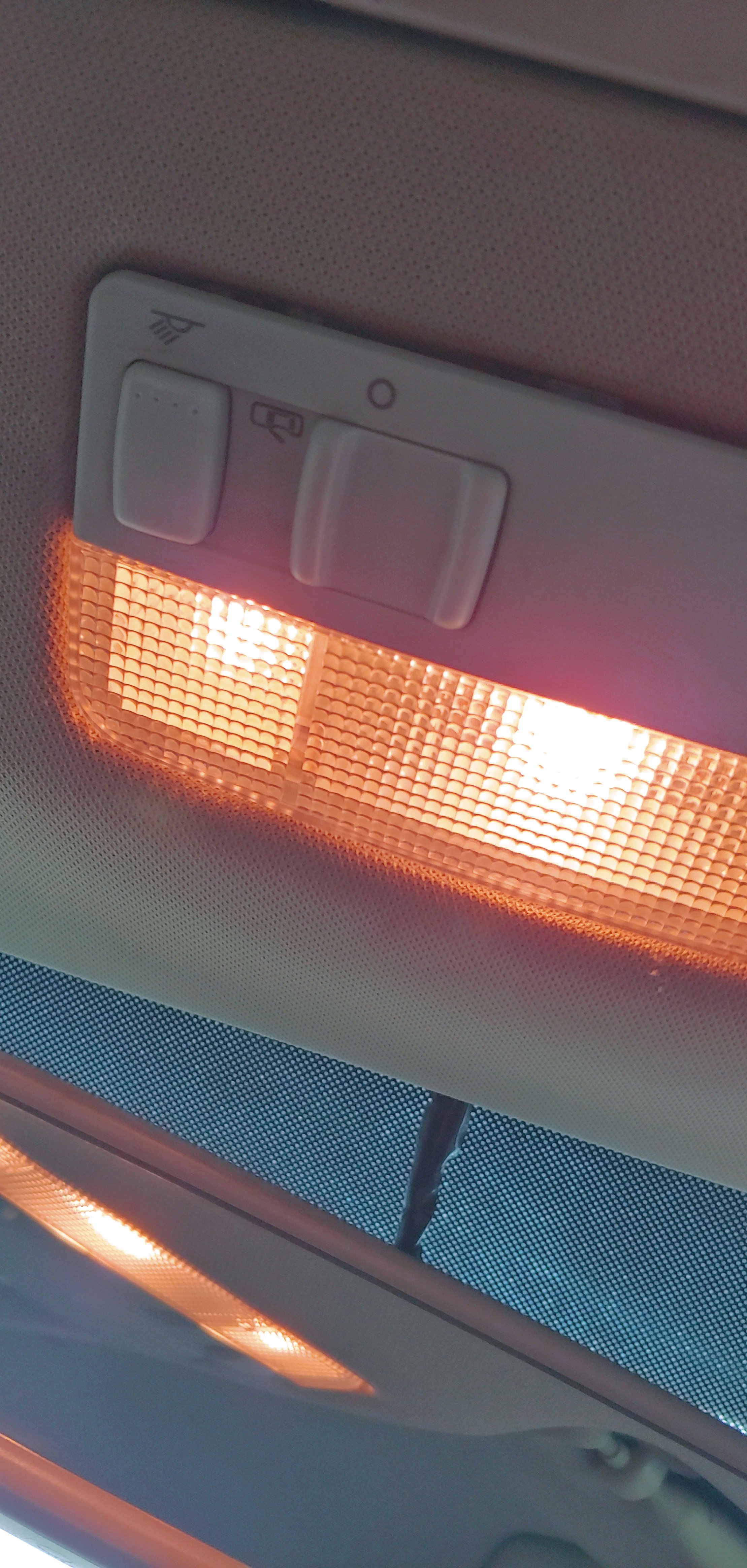

So I have 2011 Skoda Laura(known as Octavia globally) MK2. Recently, i am facing a issue with interior lights( lights placed on roof ). When keeping lights on the door position(refer pic below). they should go off once we start engine but they are not going off. They are going off only when i lock the car from remote. They are behaving like i have put them on ON position. Rear lights are not working in any of three position. PLEASE HELP!
(No door is left open ).

Yes, in the rear i have tried a new bulb but it is not working in rear.
(A) yes they turn off in off position.
(B) yes the map lights are working fine.
(C) Car is 2011 model and i am facing this issue from a week now.
(D) in other position it is working fine.
I don't think someone has messed up with my car.

Re the front not switching off on door closing............based on your answers logic says broken door (micro?) switch.
Maybe possibly a short in the wiring but i would think this not so likely.
I would possibly agree with the switch sticking if the light wasn't working, but it is. (assuming they operate in the way i'm thinking).
Re the rear not working...........you state you have fitted a new bulb..........just to confirm............do you know this new bulb actually works???
A few folk have given ideas on this already which are worth checking first.
Remove the lights (very easy to pop out) and look them over and visually check the wiring too.
