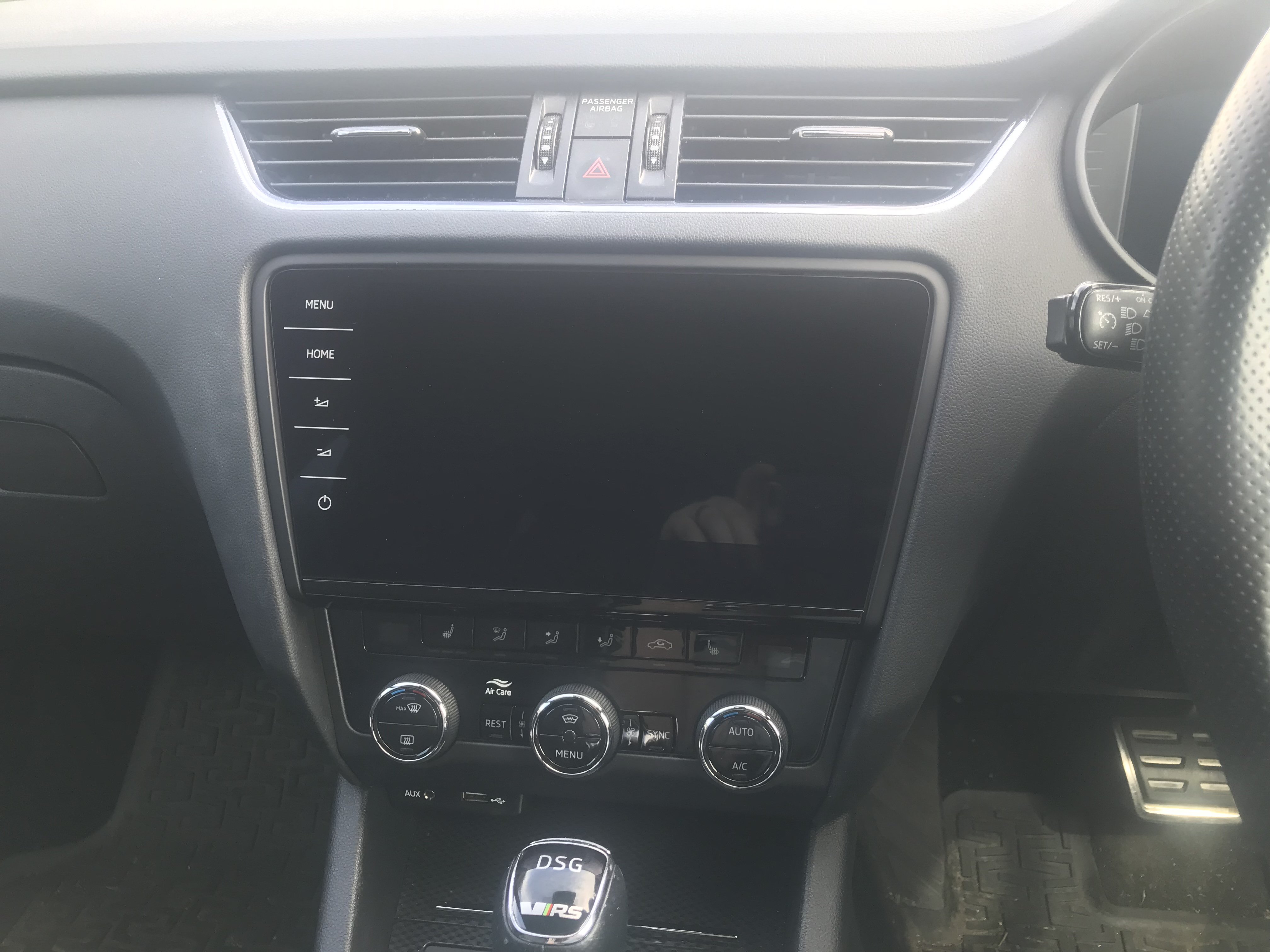

Just looking at the photos of SashaGraces installation, and most say it looks amazing!

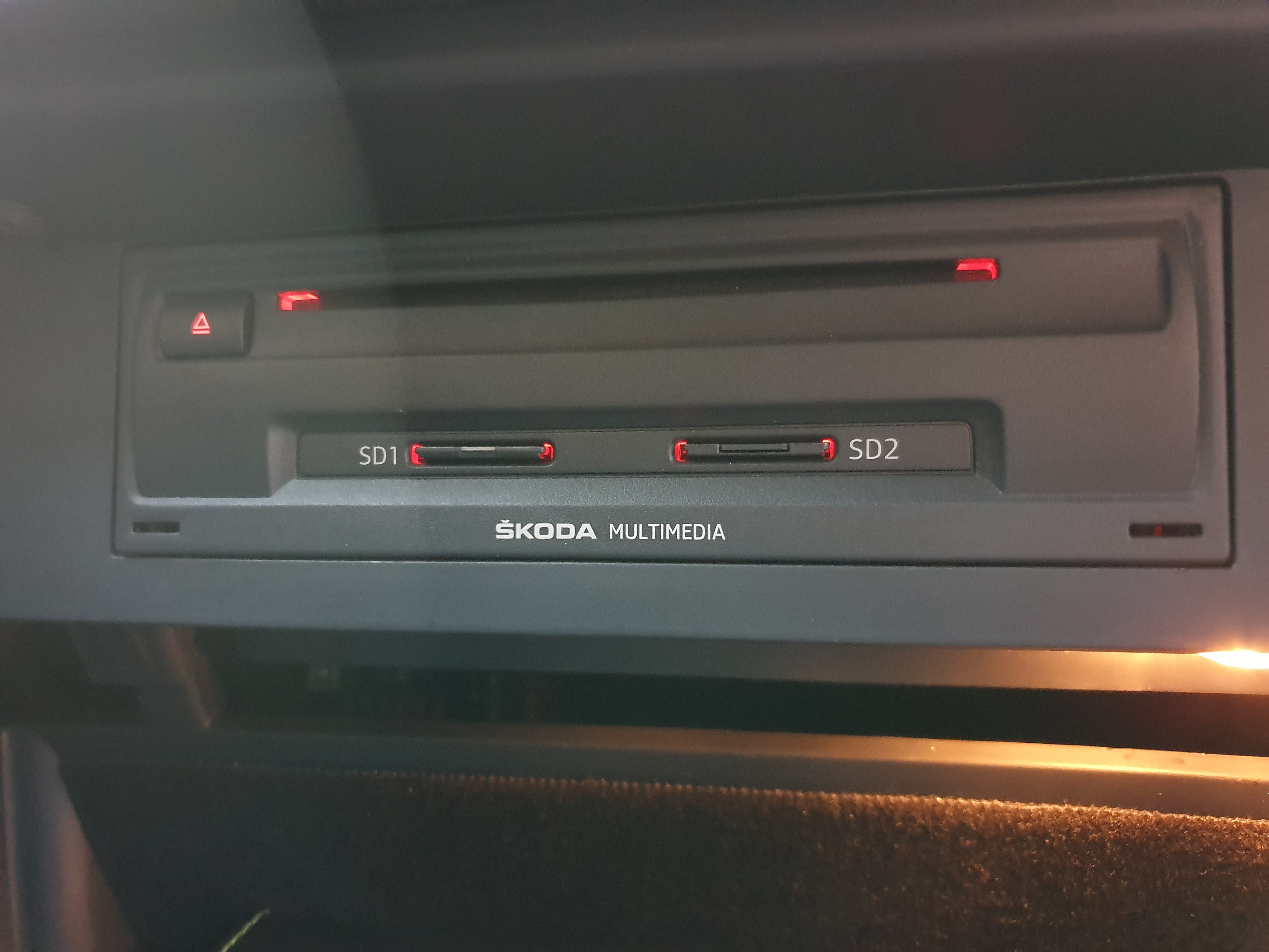

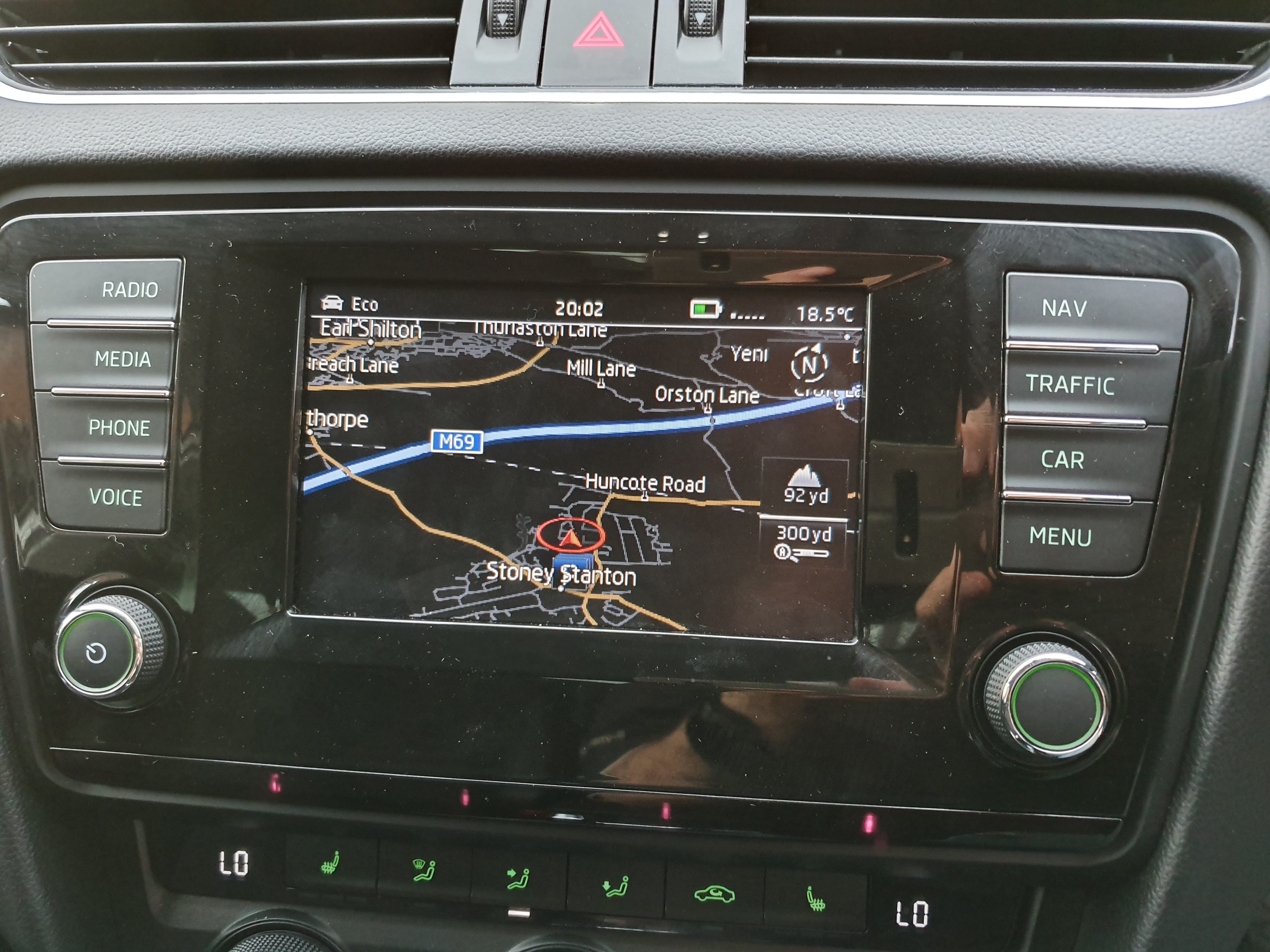

Just bought a 2014 elegance and want to upgrade to a bigger screen,  but need some help with what's available,  and best way to go about it please.
My current equipment is in the photos
This looks like MIB1 Amundsen. You must have both screen and glove box unit replaced and hacked.
Thanks @pab567 What exactly do I require to do this?
You need to make a decision on which radio you would like. If all you want is extra screen size it’s an expensive way to get it but you’ll also be getting SmartLink, a nicer UI and a bit better sound quality out of the deal. I recommend a MIB2 Amundsen (5Q0035874A B or C depending on how much you want to spend) and an 8 inch screen 5E0919605M which is compatible but the APP button will only work on the 5Q0035874C radio as that’s the radio it was built for. You’ll also need a USB 5Q0035726E if you have an iPhone and you want to use Apple CarPlay. The radio unit will need CP unlocking and then rework by Pab567 to work in the car :)
