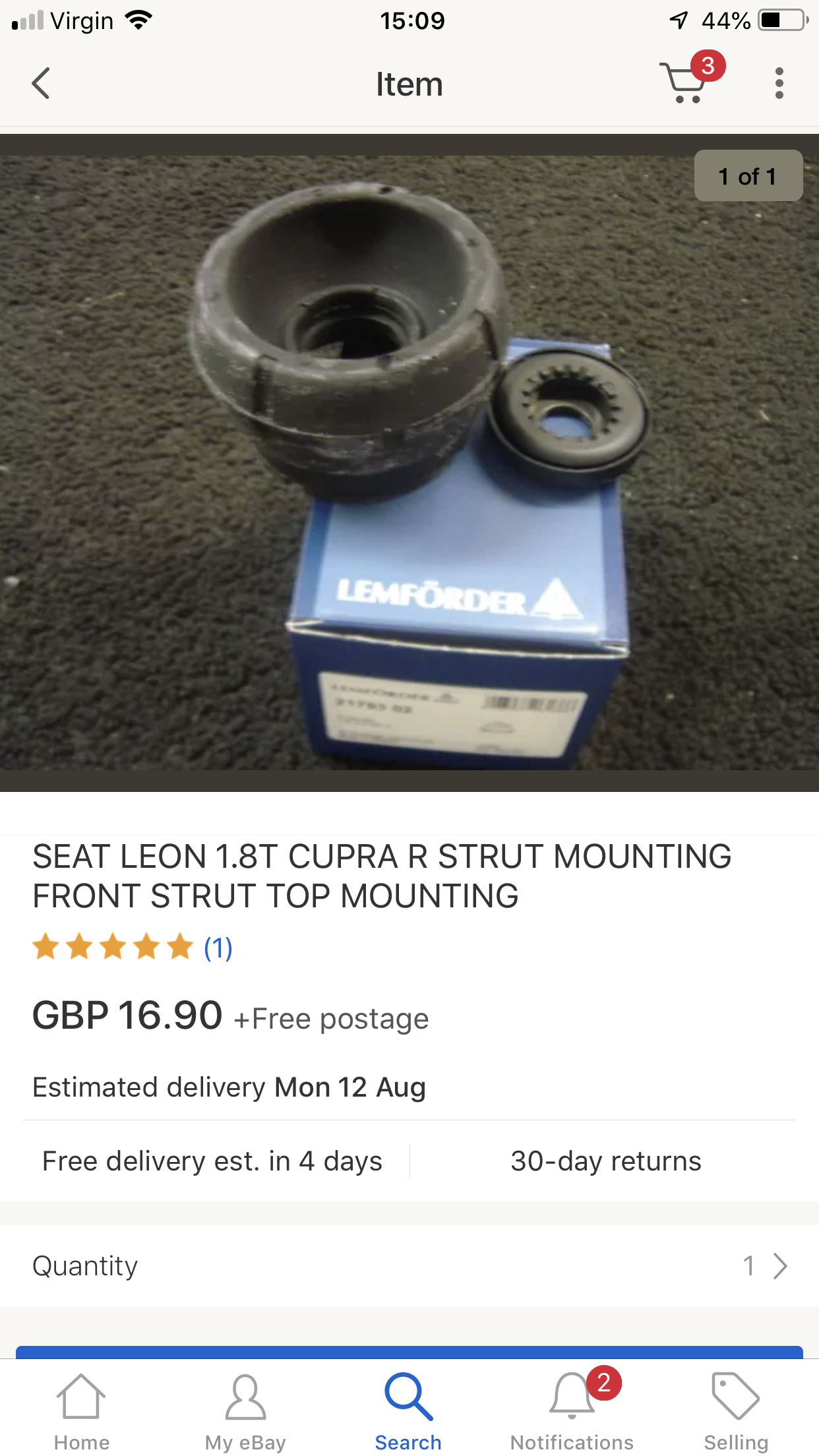

These are the ones I bought from eBay item number 300775732866
imageproxy.php?img=&key=66c1d7df650950daED231786-088F-4A7B-AE51-E9F7E6D2060D.thumb.png.b73174b2896a526e814cefb04067c5dc.png
Thanks mate. Are these also suitable for my Octavia RS?
Yes as the LCR is a 1.8t engine just 225hp.
