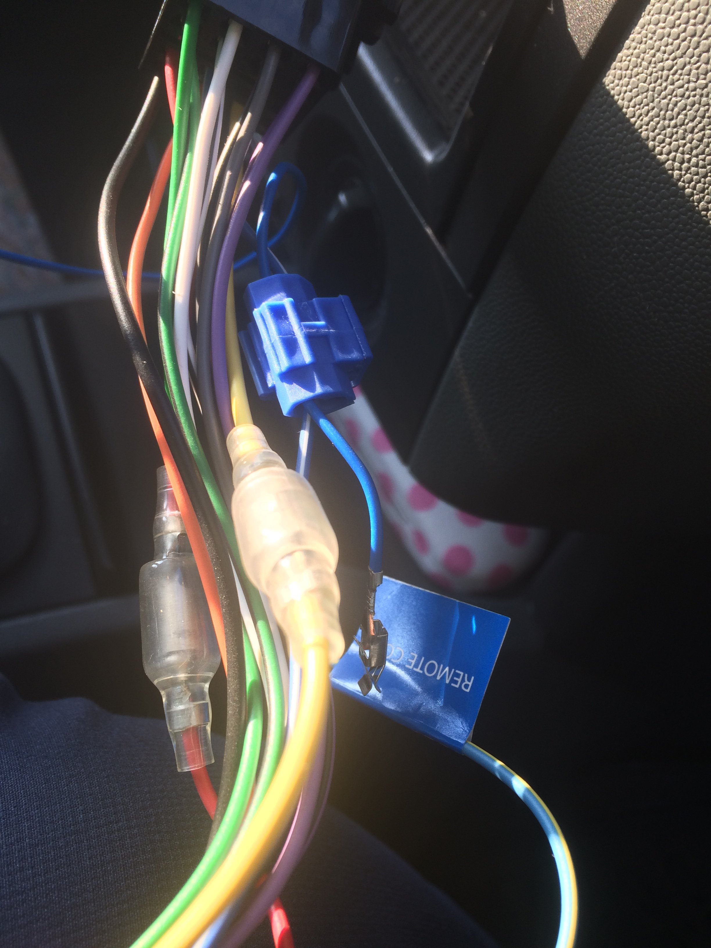

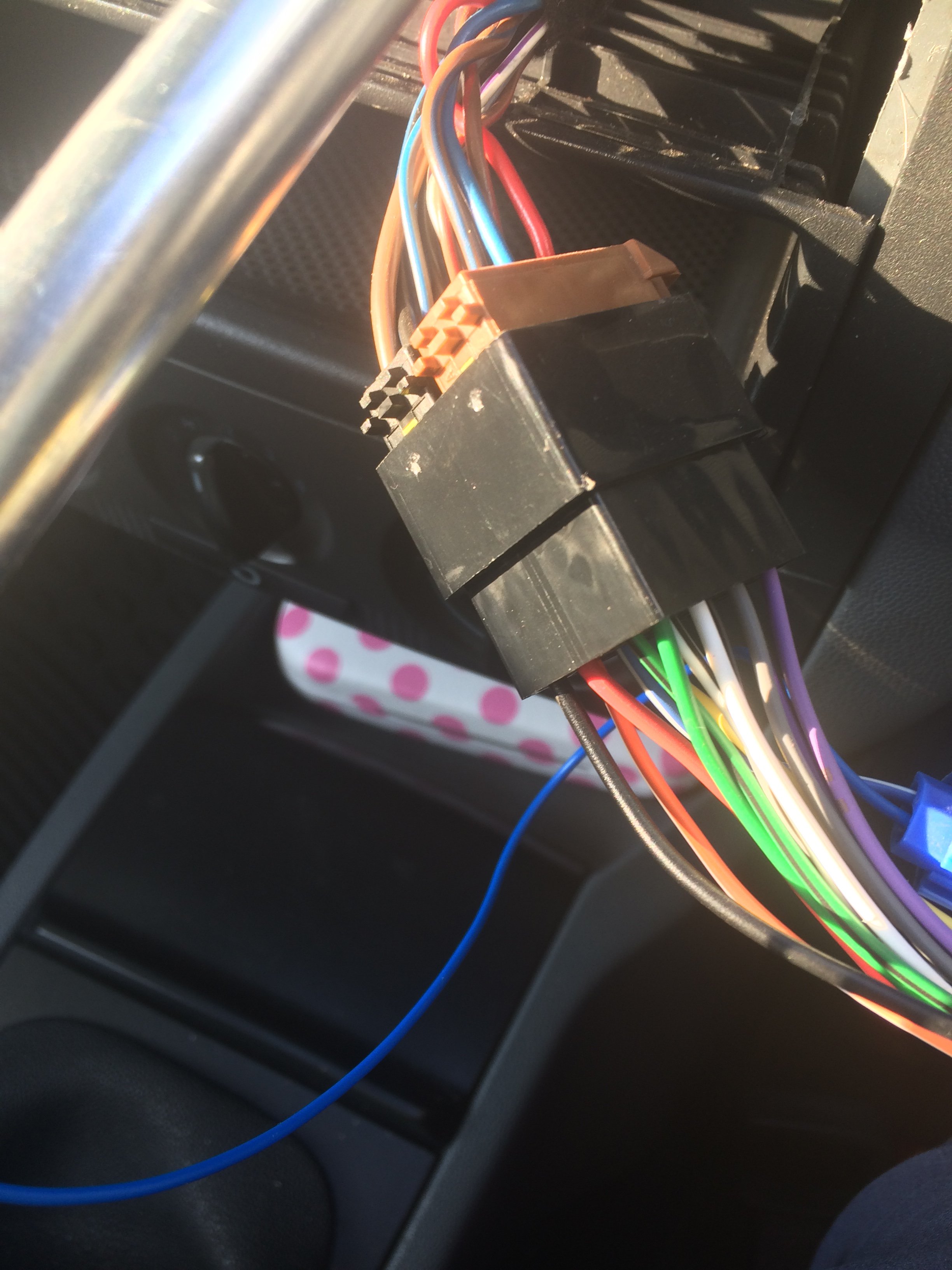

Ok so some photos of my radio wiring.
The blue wire from the signal booster is connected into the blue and white radio wire, which I think from the manual is remote 12v. Anyhow that’s how I interpreted from the manual how it should be installed
