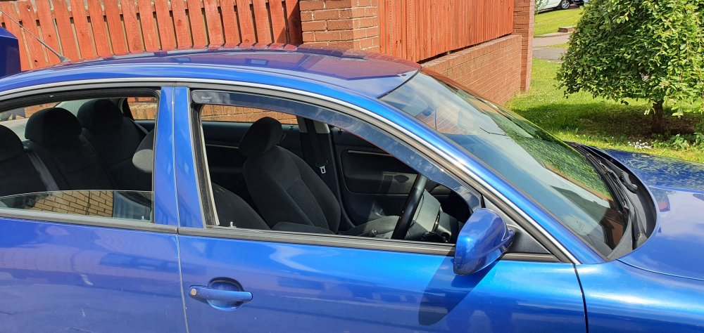

  2. have a look at attached video. its a passat, but its the same procedure for this gen superb. basically, the door lock mechanism and the window regulator come out as a unit, youll need to somehow get the glass out of the window regulator and prepare to remove the door lock mechanism.
  3. the Superb Mk1 (3u) is based on the long wheelbase VW Passat B5.5 (3b4) Some part numbers will be different, but its still a good guide for the general location A quick search actually turns up this video, hopefully it helps

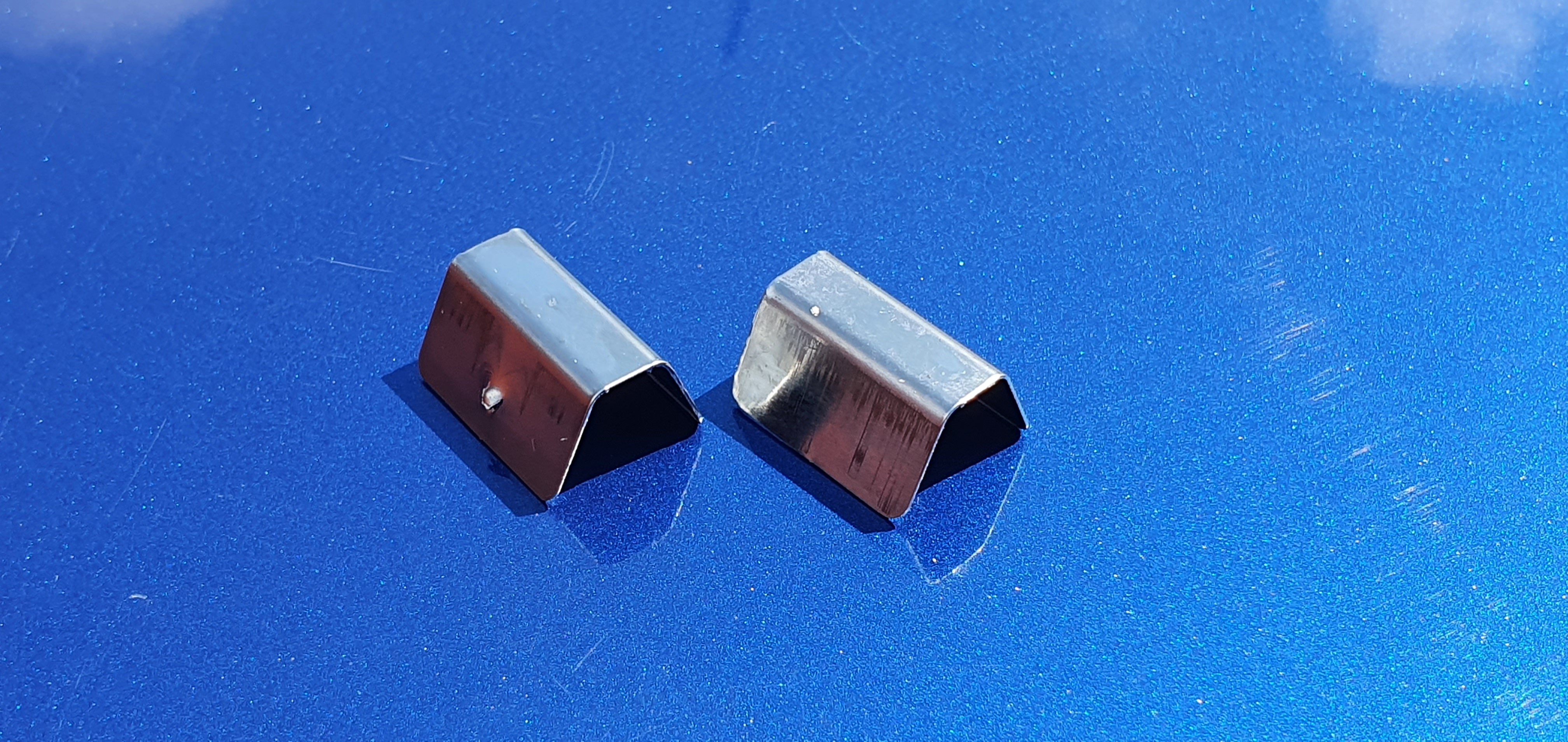

  5. I'm having the same issue. both the bigger bits are broken, in my case probably because I appear to be missing one of the 3 screws holding it on to the door. If your car is LHD, you may find suitable items on ebay, if it's a UK RHD car, you're probably best off to the local skoda dealer. It's where I'll be trying my hand soon.

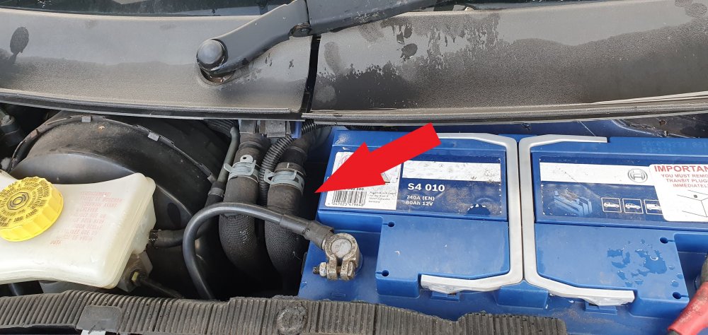

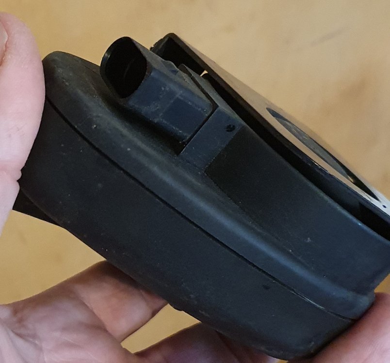

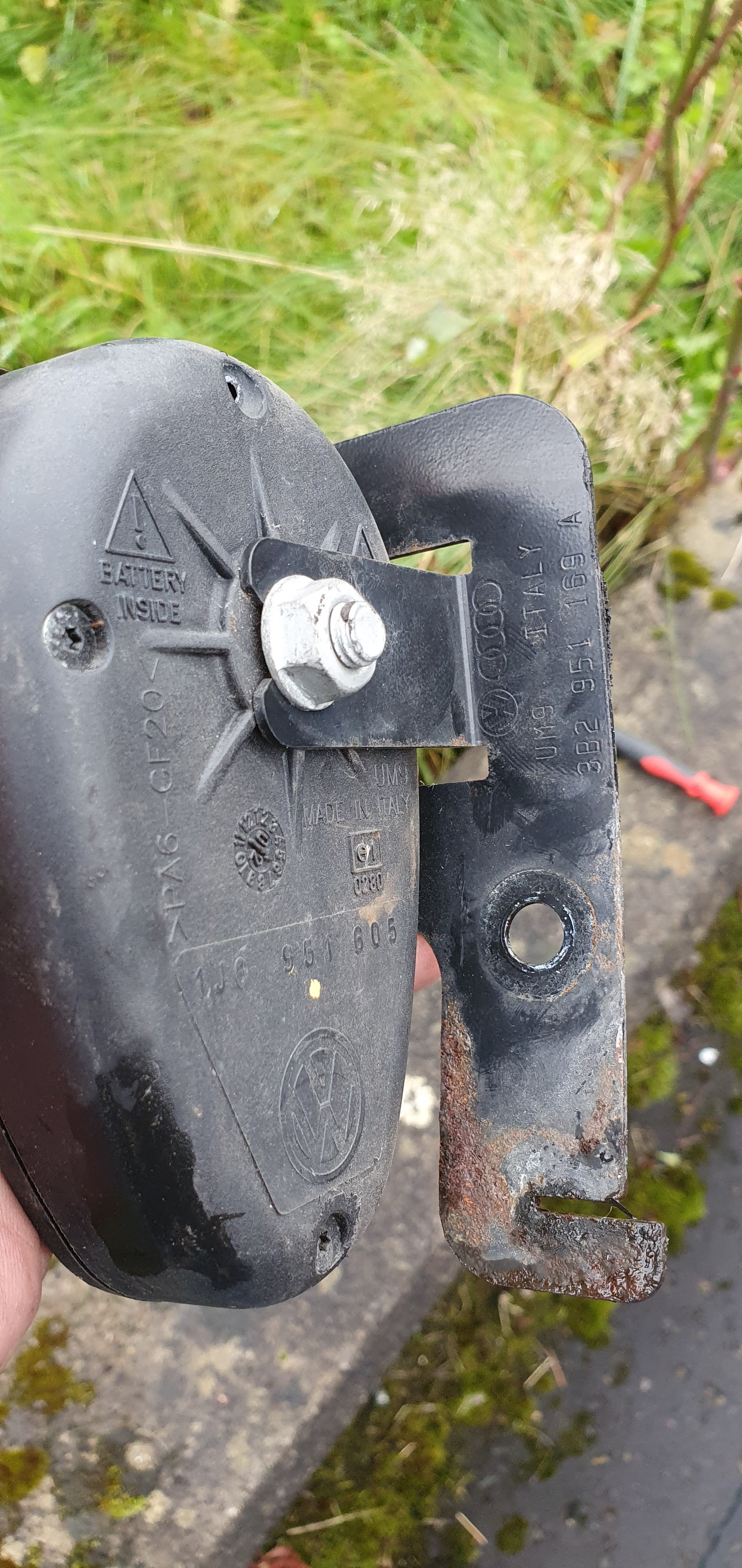

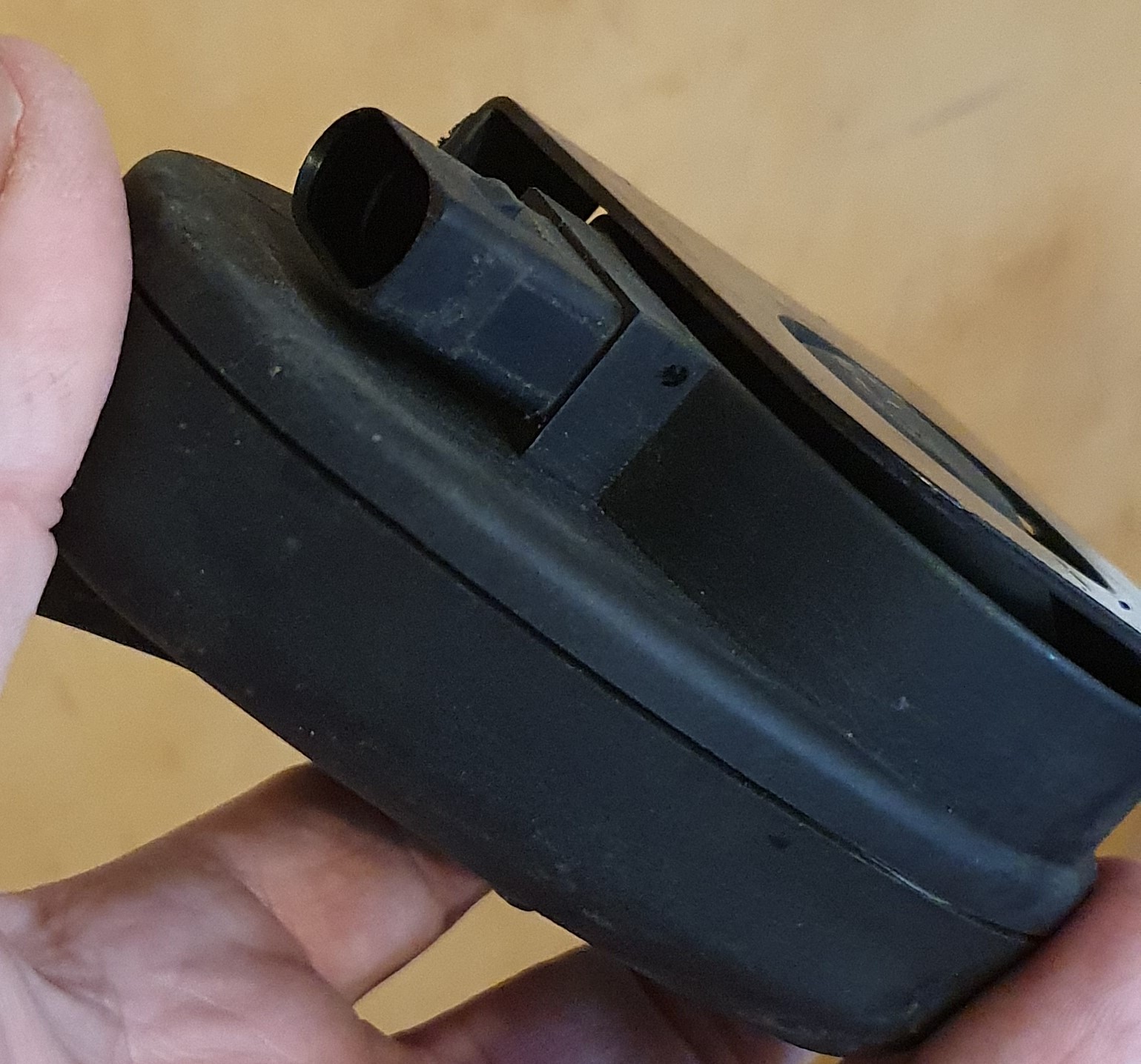

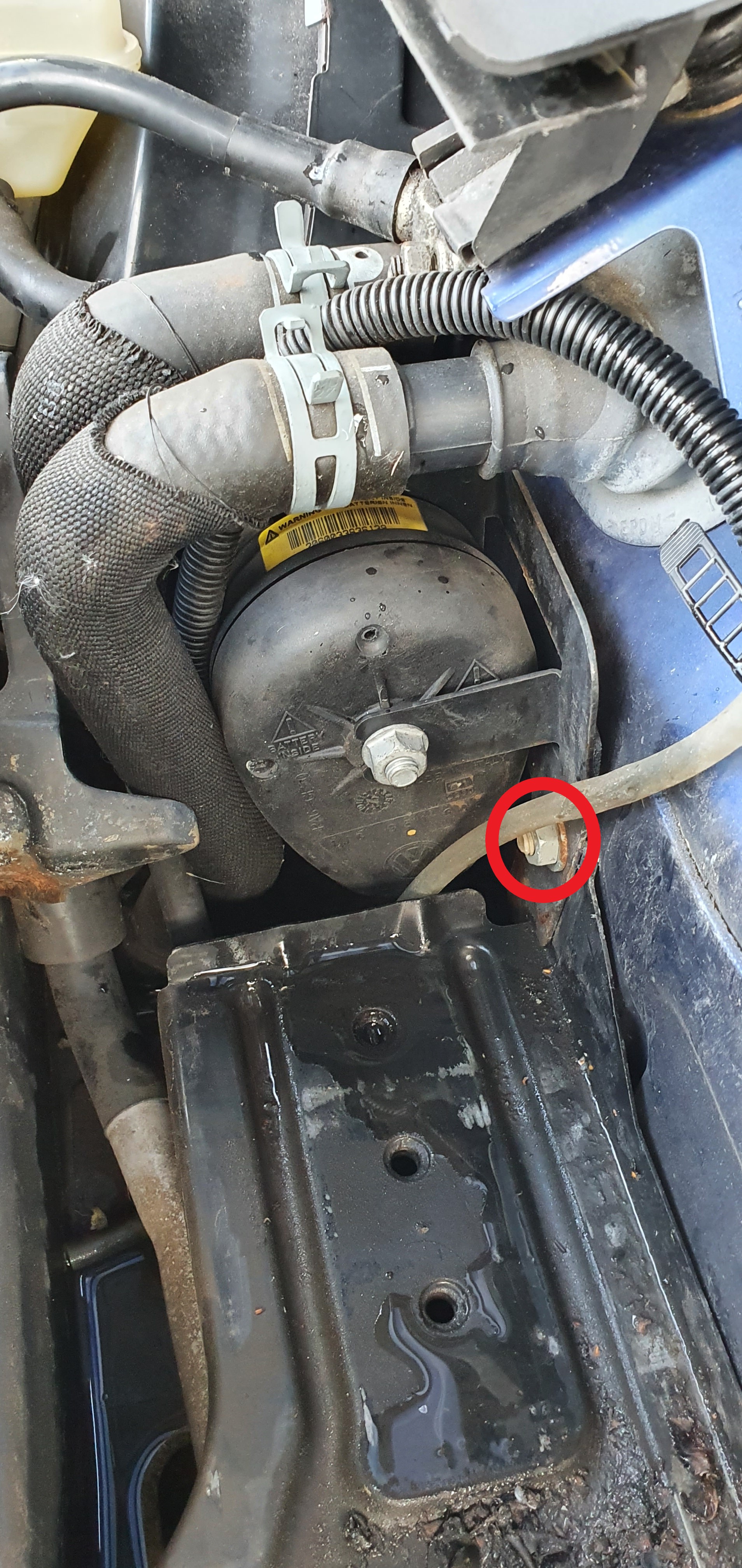

  10. After a call to the nearby skoda dealer I've found the alarm siren. Turns out it is located in the plenum chamber, wedged between the battery and the brake servo. (I have also finally ordered a new scuttle panel as I was on the phone to them anyway, meant to do that for ages) (Pics are of an RHD model, LHD models will be mirrored here) Removal necessitates removal of battery first. Once the battery is out, undo the nut circled in red, preferably without dropping it. The nut has a captive washer. Once this nut is loose, wiggle the unit as a whole out. It has a lip at the bottom which catches on the battery tray for security, so you'll need to pull and twist at the same time until it comes out. Once it is free, you can undo the plug which is located on the side facing the brake servo, with the plug facing straight down. Et voila, it is removed. Currently the battery is on the charger. I will reinstall it later and see how much it has deteriorated before trying to get it replaced under warranty.
