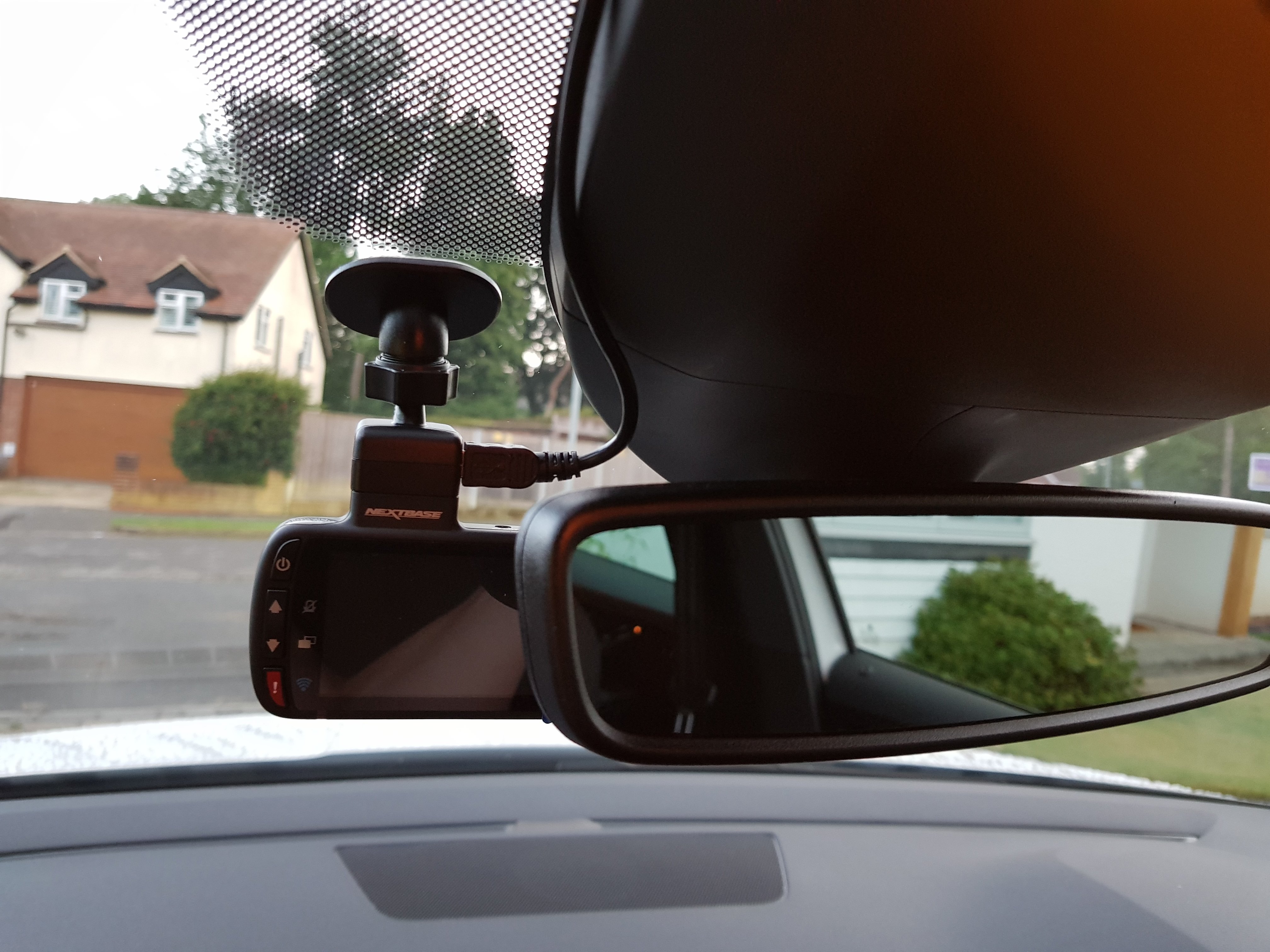

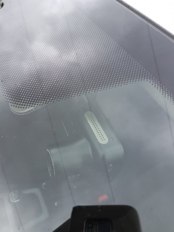

Hi Jeff, I have just had a 322GW dash Cam fitted by Mitchell's of Chester.  They installed it just to the left of and just below the rear view mirror (The sticky pad is just on the black 'spotted' area.  This was as per the fitting instructions and does not interfere with any sensors on the mirror.
Cheers, Alan
I just picked up my 245 '19 plate which has a Nextbase camera fitted, although its a 312 or something.  Per Alan Osborne I have now moved my from the suction cup on the screen to use the sticky pad on the black dotted area.  It now hides behind the rear view mirror.  I have played with my cabling a bit to tidy it up.  There is a really good youtube video.  Hope this works.....

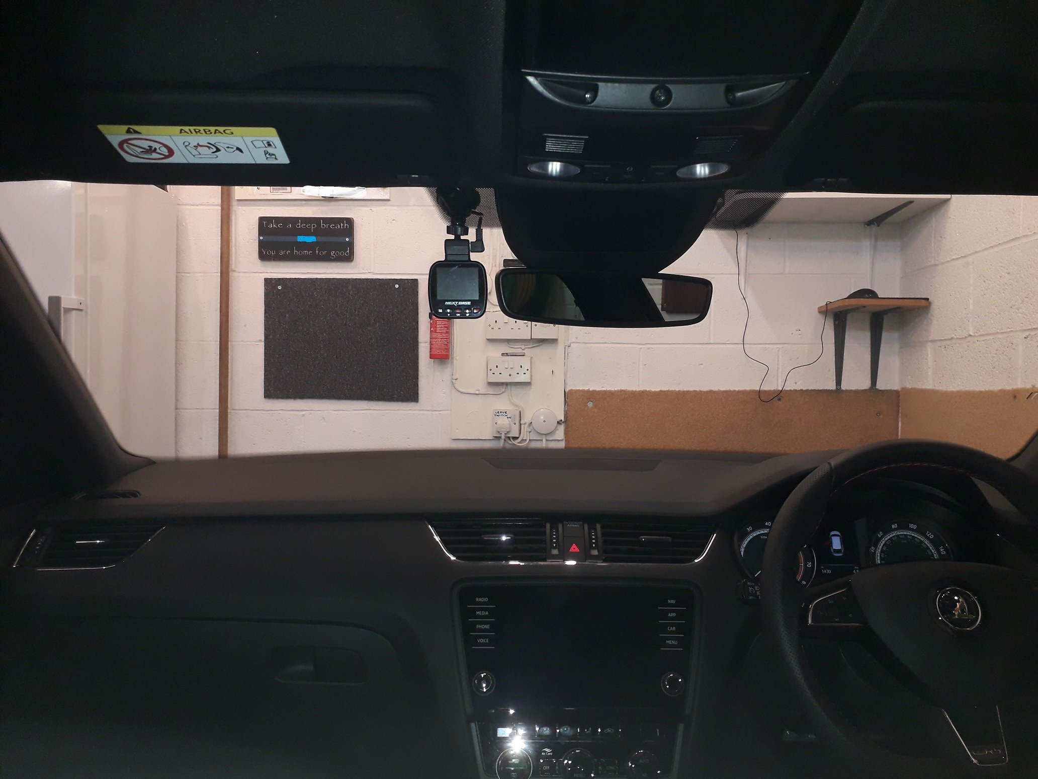

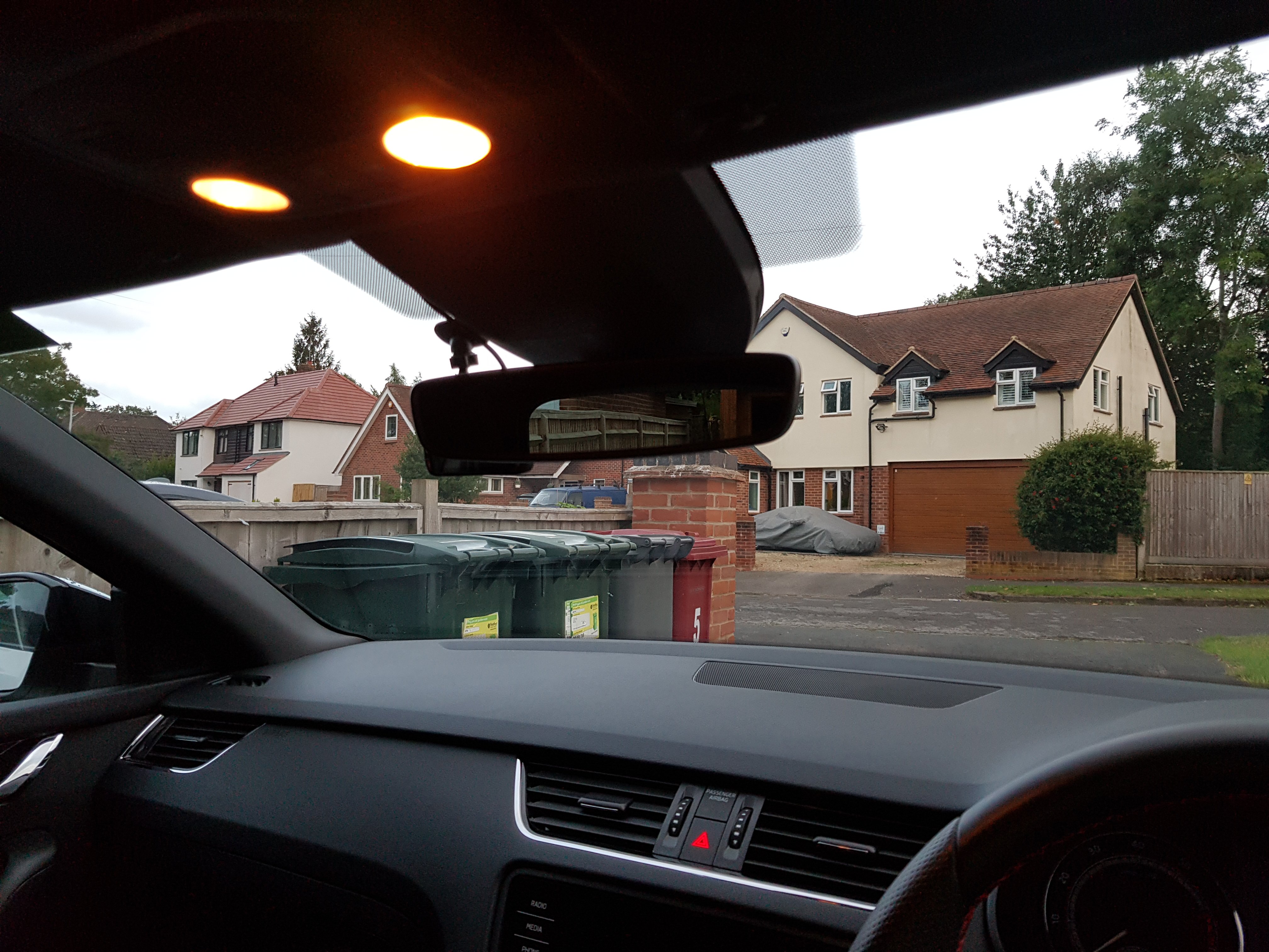

I have the lane camera too. Mounted it underneath.....

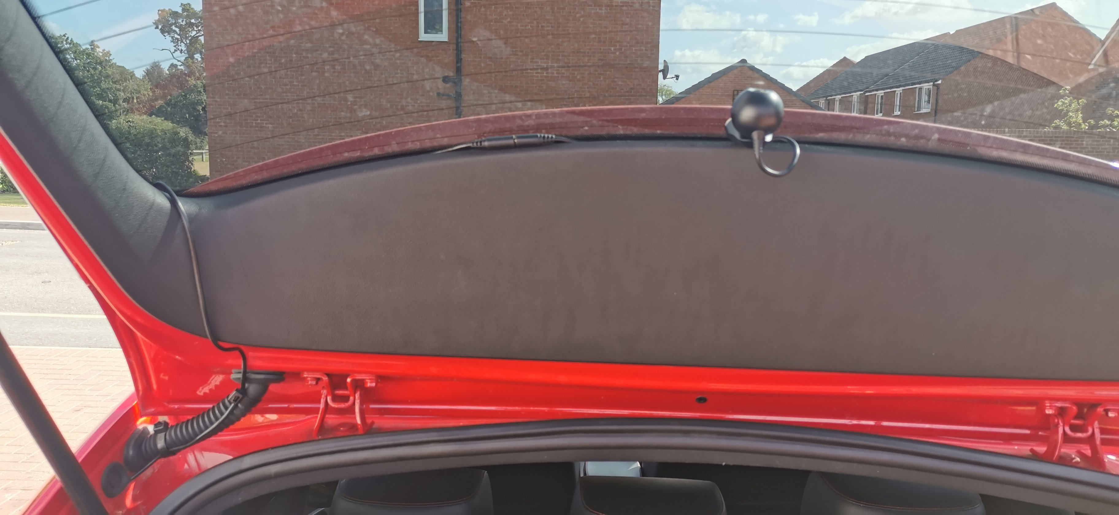

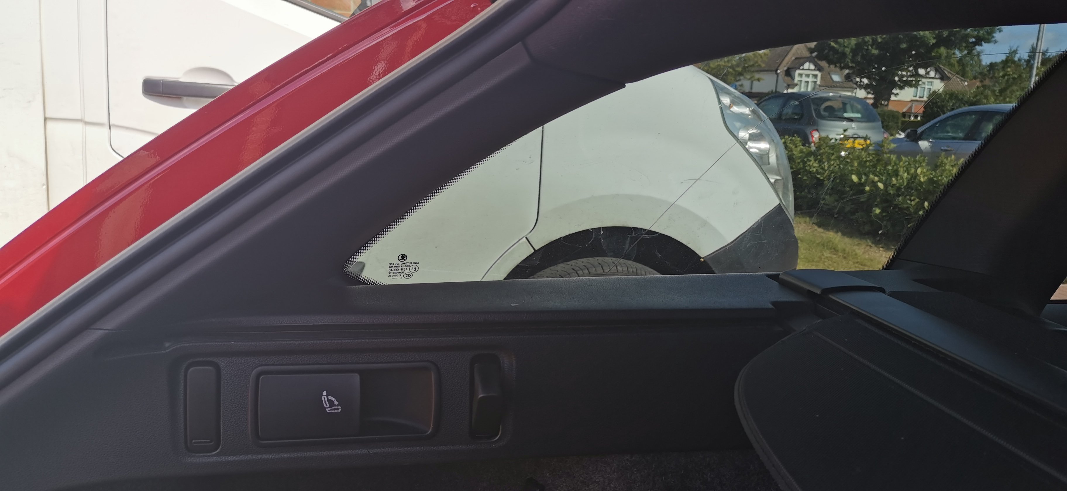

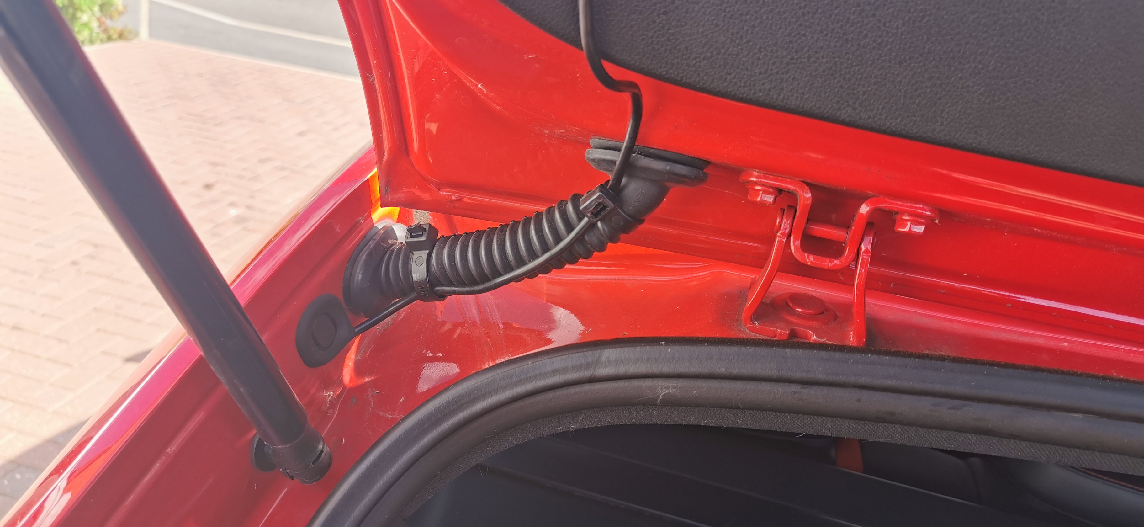

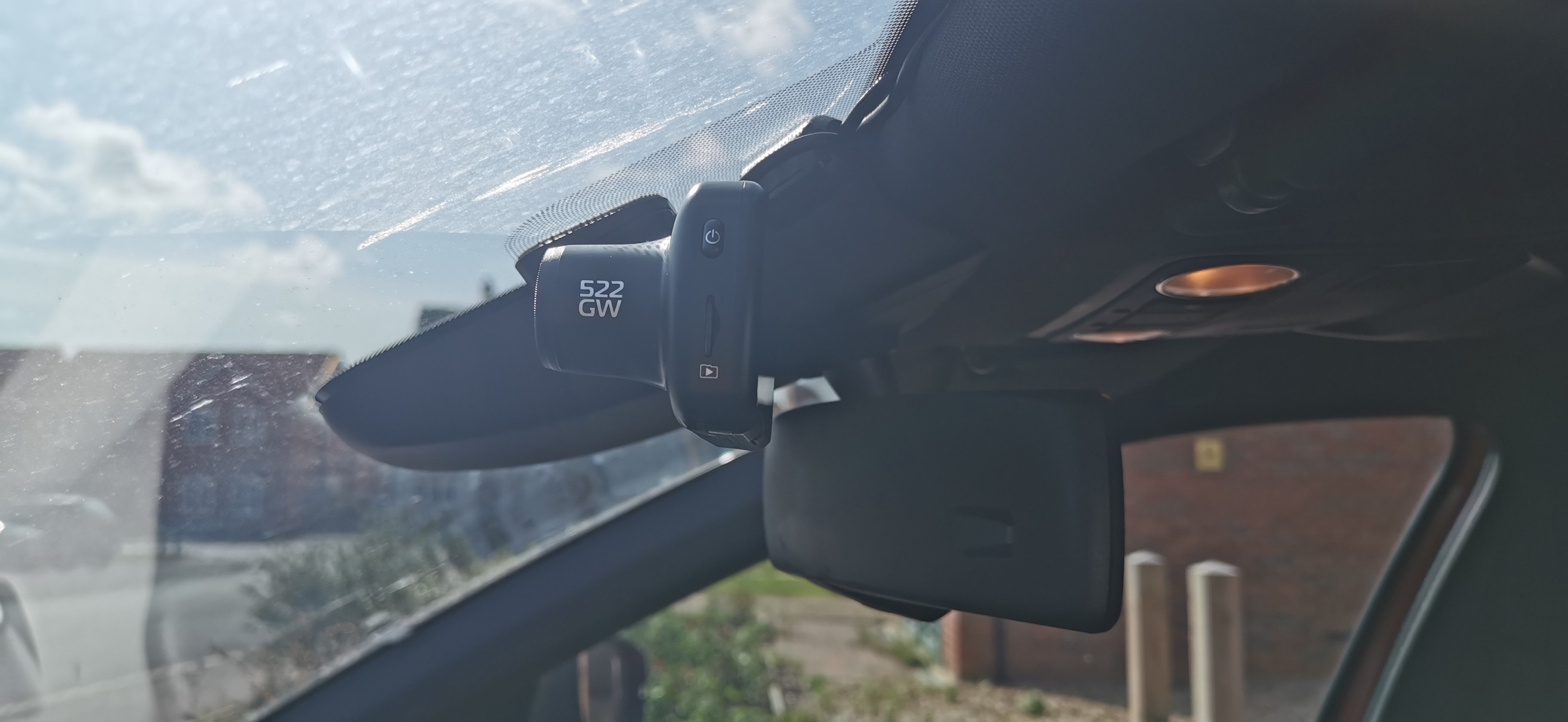

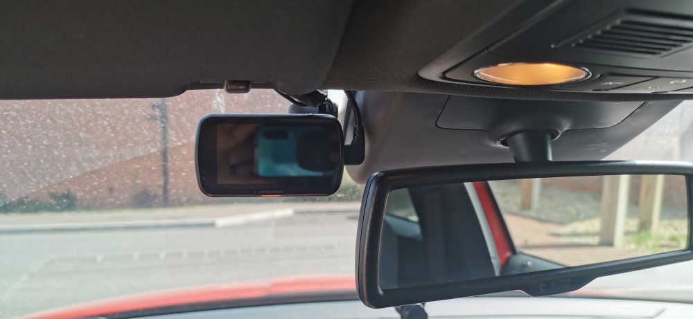

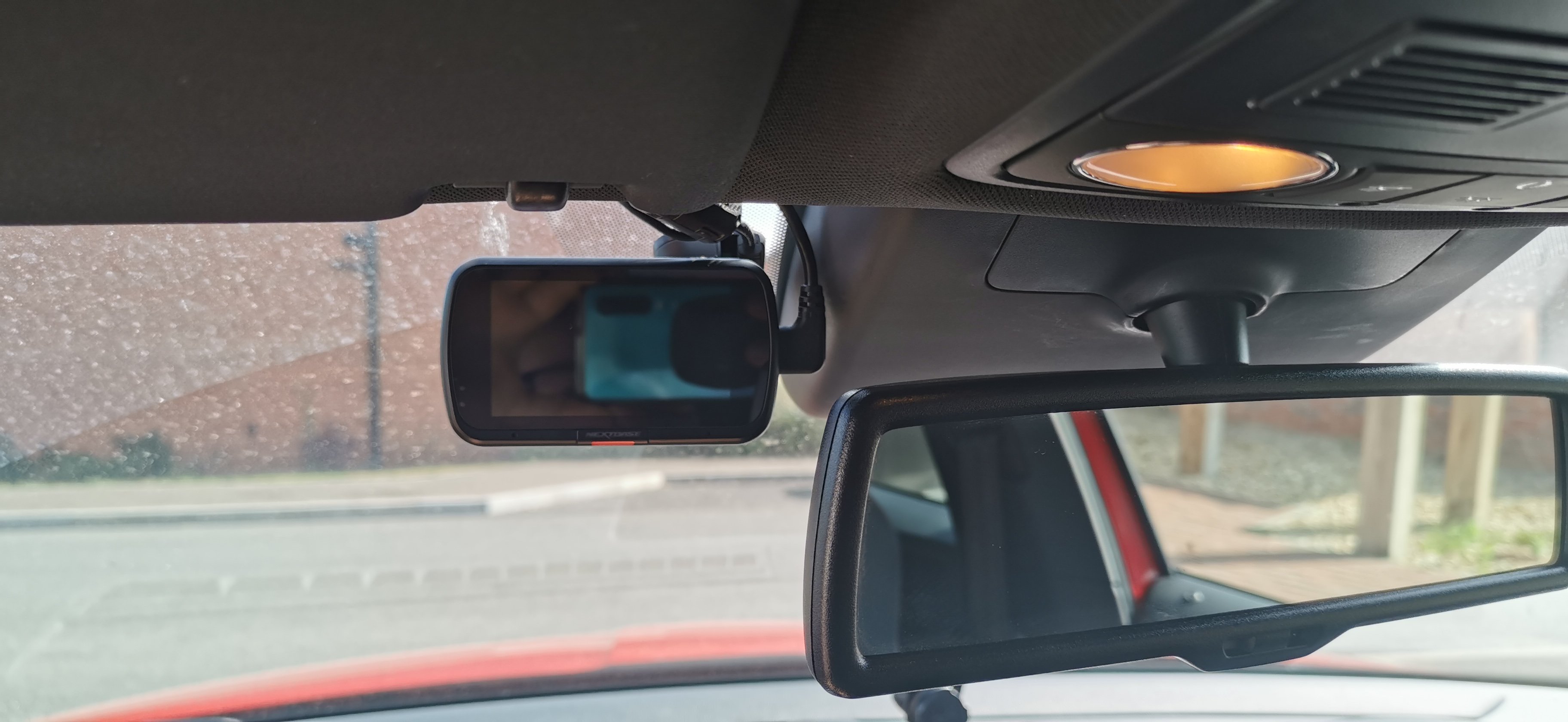

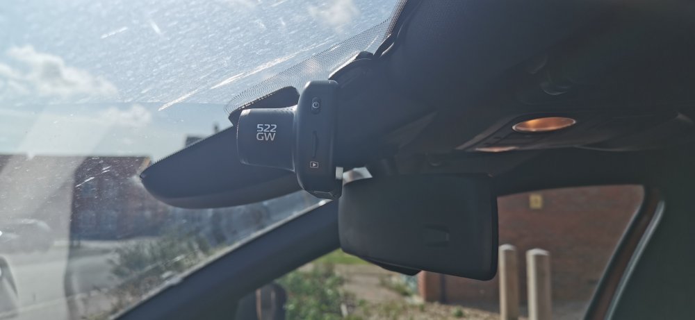

I recently fitted a 522gw and matching rear camera to my VRS Estate. I bought the hardwiring kit and rear camera from Halfords (on an offer and with a discount code) and installed it all myself in a couple of hours. I used fuse 48 (I'm 99% sure) as I found that to be switched on/off by the ignition and using a cheap plastic trim removal kit from Amazon, routed it up the side pillar and across the top of the windscreen.

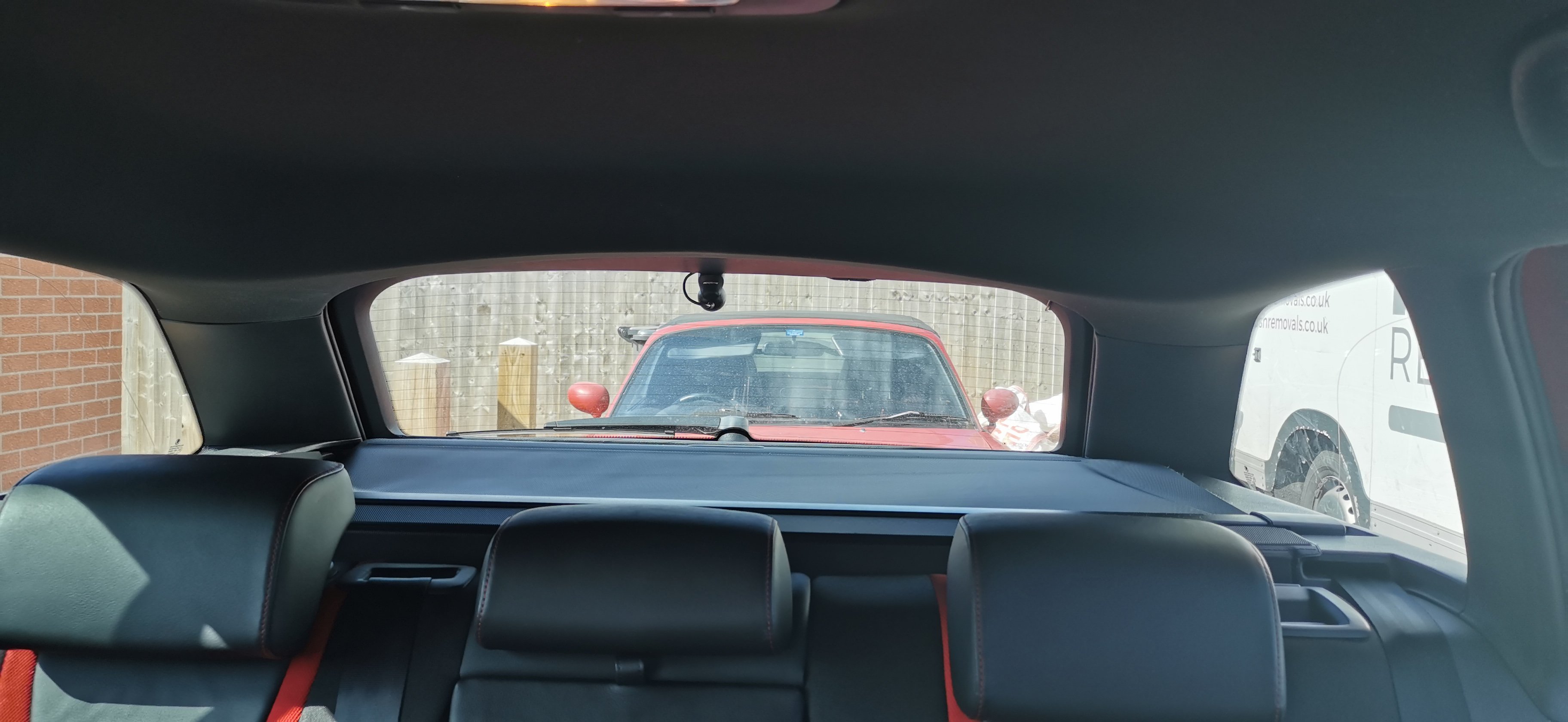

I also installed the rear-view camera so routed the HDMI cable at the same time - this was slightly more complicated as I had to remove some trim at the back of the boot with the trim removal tools and then 4x T20 Torx screws to be able to fish the cable up that A-Pillar and through the grommet to the roof. I ran the cable behind the seat release buttons, that whole trim comes off with those Torx screws. I've attached photos to give you a bit of an idea of where I ran the cable. I used some spare 2mm cable to fish the HDMI cable up through that rear pillar and through the grommet which worked a treat. After that, it's just tidying up any excess and the viewing angle of the camera. Thankfully the boot on the Octy is big enough as I sat in there for a good chunk of the installation!
@davalarr Thanks for the post.
Does the camera restrict the movement of the sun visor?
No problem. Not at all, I think it looks a lot closer than it actually is - check image no. 1 and you'll see it's actually a couple of inches forward of the visor hinges.
