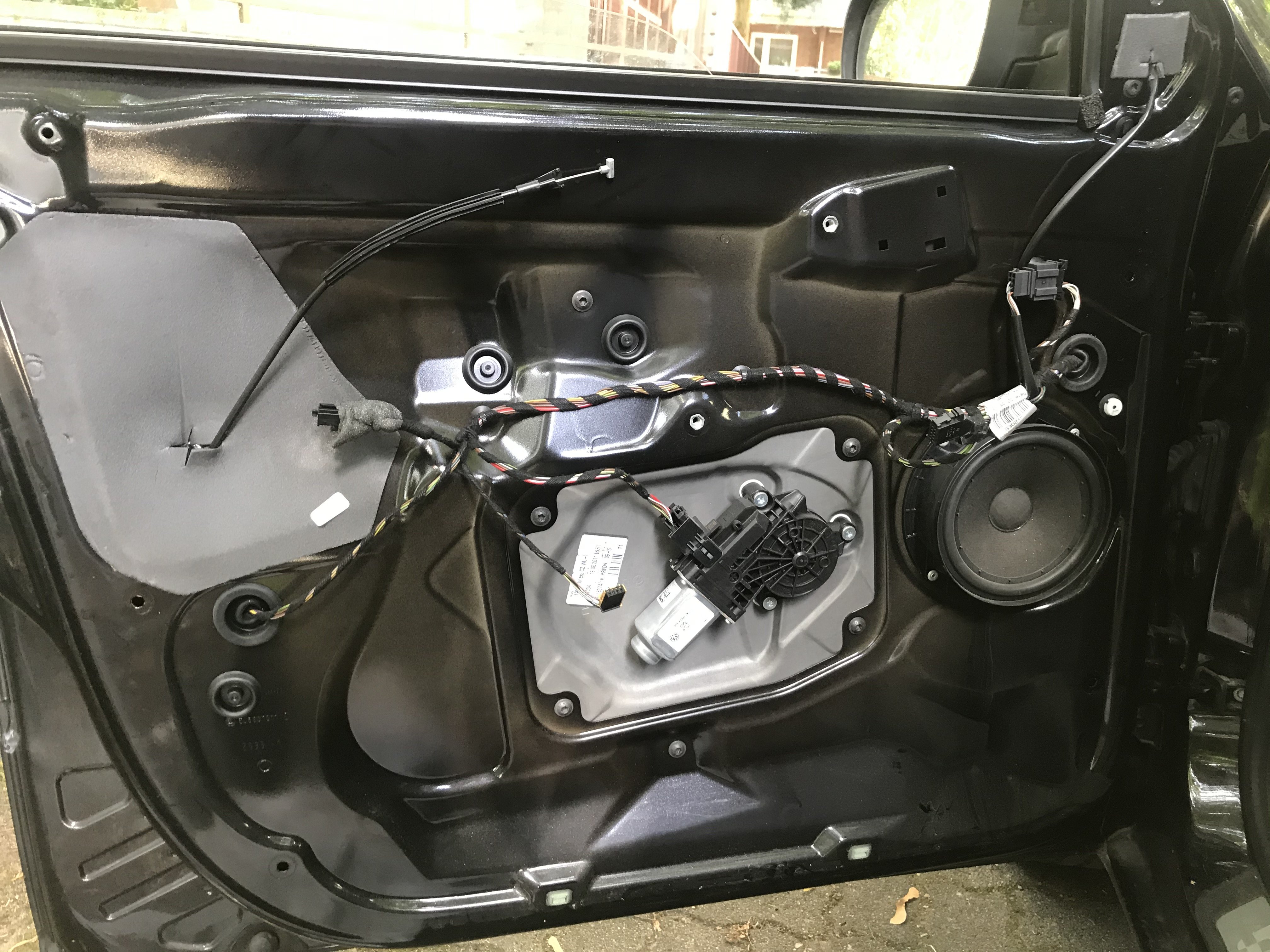

Image 1 - panelling came off and as you said, its just a Torx to get the regulator out. Nuts were too tight for me, however, and that probably bought me to look for other solutions.

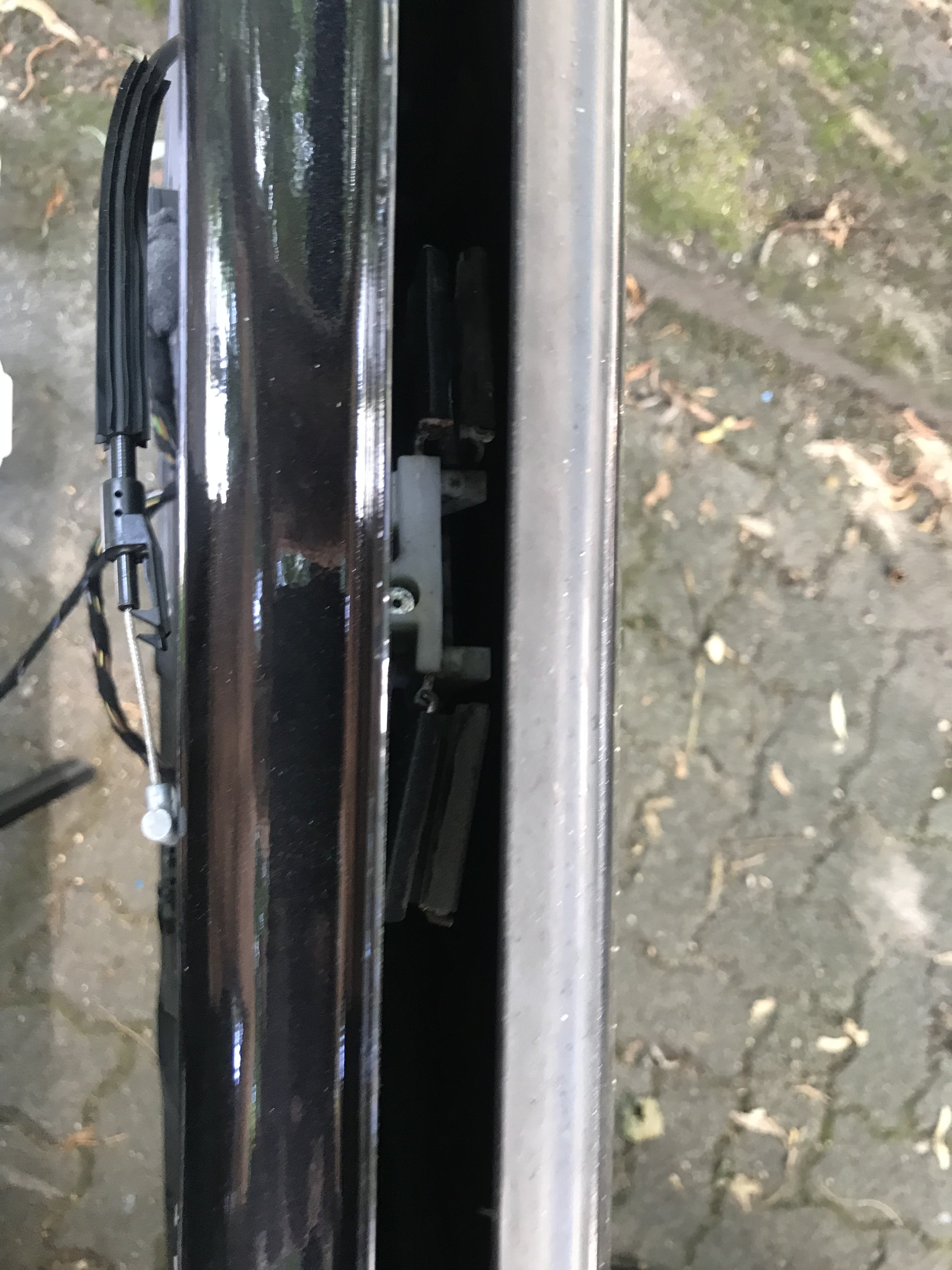

Image 2:  I looked into the door cavity and could see the bracket moving when I connected the power for the switch and paddled it up and down. Was then obvious to me how the mechanism worked, and that the window had simply pulled out of the bracket, probably due to the window being super sticky.

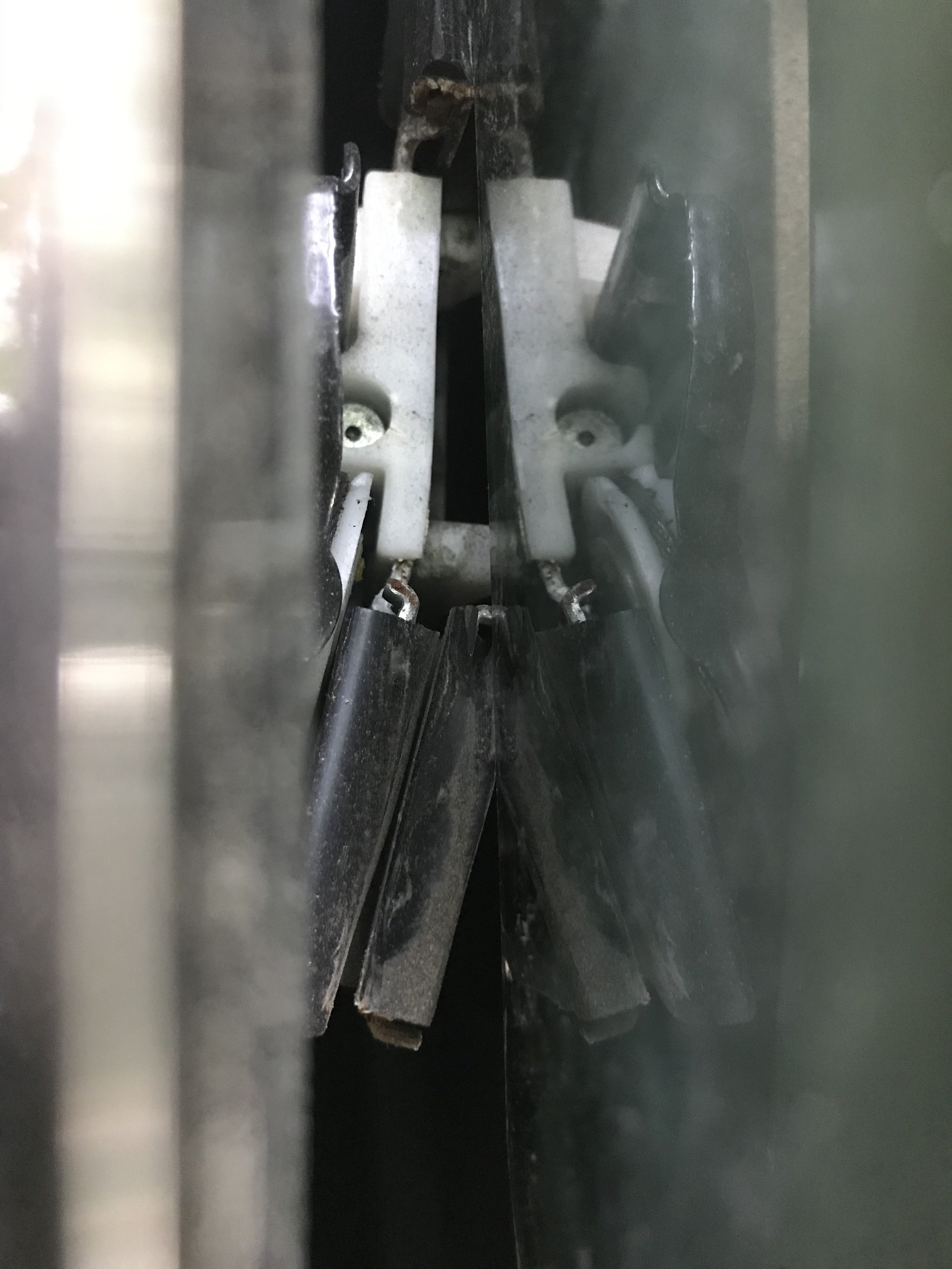

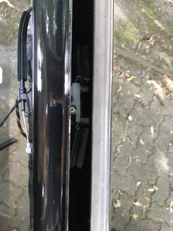

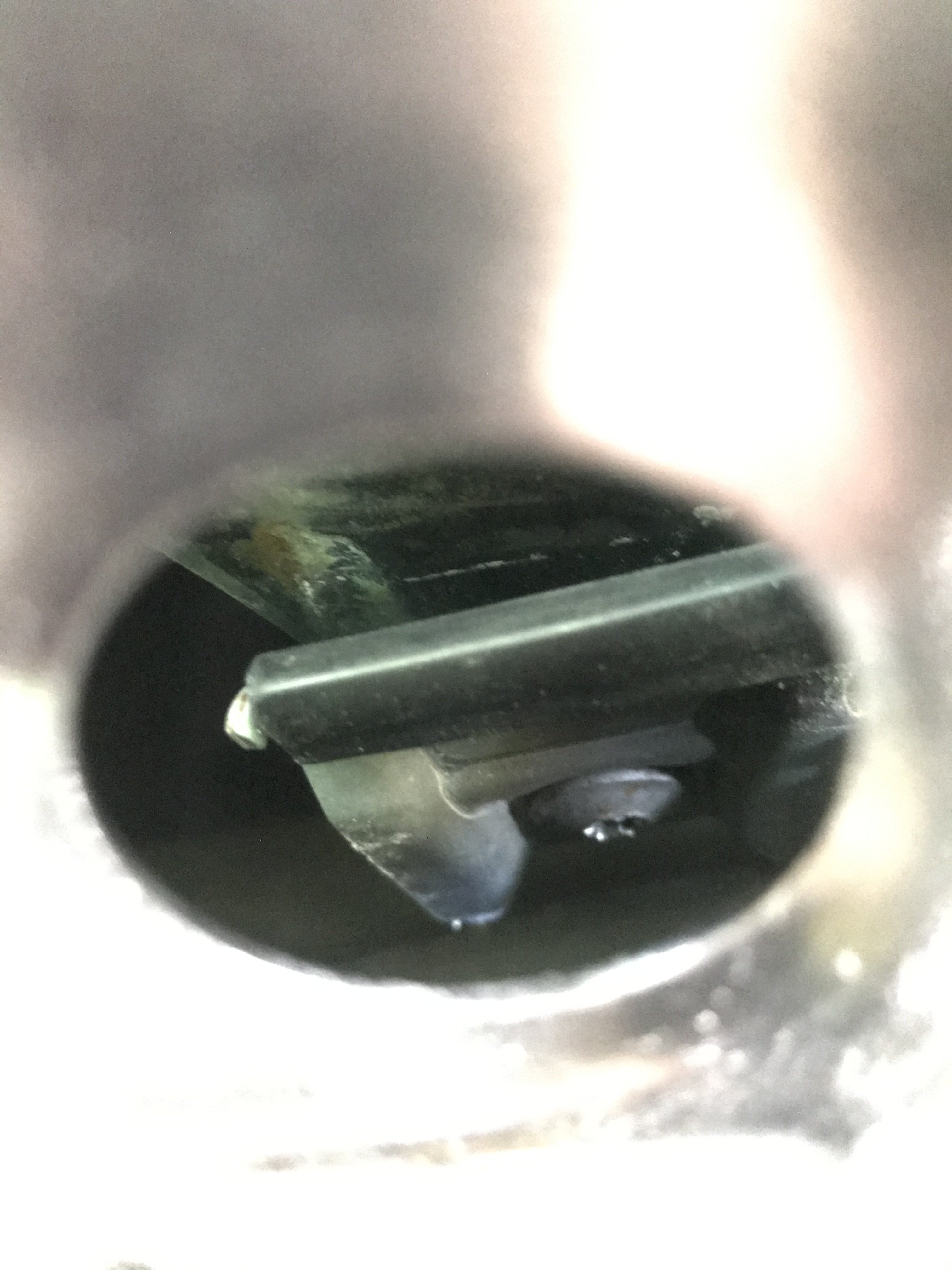

Image 3 - The bracket was on a bend, and the clips were really tight together. This is where I was pulling my hair out - how to fit the window back in. I then remembered a video I had seen on youtube, and removed those two black bungs that you can see just above the regulator in Image 1. I could then see, when aligned, two screws that I could loosen to fit the window back in. It took a fair bit of work to get to this stage in just thinking logically through the problem, but then after a bit of pressing and pushing, the window sat in there nice and snug.
Image 4 - The only problem I have now is that on one of the clips, the tightening nut has become unattached from the rear side of the clip, and I can't get enough pressure on it to fit it back on. So it looks like next time the window pops out (if), I'll need to go back in and try and fix that nut. Currently its secured only by one side - perhaps it is in fact better to go in and tighten it in case it comes off and falls down/smashes?
