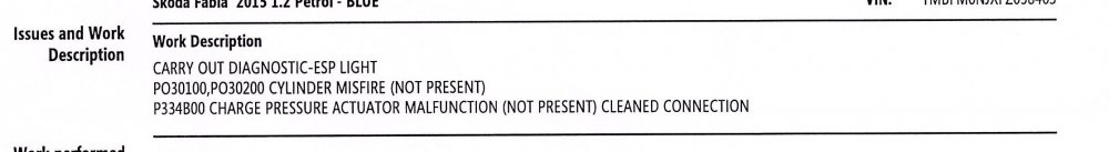

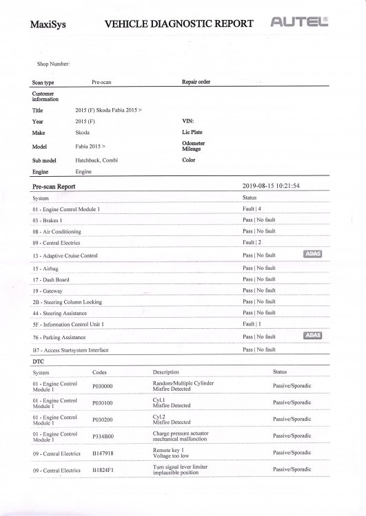

Update car has been to garage for a diagnostic report attached I hope the pre-scan report and work done. Car has been running normally since the last time the EPC
ight came on no faults were found while the car was in the garage
l.img001.thumb.jpg.e314b86c544dfc95f0d6280feaa47f1a.jpg839529783_Diagnosticrepair3.thumb.jpg.23a6f19f81140a9b675475985c51f010.jpg
