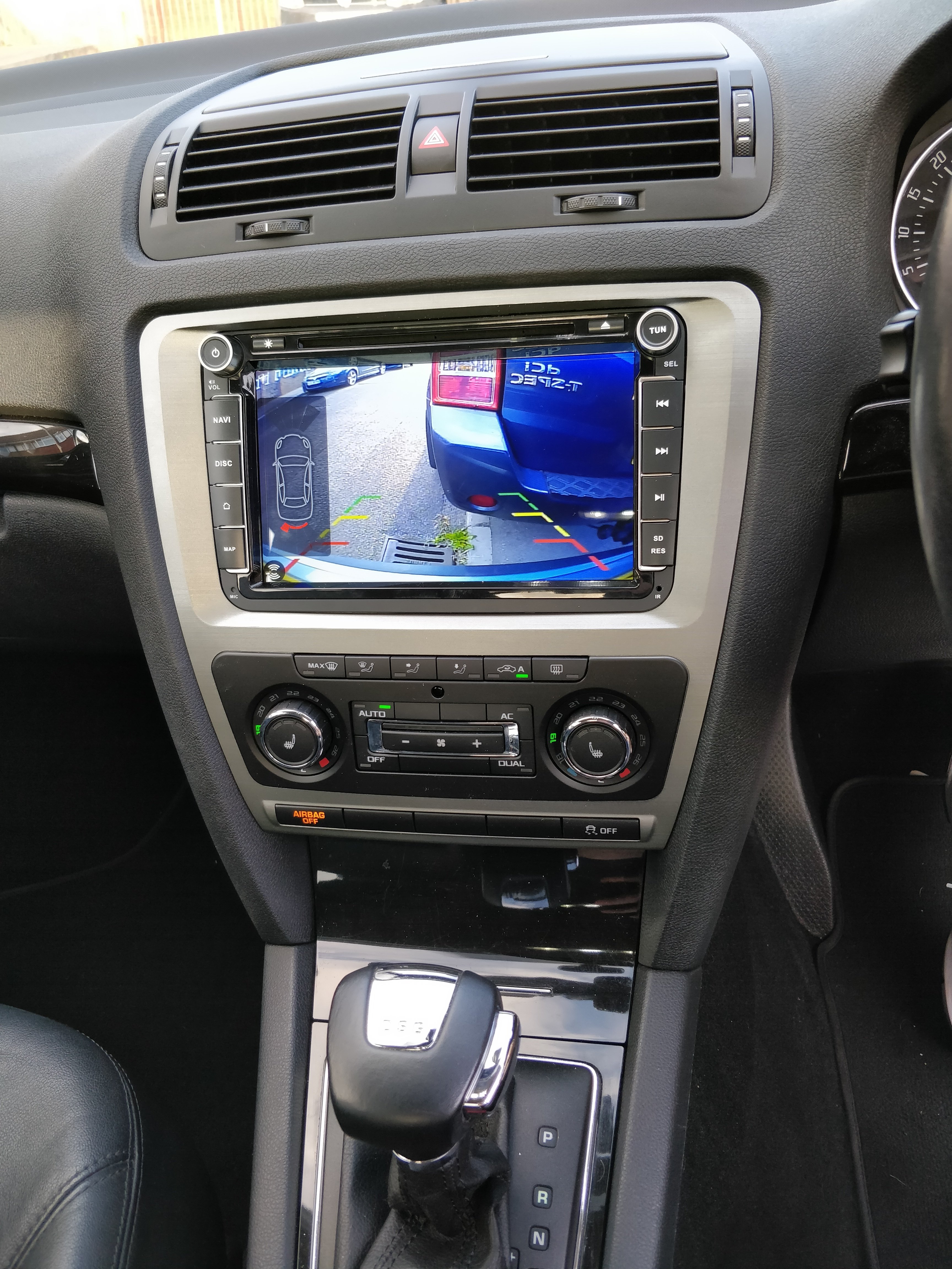

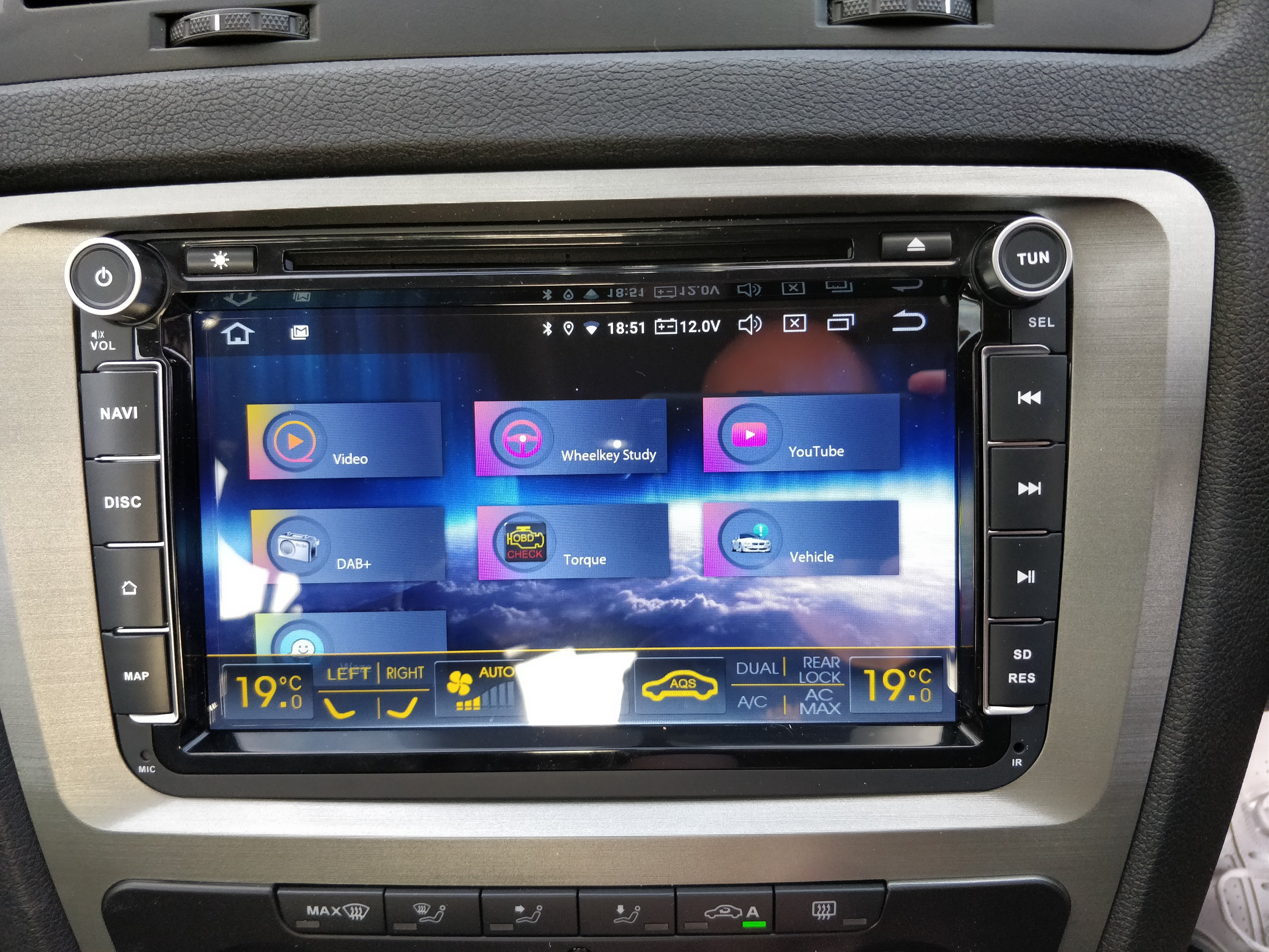

I fitted an xtrons unit to my car at the weekend, very happy with the result so far!

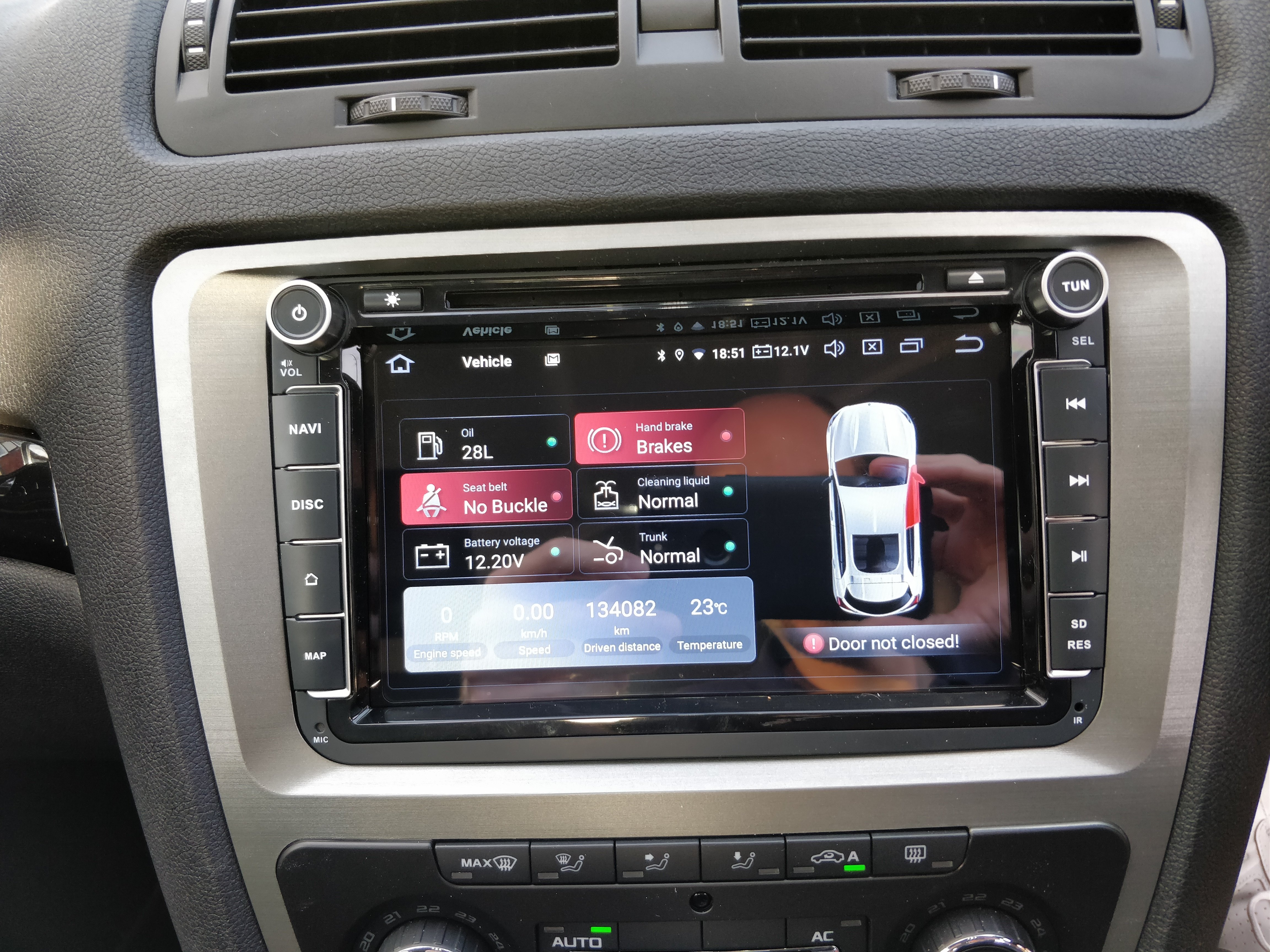

I went for this one. It's the newest processor (px6) with 4gb of RAM, so it should perform well for the future. Delivery from Hong Kong took 6 days, no customs issues or anything.
Fitted a reverse camera at the same time, which integrates quite nicely. Radio reception is good, Google maps works nicely even offline (after I downloaded the map for the local area).

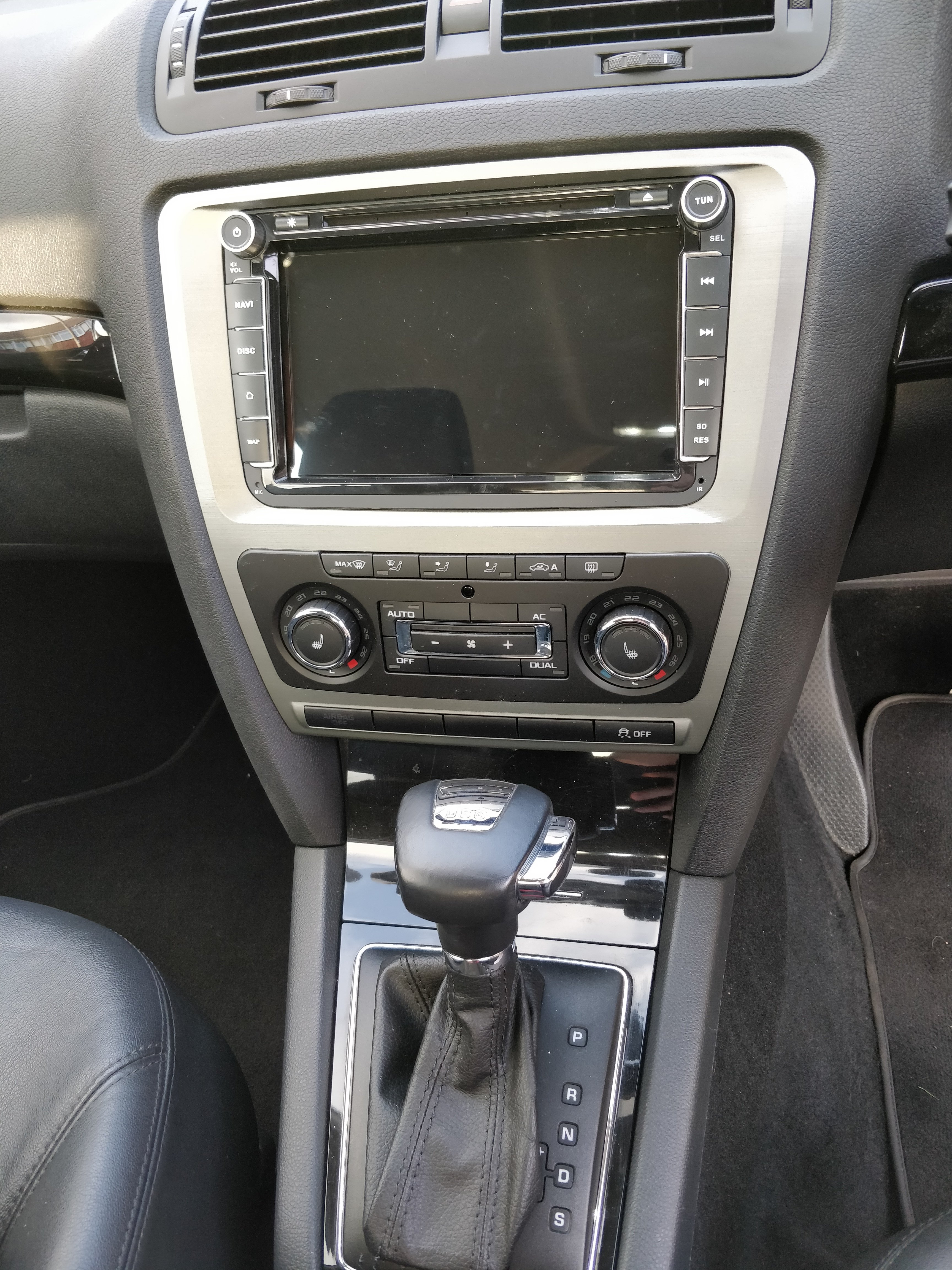

Wow, that's a nice bit of kit. Does it replace the Bolero system without the need of a fascia adaptor? I like the idea of a reversing camera too, I've seen ones that come in a little unit that replace one of the number plate lamps and look pretty much OEM.
It isn't direct fit for the bolero, it needs the fascia for the Columbus type, I picked up a cheap one off of eBay for £15. I had to do a minor bit of fettling to the new surround as it was fouling the heated rear screen button, but 5 minutes with a craft knife, file and sandpaper and you'd never know. Looks pretty good, but I reckon I'll eventually buy the genuine fascia as I'm supposed to have the piano black interior and the cheapy fascias are all in silver!

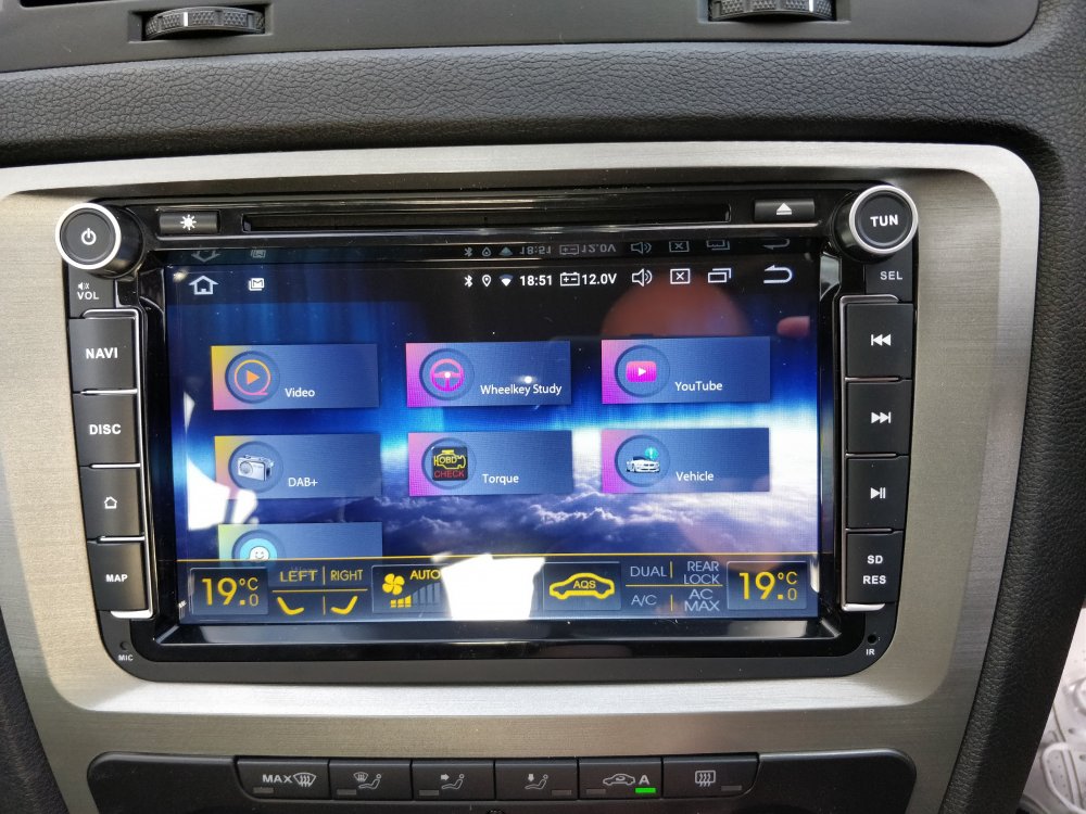

My Xtrons comes with an equaliser built in so you can adjust the sound more to your liking, which was nice.
