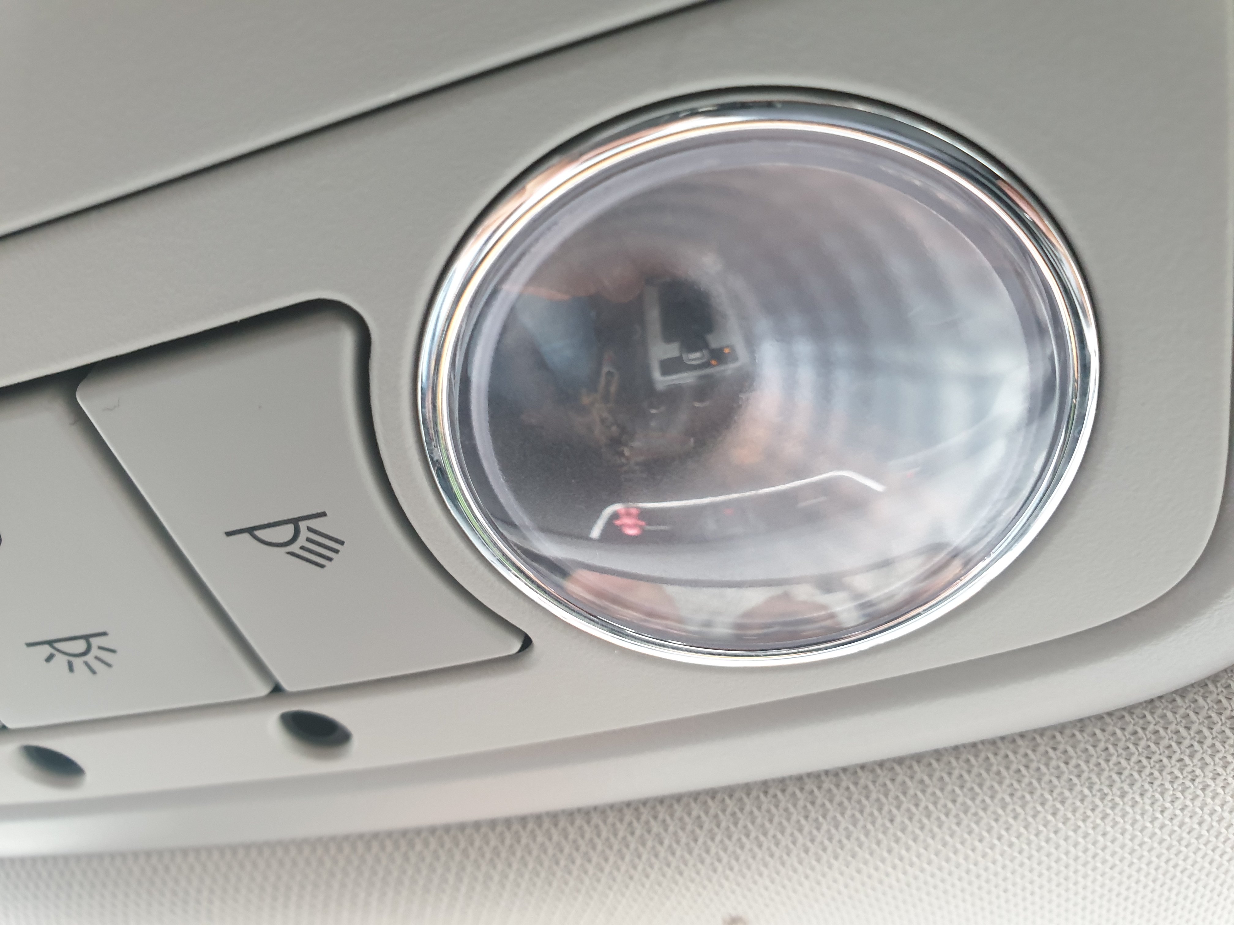

Hi all, how do I open these, theres a dead fly in one of them 😂.
This worked for me when replacing the bulbs. Turn the middle switch in and use a credit card or screwdriver (wrap it in kitchen roll so as not to leave a dent) to slowly pop the cover. When a bit comes off, gently run your fingers around the middle and pop the rest off. It's easy enough.
There is a YouTube video of someone doing it with the method described above.
Thanks, fly has been evicted. 👍
