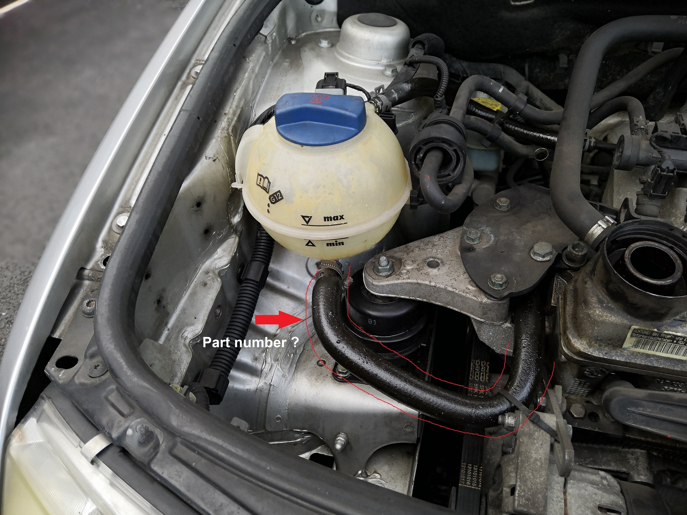

I wonder if someone can help me find a part number to replace a damaged coolant hose pipe.
Unfortunately the one in the car doesnt appear to have any part number (due to the age, its worn away).
I've been searching the internet to find something similar which proved to be difficult.
I would appreciate if someone could point me in the right direction to find a replacement part.
Skoda Fabia 1.4 mpi 2002.

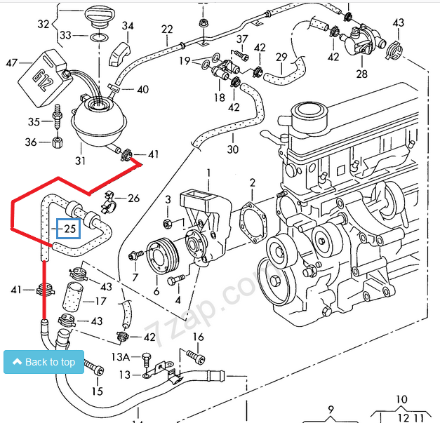

I have outlined the part in red.
See attached picture.
Part number 6Y0 121 109 G
The other part number afterwards is just a plastic clip (item 26).
