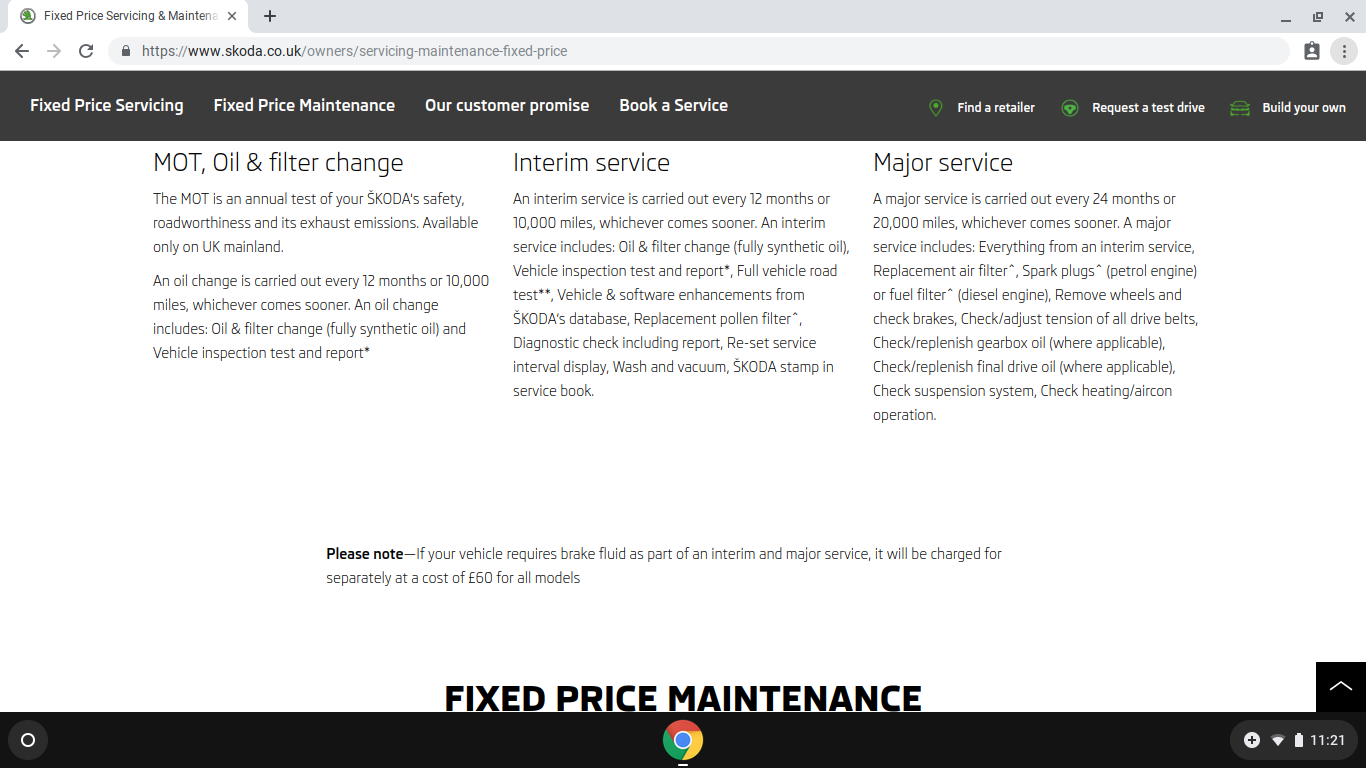

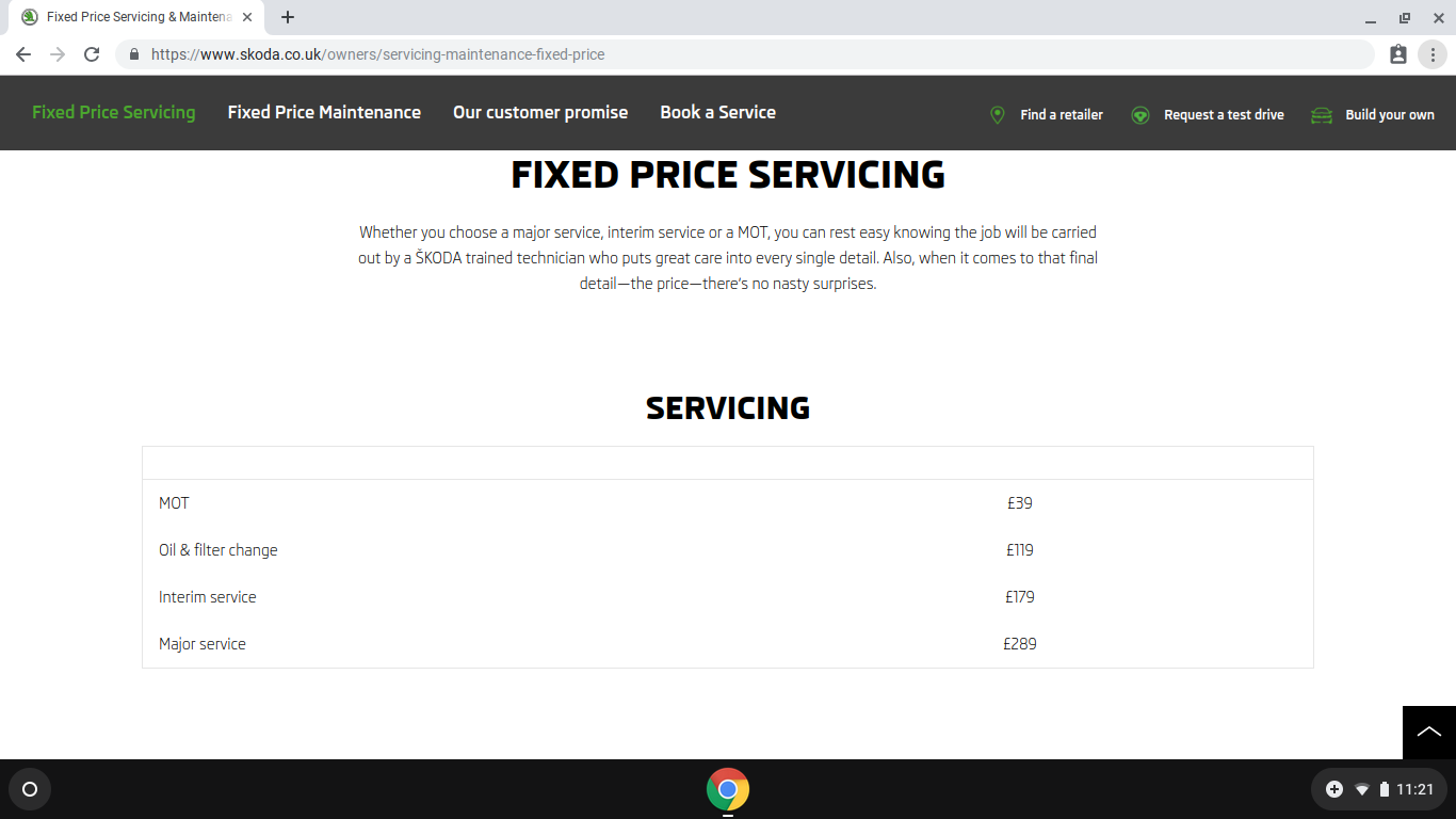

How much was this 'Interim Service' & MOT ?
What is on the Invoice, Sump Plug, Oil, Filter, Windscreen Wash, Pollen Filter?
You only needed a Oil Change Service and check & Report it seems.   I hope you have not paid for an Interim Service and not got a Pollen Filter changed.

Not an 'Interim Service'  then,
just a 'Oil & Filter and Servicing of some sort,
 and with the MOT if only £150 that is not a bad price from a VAT registered establishment IMO.

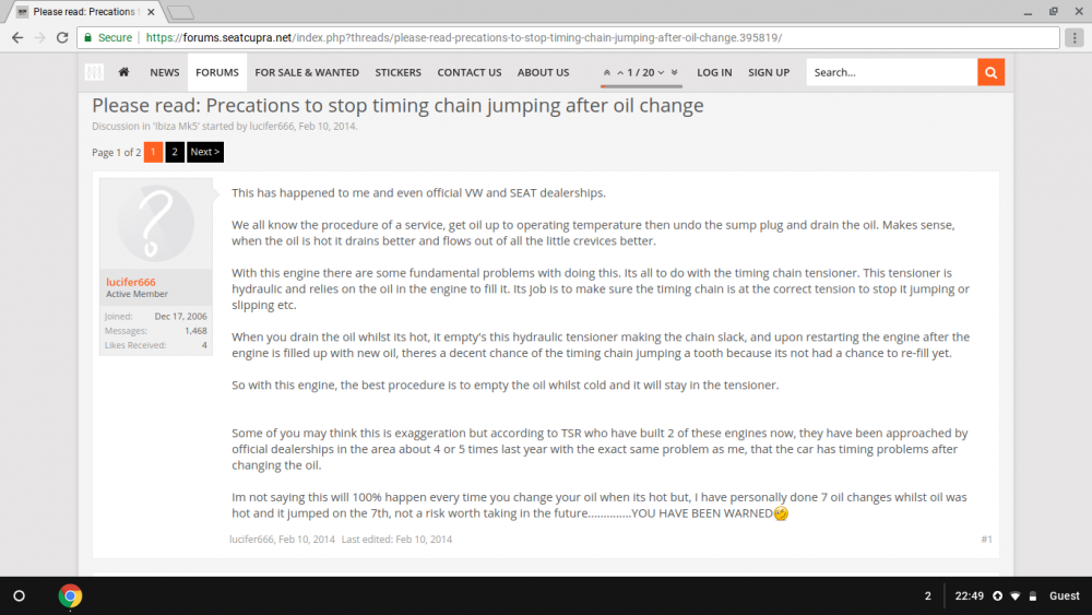

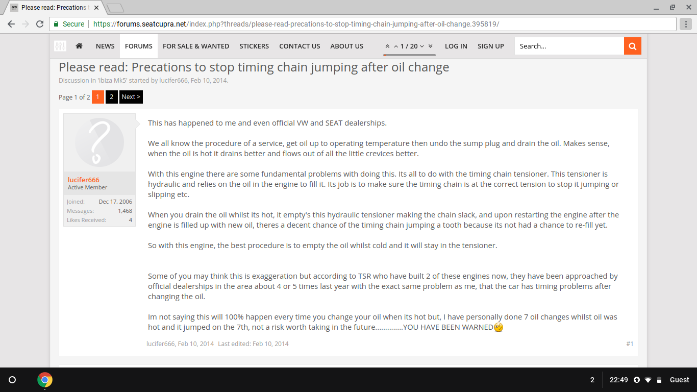

Draining for 30 minutes is the thing that killed plenty of TSI engines with the Chain Tensioner issues.

Because with hydraulic chain tensioners it has, and with some engines being like chocolate as well to take less risks.
The oil is hot and removed and when you remove the sump plug you see how little more comes out, that is the oil removed,
job done no need for sitting draining cold engine oil.
The thing is different folks do different things and that is OK if DIY but when on others vehicles you do what you are supposed to do,
or what your employer expects to be done.
If you are interested in posts by Luciffer on 1.4TSI Twinchargers which is a different engine altogether there is a pinned thread at the top of this section with links.

9 hours ago, Roottootemoot said:
There is a reason many will not drain for that long,
& rather have an engine / oil at Operating Temperature and use a Pump to remove the oil, then remove the Sump Plug and let any residual drain and fit a new sump plug.
H&S, and number they do, and the training they get as a Technician / Fitter.
Seen this written a few times, explanation please ?
@UrbanPanzer
I can give no more of an explanation than Luciffer gave.
If this is not possible in practice and is just in theory then ignore. Do as you please and as you do.
Wow that's scary , and something that would never have occurred to me, thanks for the explanation, learn something new here all the time. Even more scary that main dealerships aren't aware.  Planning on changing oil on our 1.4 TDI Greenline this week, will try and find out if the chain for the balance shaft is hydraulically tensioned also.

I can "sort" of understand the theory, however if you have been driving for say 30 mins, your oil is hot no doubt, you then switch off and say go in a shop for 20mins, by this time the oil "if" it drains from the tensioner that easily would have already drained back into the sump. so you would be in the same position upon restart, unless there is a fundamental flaw in the design of the oil way which pressurises the tensioner.
@UrbanPanzer
Funnily the engines that have had the timing chain tensioner issues since the Euro 4 1.4 TSI's including twin chargers and other than the Euro 5 1.8 & 2.0 TSI's are the early 1.2 TSI before the Upgrade and then some CTHE Twinchargers have had timing chain issues rather than CAVE engines.
@xman
Posts about the 1.2 TSI's  & the engine going backwards while the oil being changed, he might see this and comment.
http://adamlewin.co.uk/vw-mk5-golf-tsi-engine-timing-chain-problem
Edited by Roottootemoot
