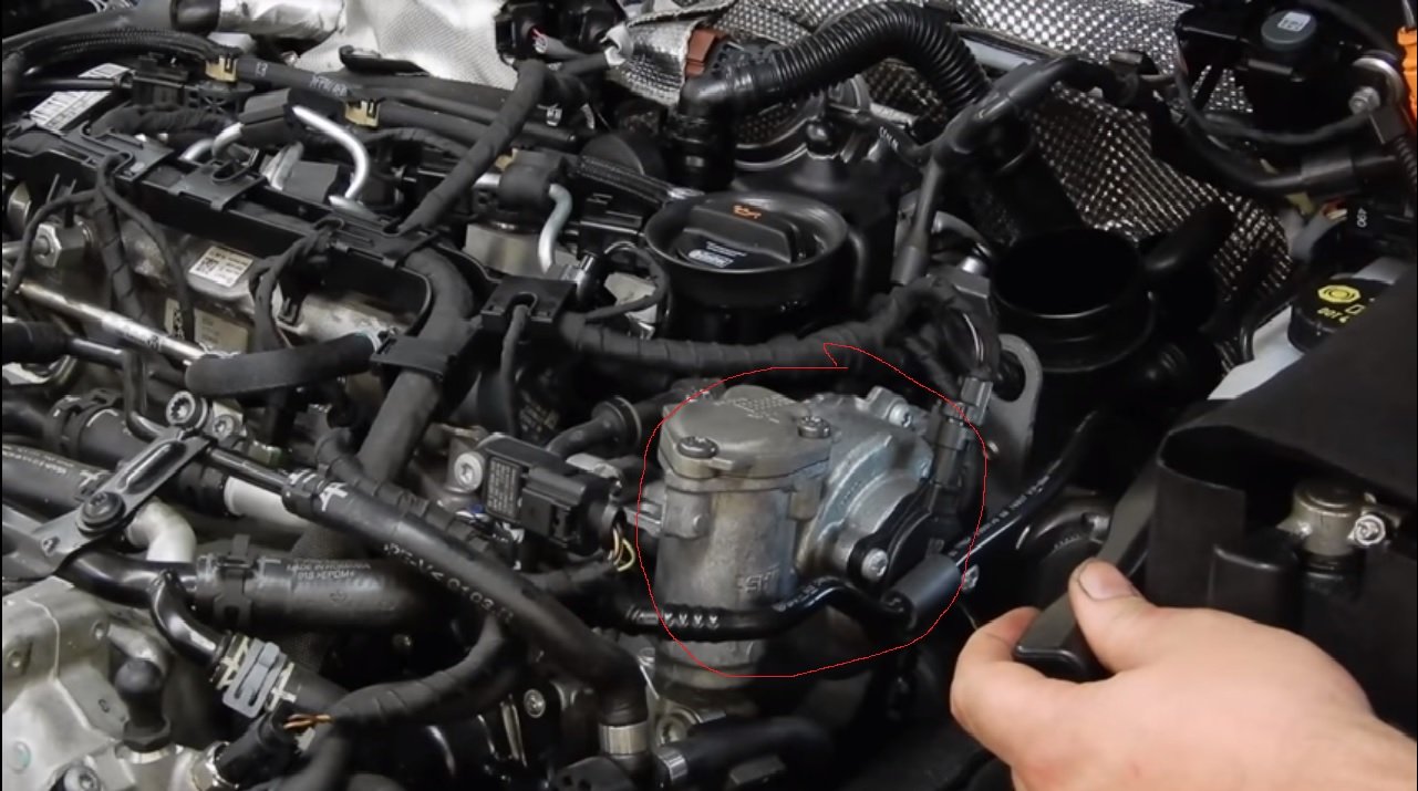

I wonder if you can take cover off, or take a picture from the right to front of the car side... this sounds to me like the variable valve solenoid playing up... will not show on any diagnose as fault code, but observing the timing from cam sensor and crank sensor... could be a revelation... i think is somewhere a bulletin about it, on some cases also creates intermittent long crank times for over a second on start up. Do not take my word for it but...

This  one... if it looks identical as in my pic is the unrevised type the revised one looks different. Sometimes puts up also P0016 as pending. I would of thought, judging by the vibration yours would put up the code. I know is not much and and is not 100%  but the symptom is not only on your engine are others also... maybe not on briskoda... considering yours is with low millage and still in warranty i think your only chance is to try different dealerships till you find one that a trained technician knows about it or has came across before. Should be easy to diagnose with a oscilloscope to cam sensor and crank and look at the wave form after...

Thanks SpAwN. Below is a video with the cover off, I think you'll tell me it's a revised version.
hi, yes yours has the revised version on... so doubt is a vvt system issue... was the  dmf flywheel excluded by any of the dealerships? what did they check (except telling you are no codes)?
