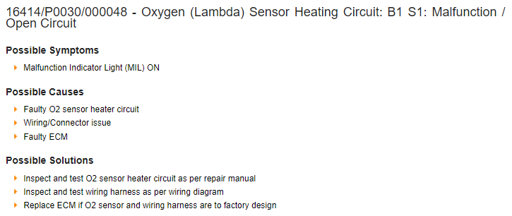

Carista will present you with the fault codes in a similar format to this...
Image result for carista fault codes
