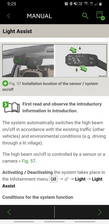

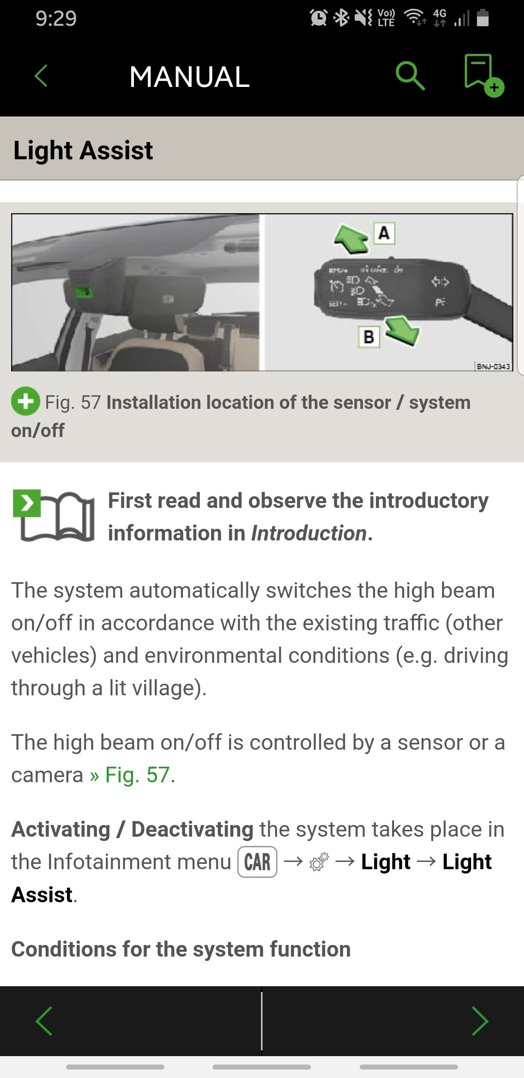

I didn't think it's an option but then saw this in the manual

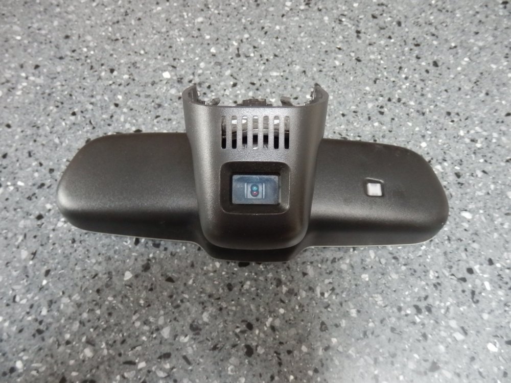

Light and rain sensor are different from HBA. You need a rear view which looks something like the picture.

A5 is not required. you can add only new mirror with HBA/FLA camera
wiring, mounting and coding on my site https://wirer.sk/f3-fla/
