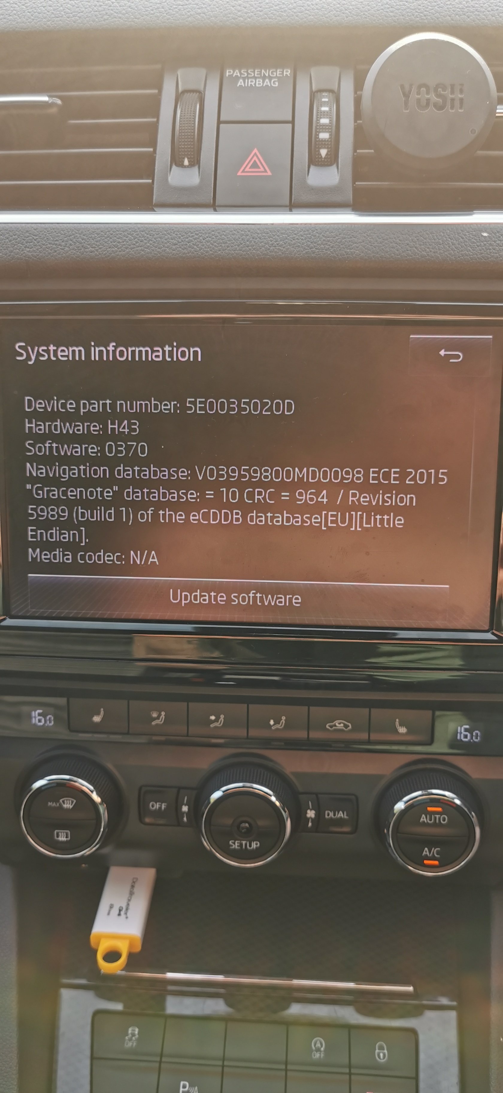

So, I need help! I've spent hours scrolling through threads today looking into updating the maps on my system. Firstly, I put my vin into the skoda update website and downloaded the recommended file. The files on the sd card are nothing like the ones I've downloaded...ive got mib 1 & 2 downloaded and I can't remember what I've got on the sd card. I've tried lots of different options to no avail, in my glove box I've got 2 sd cards and a cd/dvd slot. Under the stereo there's a USB and aux. One thing I did notice was people said the maps run on the sd card but I've driven around earlier with no card in and the maps worked fine?!

You have a columbus so maps stored in the unit itself rather than on an SD card.
On SD card or usb (whichever you use to update) you need the MIB1, MIB2 and metadata file in the root of the SD card or it won't pick up the update.
Also I usually go into setup from Nav menu, then version information and tap update for a map update, rather than going into the section in your screenshot. Not sure if this matters.

Is the SD card you are referring to a Skoda SD card? If so, you don't need it. You literally just need any SD card or USB device with the map update files on it to update from. You'll never fit a Columbus update onto an 8GB device. 32gb minimum I think. With the Columbus the maps are stored on the storage built in to the unit. With an Amundsen you have to use a Skoda SD card as that holds the map data files but in your case this doesn't apply.

No probs, keep us updated. You have a usb drive in your pic is that not big enough to hold the update? Think you can do it via USB as well as SD.

Nope it's only 8gb, all my tech is old and outdated now!! Except the 64gb micro sd card that's in an expansion thing. Fingers crossed I'll go and see if it's all gone onto the card shortly.
