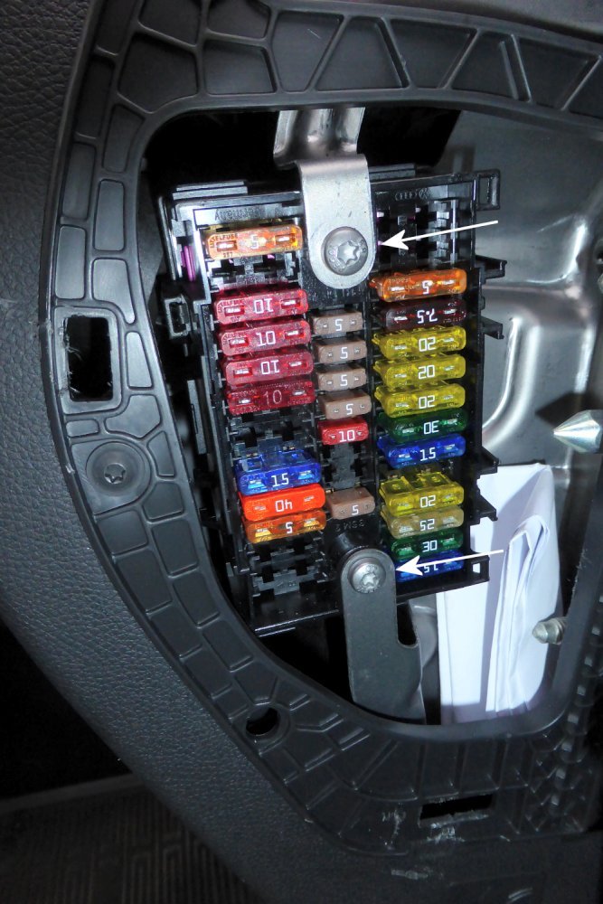

What is the location of that bulkhead bolt?
Edit: the 2 fuse box mountings are T25.

I'm going to use one of the 2 large silver'ish bolts that you can see in the fuse box.....I presume they go into the bulkhead. I will check for earth first with my mulltimeter
If you are talking about those two, yes they are a suitable but are T30.

I was going to use (now that I have had a proper look) one of the two bolts that go into a 90 degree bracket......but those in the photo will do as I'm not sure of the size of the others
As I said earlier these are T25 and easier to get to.

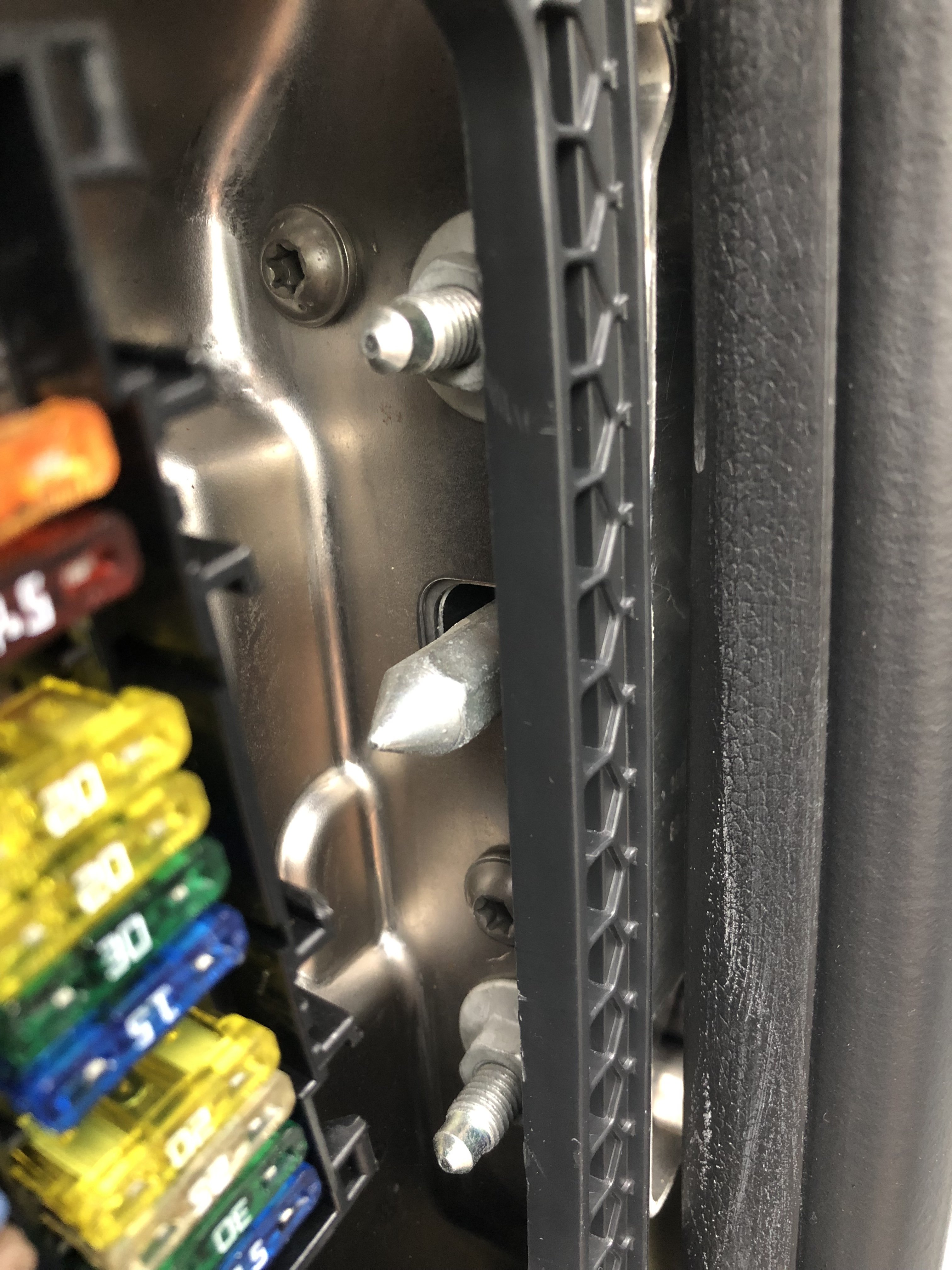

why not terminate your earth lead with a tab and use a nut to bolt it onto one of the protruding threads over on the RHS?
