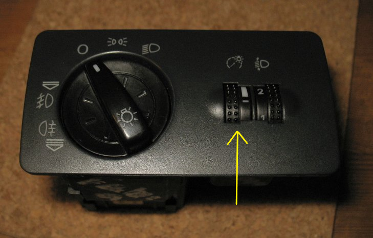

Not knocked the dimmer switch?
Is the dimmer switch the thing that I use to turn my lights on and off? Because if so no I haven’t
This is the dimmer switch...
Haven’t touched it

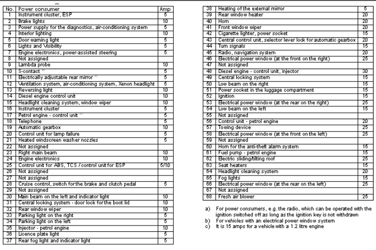

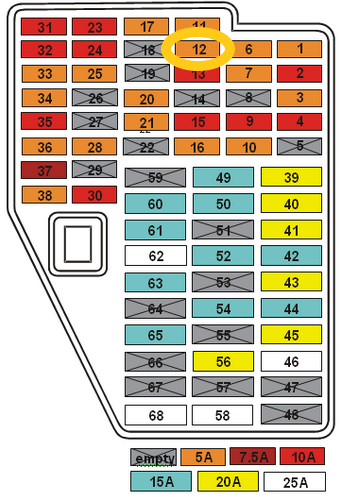

OK, which fuse was blown?
These are the fuses. Ignore the circle, that was for something else.
