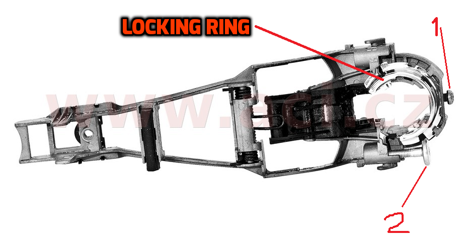

Don't  take either of them out completely.
Screw 2 turns a locking ring that holds the cylinder in place. Screw 1 nips the cylinder to hold it tight....

You don't need to remove the bowden cable if only removing the cylinder.
