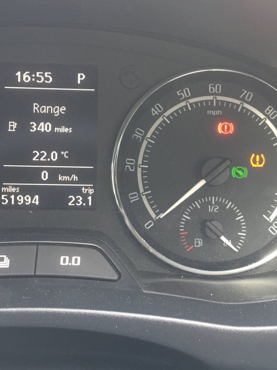

What does this mean?
Right I’ve always owned older cars so this came up literally five mins ago going up hill and I know it’s something to do with a tyre but what exactly? And is it expensive?
Tyre pressure monitor, the cars telling you something is wrong with a wheel. Check your tyre pressures ASAP.
have you had a tyre changed or wheels off recently?
turn your ignition on, down by the handbrake is a button with SET (!), hold it until it clears from the dash.
Ah ok thank you. Thought I’d have to get my mate to clear it on his computer plug in thing. But yeah had new brakes all around last month when I brought it. I’ll go to the garage now quick. Thanks mate
