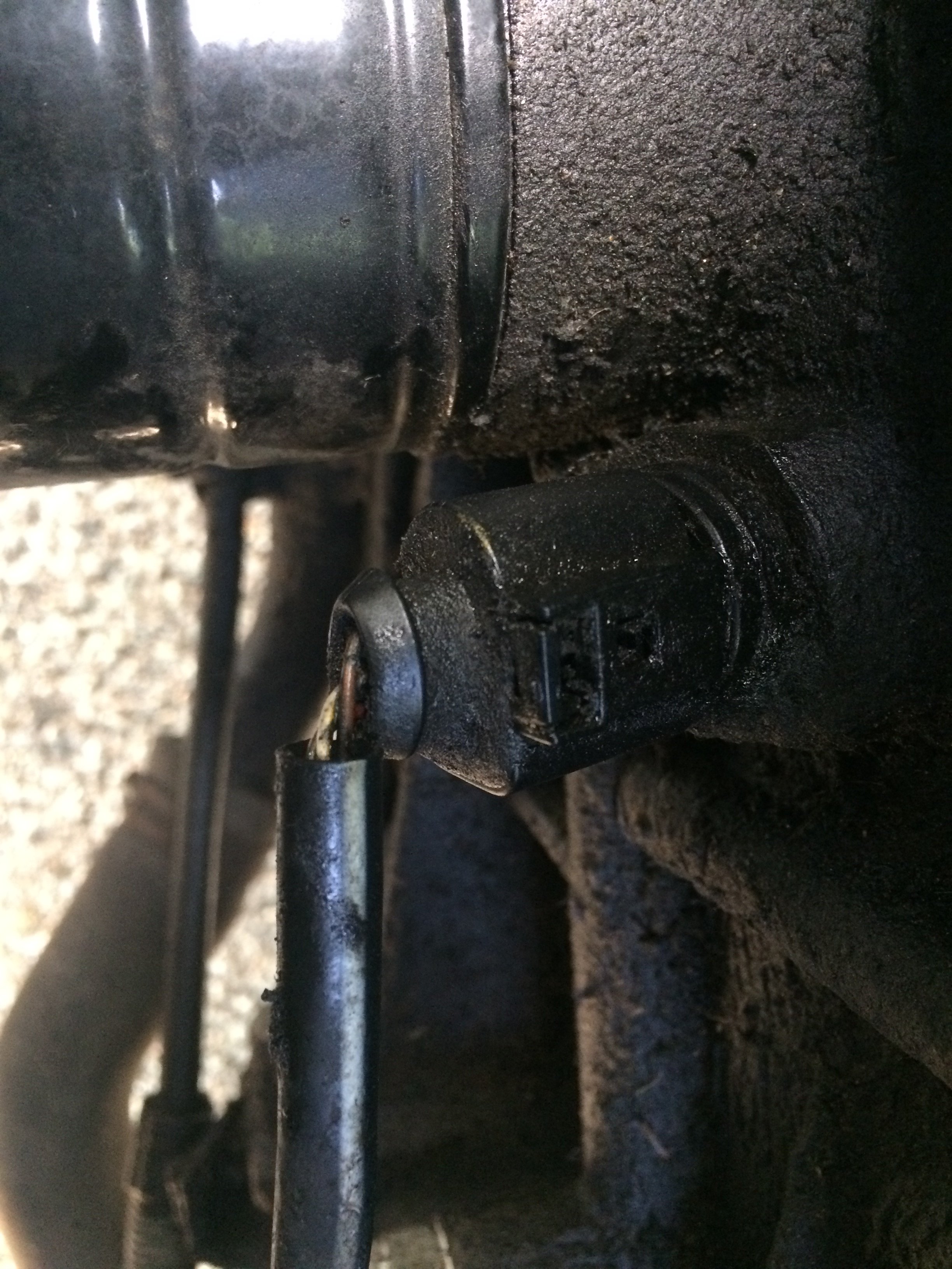

How do I get this clip off (camshaft sensor)
I’m sure it’s easy, however my usual strategy of brute force isn’t going to get the plastic clip over the top of the sensor off.
Bad photo attached
Push the plug to relase strain then pull the tag towards the wire...
1126-C13-F-A355-4-F47-B3-D6-FE68-BBC70-D
Thanks very much. Got that off no problem.

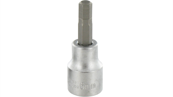

Looks like a hexagon (allen key) bolt. 6mm I think.
Allen key doesn't give much leverage. You need something like this...
Thanks I will have to raid the toolkit see what I’ve got, or as it’s going into the garage next week get them to do it
