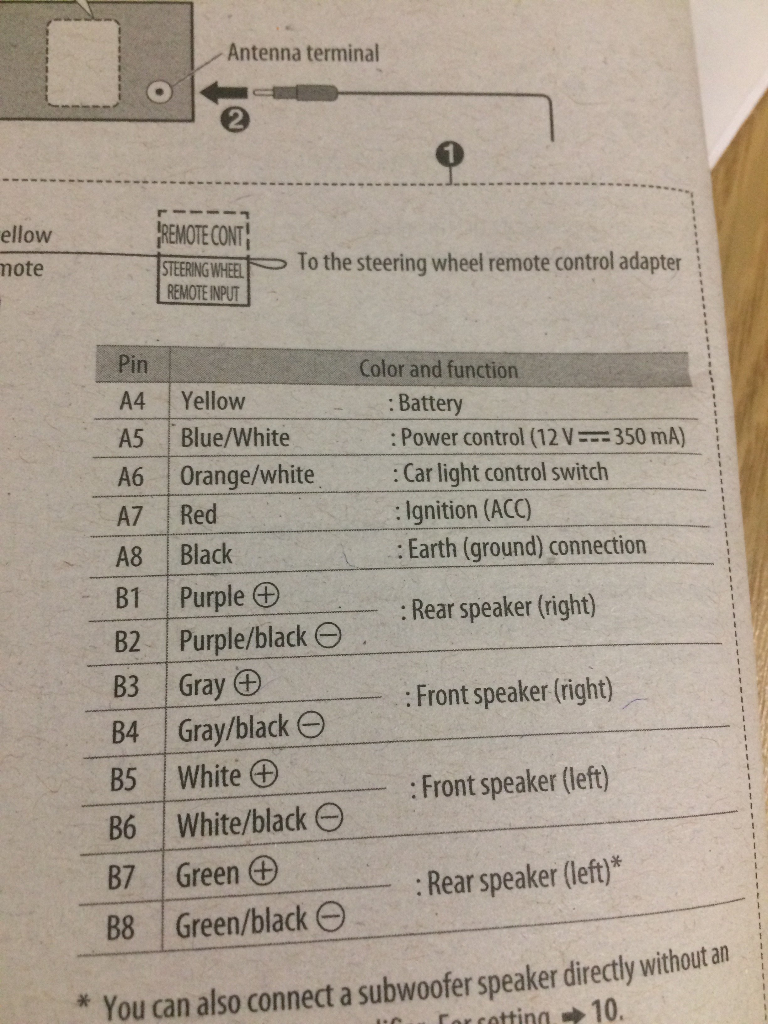

Which wire does my radio aerial signal booster need attaching to?
As per title really, which wire do I need to connect the aerial booster to?
usually the blue, but in this case the blue/white should do or you could stick it to the red ignition live wire.
All it needs is 12v from somewhere
Thank you
Well an ignition fed 12v
