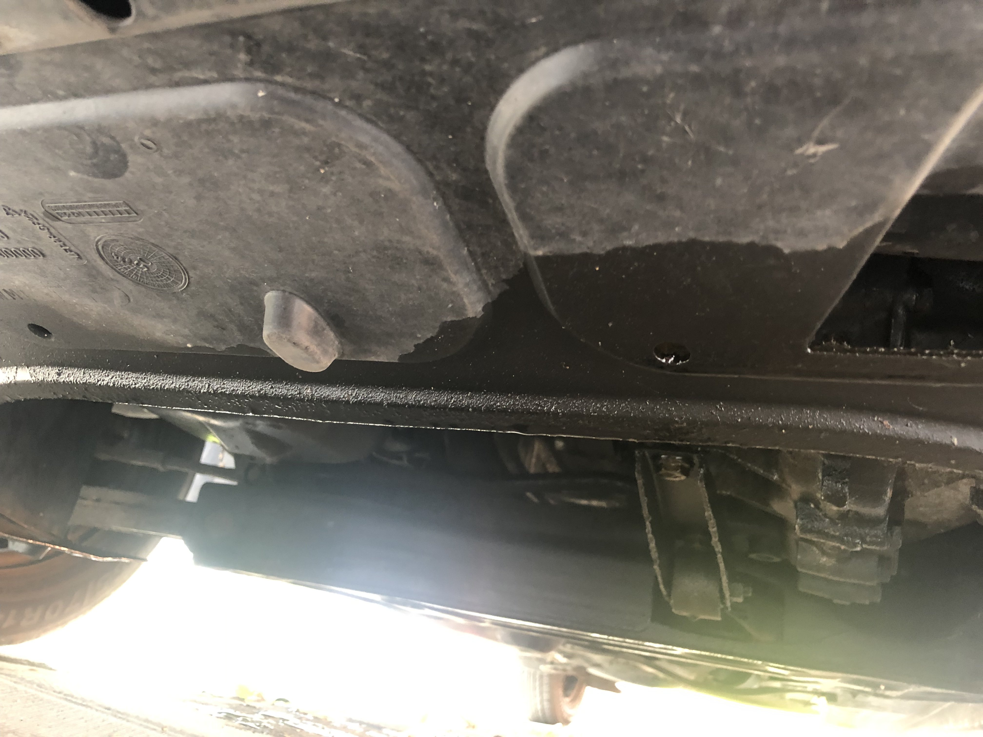

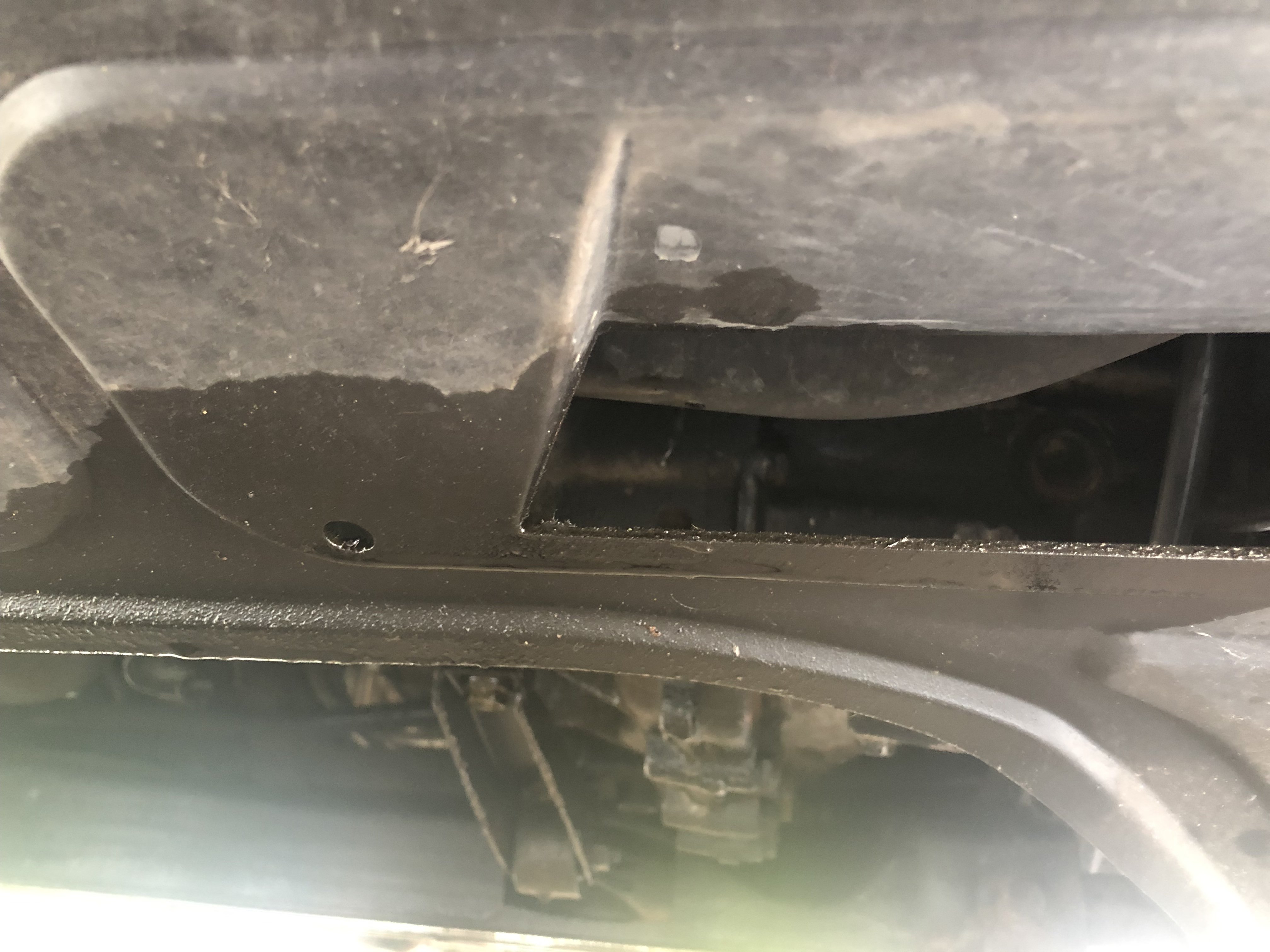

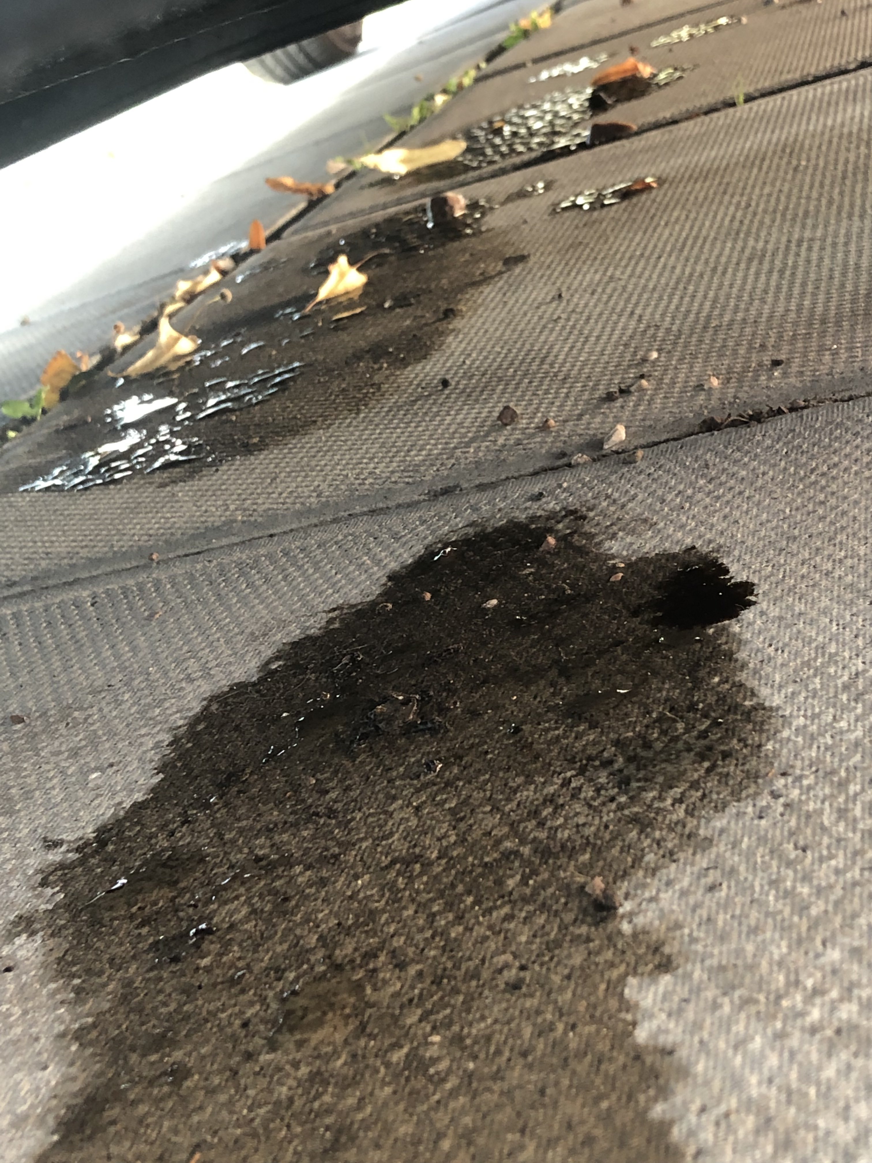

Got a leak which is all over the drive. Any ideas what it could be.
Car: Skoda Fabia MK1 Estate 1.4 mpi 2001
You'd have to get brave and smell and feel it, one side looks like oil, so check if it smells of fuel.

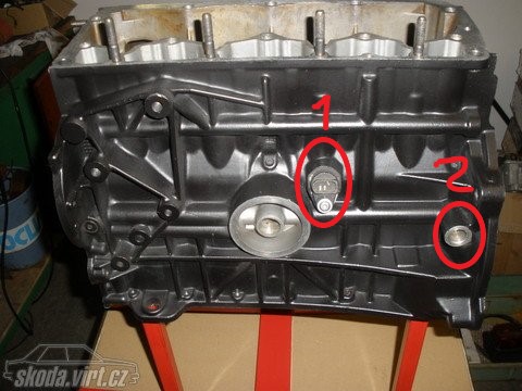

That is engine oil. The oil pressure switch can leak on this engine.
It is at position 2 in this pic...
