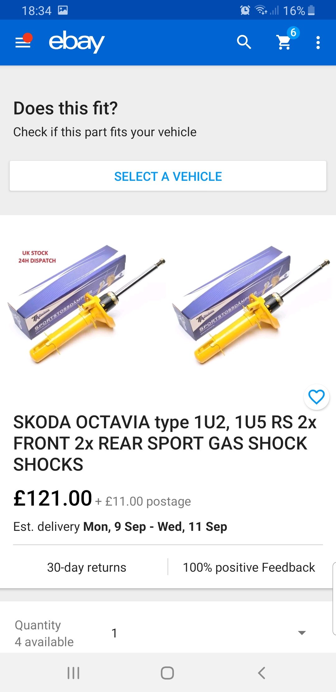

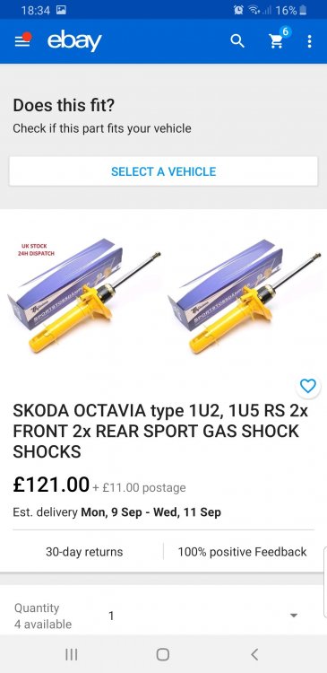

Has any one any info on these shocks seem to be cheap
