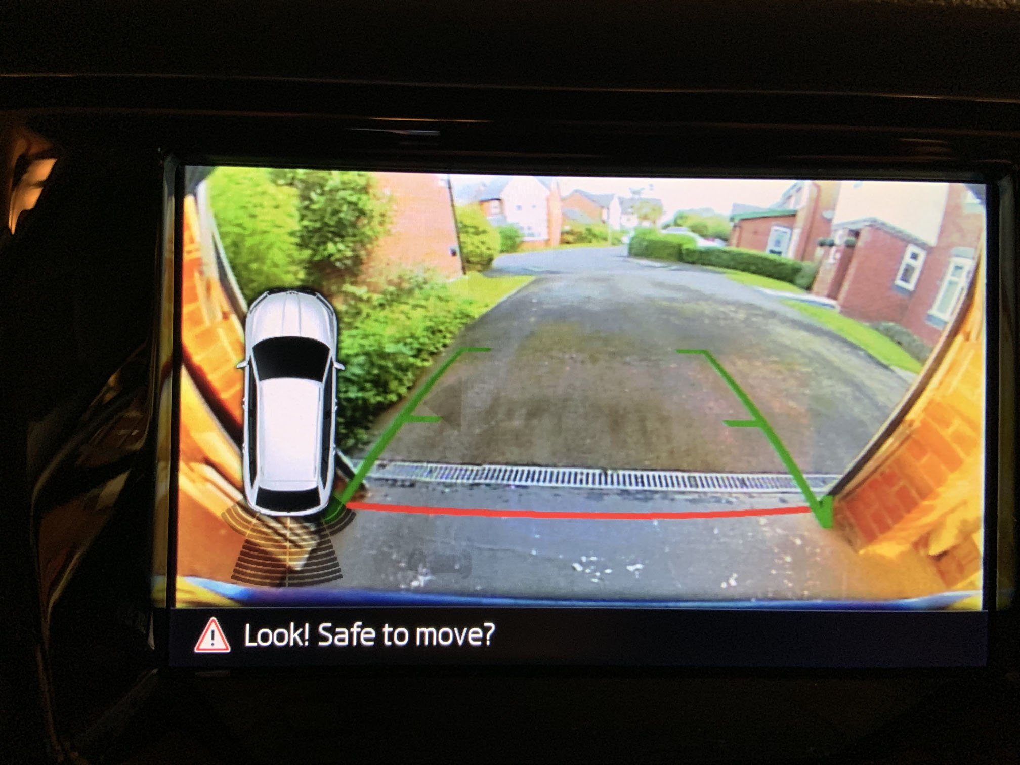

The camera shows a very clear view to the rear of the car with guide lines but on the left hand side is superimposed  car image which partially obstructs the view.
Has any one any ideas as to how the car image could be deleted?
I have looked at all of the menu options but could not find one that does the job.
Photo attached

Hi I've also got the camera. The image you see is related to the parking sensors telling you there is an obstruction. If you turn off the Parking Assist (P button to right of steering wheel) the image will disappear but you will have no P assist.
It's up to you

Forget the annoying little car, all the information you need is the redline and inside the greenlines.
