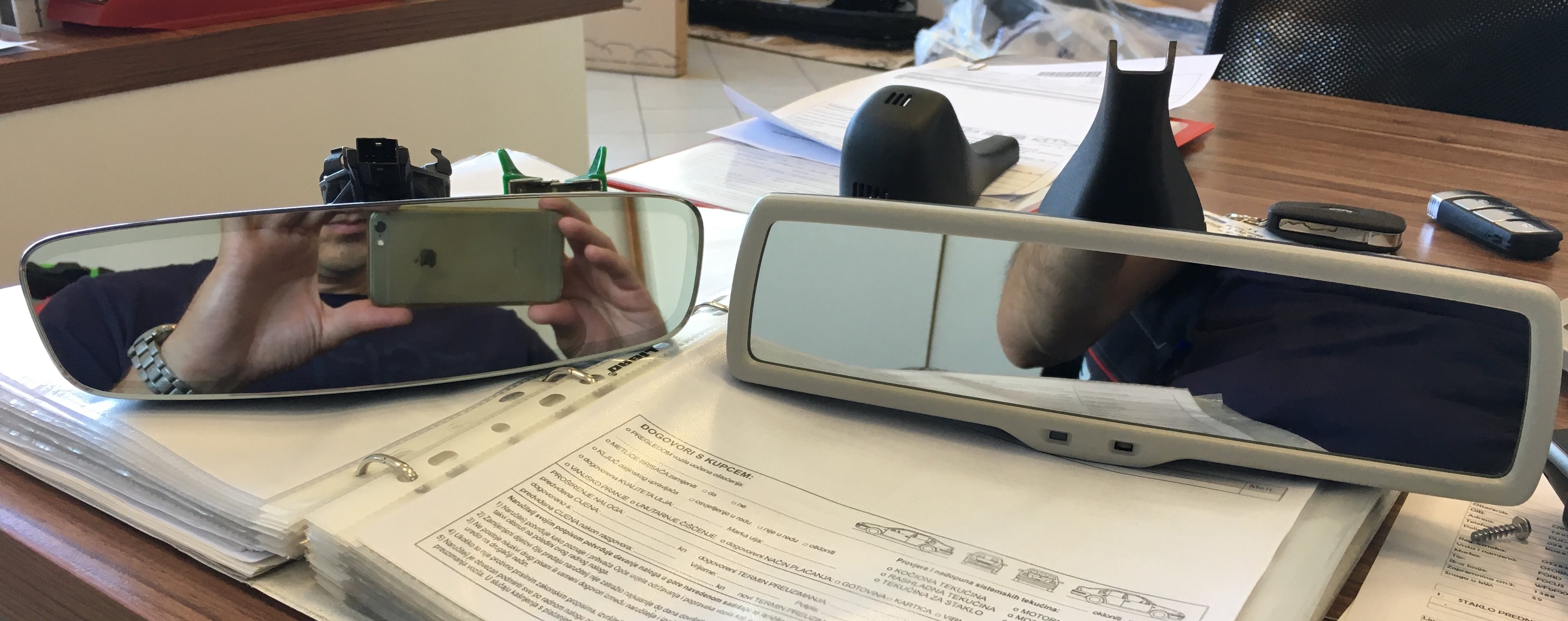

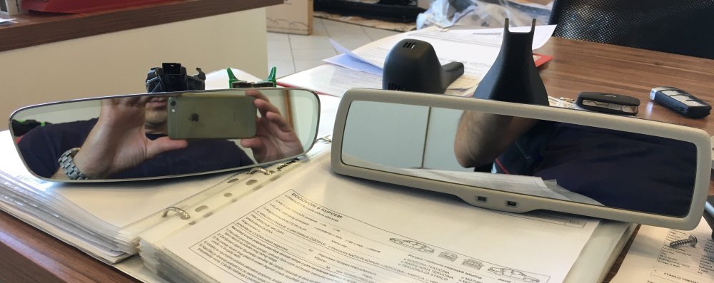

I’ll scan this one to see what hw and sw it is, can’t remember from memory.
New vs old
